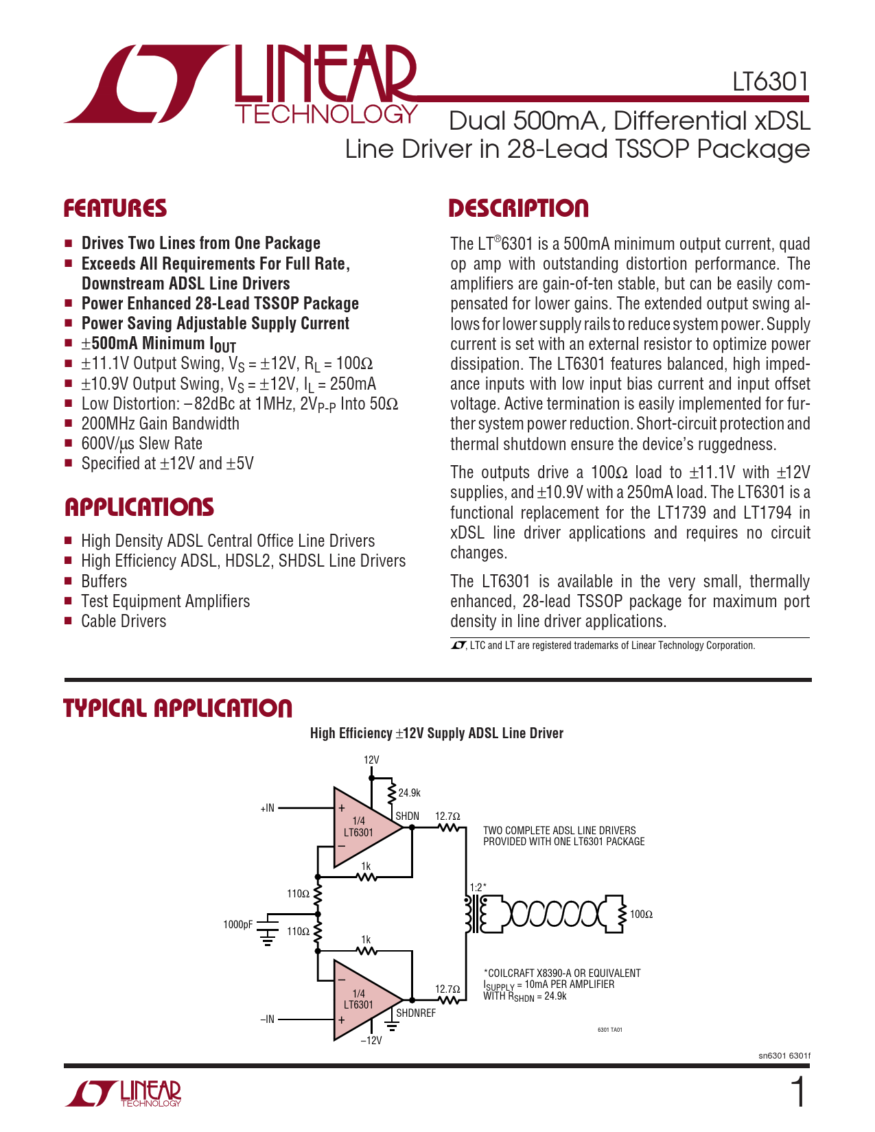

LT6301 Dual 500mA, Differential xDSL Line Driver in 28-Lead TSSOP Package
U FEATURES DESCRIPTIO
Drives Two Lines from One Package
The LT®6301 is a 500mA minimum output current, quad ■
Exceeds All Requirements For Full Rate,
op amp with outstanding distortion performance. The
Downstream ADSL Line Drivers
amplifiers are gain-of-ten stable, but can be easily com- ■
Power Enhanced 28-Lead TSSOP Package
pensated for lower gains. The extended output swing al- ■
Power Saving Adjustable Supply Current
lows for lower supply rails to reduce system power. Supply ■ ±
500mA Minimum IOUT
current is set with an external resistor to optimize power ■ ±11.1V Output Swing, VS = ±12V, RL = 100Ω dissipation. The LT6301 features balanced, high imped- ■ ±10.9V Output Swing, VS = ±12V, IL = 250mA ance inputs with low input bias current and input offset ■ Low Distortion: – 82dBc at 1MHz, 2VP-P Into 50Ω voltage. Active termination is easily implemented for fur- ■ 200MHz Gain Bandwidth ther system power reduction. Short-circuit protection and ■ 600V/µs Slew Rate thermal shutdown ensure the device’s ruggedness. ■ Specified at ±12V and ±5V The outputs drive a 100Ω load to ±11.1V with ±12V
U
supplies, and ±10.9V with a 250mA load. The LT6301 is a
APPLICATIO S
functional replacement for the LT1739 and LT1794 in xDSL line driver applications and requires no circuit ■ High Density ADSL Central Office Line Drivers changes. ■ High Efficiency ADSL, HDSL2, SHDSL Line Drivers ■ Buffers The LT6301 is available in the very small, thermally ■ Test Equipment Amplifiers enhanced, 28-lead TSSOP package for maximum port ■ Cable Drivers density in line driver applications. , LTC and LT are registered trademarks of Linear Technology Corporation.
U TYPICAL APPLICATIO High Efficiency
12V Supply ADSL Line Driver
