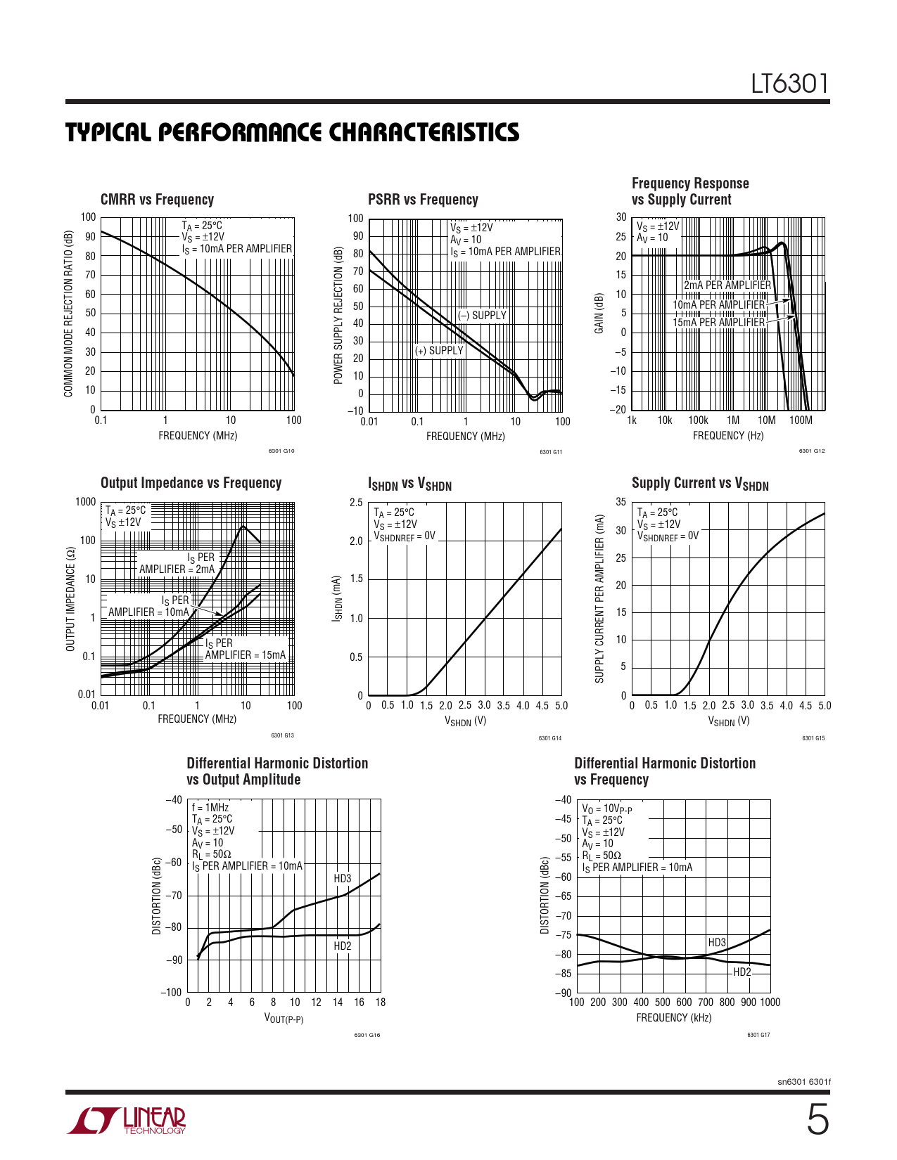

DescriptionDual 500mA, Differential xDSL Line Driver in 28-Lead TSSOP Package
Pages / Page16 / 5 — TYPICAL PERFOR A CE CHARACTERISTICS. Frequency Response. CMRR vs …
File Format / SizePDF / 252 Kb
TYPICAL PERFOR A CE CHARACTERISTICS. Frequency Response. CMRR vs Frequency. PSRR vs Frequency. vs Supply Current
TYPICAL PERFOR A CE CHARACTERISTICS Frequency Response CMRR vs Frequency PSRR vs Frequency vs Supply Current
LT6301
W U TYPICAL PERFOR A CE CHARACTERISTICS Frequency Response CMRR vs Frequency PSRR vs Frequency vs Supply Current
100 100 30 TA = 25°C V V S = ±12V S = ±12V 90 VS = ±12V 90 A 25 A V = 10 V = 10 IS = 10mA PER AMPLIFIER I 80 80 S = 10mA PER AMPLIFIER 20 70 70 15 60 2mA PER AMPLIFIER 60 10 50 10mA PER AMPLIFIER 50 (–) SUPPLY 5 40 15mA PER AMPLIFIER 40 GAIN (dB) 0 30 30 (+) SUPPLY –5 20 20 10 –10 POWER SUPPLY REJECTION (dB) COMMON MODE REJECTION RATIO (dB) 10 0 –15 0 –10 –20 0.1 1 10 100 0.01 0.1 1 10 100 1k 10k 100k 1M 10M 100M FREQUENCY (MHz) FREQUENCY (MHz) FREQUENCY (Hz) 6301 G10 6301 G11 6301 G12
Output Impedance vs Frequency ISHDN vs VSHDN Supply Current vs VSHDN
1000 2.5 35 TA = 25°C TA = 25°C TA = 25°C VS ±12V VS = ±12V V 30 S = ±12V V V 100 2.0 SHDNREF = 0V SHDNREF = 0V ) Ω IS PER 25 AMPLIFIER = 2mA 10 1.5 20 (mA) IS PER AMPLIFIER = 10mA 15 1 I SHDN 1.0 I 10 OUTPUT IMPEDANCE ( S PER 0.1 AMPLIFIER = 15mA 0.5 5 SUPPLY CURRENT PER AMPLIFIER (mA) 0.01 0 0 0.01 0.1 1 10 100 0 0.5 1.0 1.5 2.0 2.5 3.0 3.5 4.0 4.5 5.0 0 0.5 1.0 1.5 2.0 2.5 3.0 3.5 4.0 4.5 5.0 FREQUENCY (MHz) VSHDN (V) VSHDN (V) 6301 G13 6301 G14 6301 G15
Differential Harmonic Distortion Differential Harmonic Distortion vs Output Amplitude vs Frequency
–40 –40 f = 1MHz VO = 10VP-P TA = 25°C –45 TA = 25°C –50 VS = ±12V VS = ±12V A –50 V = 10 AV = 10 RL = 50Ω R –60 –55 L = 50Ω IS PER AMPLIFIER = 10mA IS PER AMPLIFIER = 10mA HD3 –60 –70 –65 –70 DISTORTION (dBc) –80 DISTORTION (dBc) –75 HD2 HD3 –80 –90 –85 HD2 –100 –90 0 2 4 6 8 10 12 14 16 18 100 200 300 400 500 600 700 800 900 1000 VOUT(P-P) FREQUENCY (kHz) 6301 G16 6301 G17 sn6301 6301f 5
