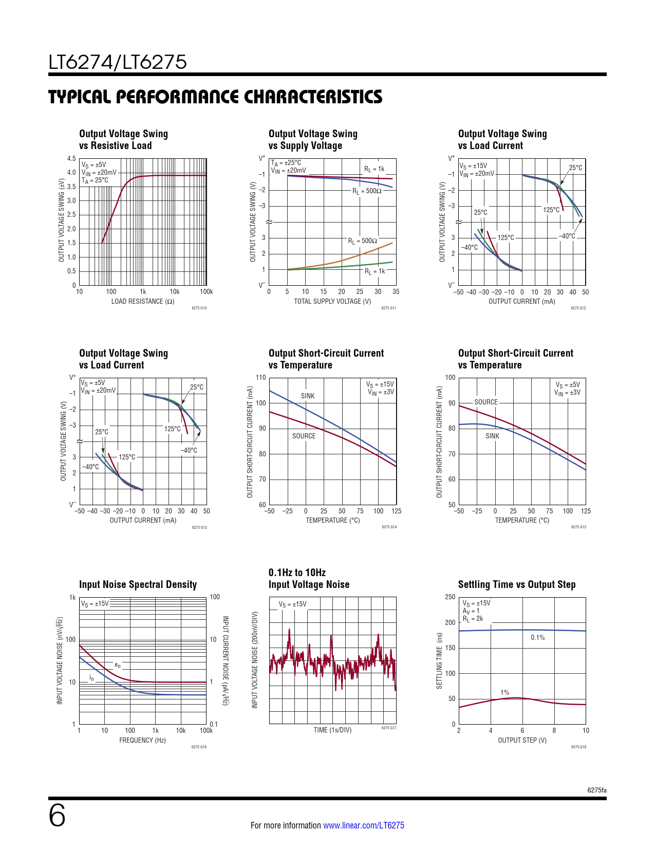

DescriptionDual 90MHz, 2200V/µs 30V Low Power Op Amp
Pages / Page20 / 6 — TYPICAL PERFORMANCE CHARACTERISTICS. Output Voltage Swing. vs Resistive …
TYPICAL PERFORMANCE CHARACTERISTICS. Output Voltage Swing. vs Resistive Load. vs Supply Voltage. vs Load Current
TYPICAL PERFORMANCE CHARACTERISTICS Output Voltage Swing vs Resistive Load vs Supply Voltage vs Load Current
LT6274/LT6275
TYPICAL PERFORMANCE CHARACTERISTICS Output Voltage Swing Output Voltage Swing Output Voltage Swing vs Resistive Load vs Supply Voltage vs Load Current
4.5 V+ V+ V T S = ±5V A = ±25°C VS = ±15V 25°C 4.0 V V RL = 1k IN = ±20mV IN = ±20mV –1 –1 VIN = ±20mV TA = 25°C 3.5 –2 RL = 500Ω –2 3.0 –3 –3 125°C 2.5 25°C TAGE SWING (±V) TAGE SWING (V) 2.0 TAGE SWING (V) 3 3 125°C –40°C 1.5 RL = 500Ω –40°C 1.0 2 2 OUTPUT VOL OUTPUT VOL OUTPUT VOL 0.5 1 RL = 1k 1 0 V– V– 10 100 1k 10k 100k 0 5 10 15 20 25 30 35 –50 –40 –30 –20 –10 0 10 20 30 40 50 LOAD RESISTANCE (Ω) TOTAL SUPPLY VOLTAGE (V) OUTPUT CURRENT (mA) 6275 G10 6275 G11 6275 G12
Output Voltage Swing Output Short-Circuit Current Output Short-Circuit Current vs Load Current vs Temperature vs Temperature
V+ 110 100 VS = ±5V VS = ±15V V V 25°C S = ±5V IN = ±20mV –1 VIN = ±3V SINK VIN = ±3V 100 90 SOURCE –2 –3 125°C 25°C 90 80 SOURCE SINK TAGE SWING (V) –40°C 3 125°C T-CIRCUIT CURRENT (mA) 80 T-CIRCUIT CURRENT (mA) 70 –40°C 2 OUTPUT VOL 70 60 1 OUTPUT SHOR OUTPUT SHOR V– 60 50 –50 –40 –30 –20 –10 0 10 20 30 40 50 –50 –25 0 25 50 75 100 125 –50 –25 0 25 50 75 100 125 OUTPUT CURRENT (mA) TEMPERATURE (°C) TEMPERATURE (°C) 6275 G13 6275 G14 6275 G15
0.1Hz to 10Hz Input Noise Spectral Density Input Voltage Noise Settling Time vs Output Step
1k 100 250 VS = ±15V VS = ±15V VS = ±15V AV = 1 ) INPUT CURRENT NOISE (pA/√ R Hz /DIV) L = 2k 200 /√ 100 10 0.1% 150 en TAGE NOISE (nV i 100 n TAGE NOISE (200nV TLING TIME (ns) 10 1 SET Hz 1% INPUT VOL ) 50 INPUT VOL 1 0.1 0 1 10 100 1k 10k 100k TIME (1s/DIV) 6275 G17 2 4 6 8 10 FREQUENCY (Hz) OUTPUT STEP (V) 6275 G16 6275 G18 6275fa 6 For more information www.linear.com/LT6275
