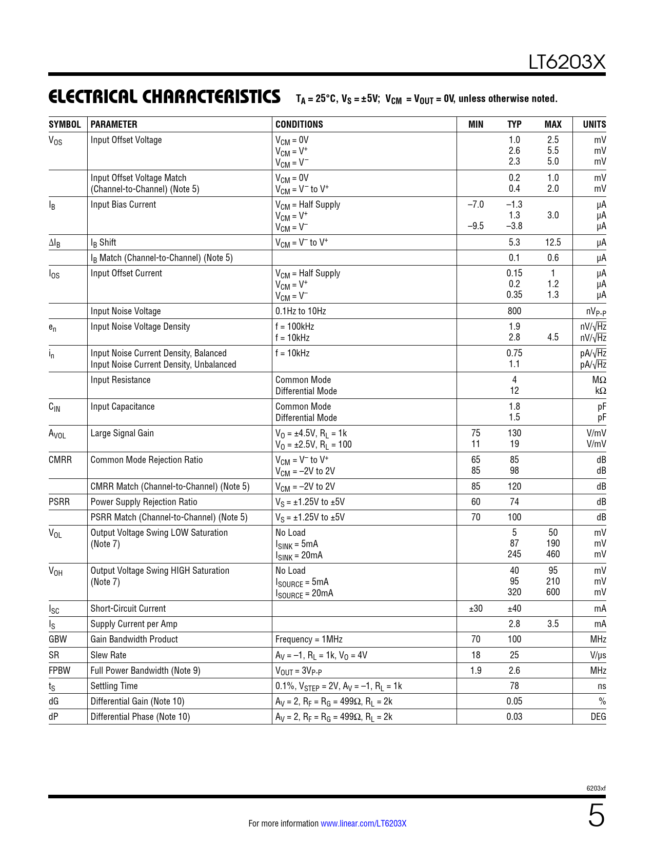

elecTrical characTerisTics. TA = 25°C, VS = ±5V; VCM = VOUT = 0V, unless otherwise noted. SYMBOL PARAMETER. CONDITIONS. MIN. TYP
LT6203X
elecTrical characTerisTics TA = 25°C, VS = ±5V; VCM = VOUT = 0V, unless otherwise noted. SYMBOL PARAMETER CONDITIONS MIN TYP MAX UNITS
VOS Input Offset Voltage VCM = 0V 1.0 2.5 mV VCM = V+ 2.6 5.5 mV VCM = V– 2.3 5.0 mV Input Offset Voltage Match VCM = 0V 0.2 1.0 mV (Channel-to-Channel) (Note 5) VCM = V– to V+ 0.4 2.0 mV IB Input Bias Current VCM = Half Supply –7.0 –1.3 µA VCM = V+ 1.3 3.0 µA VCM = V– –9.5 –3.8 µA ∆IB IB Shift VCM = V– to V+ 5.3 12.5 µA IB Match (Channel-to-Channel) (Note 5) 0.1 0.6 µA IOS Input Offset Current VCM = Half Supply 0.15 1 µA VCM = V+ 0.2 1.2 µA VCM = V– 0.35 1.3 µA Input Noise Voltage 0.1Hz to 10Hz 800 nVP-P en Input Noise Voltage Density f = 100kHz 1.9 nV/√Hz f = 10kHz 2.8 4.5 nV/√Hz in Input Noise Current Density, Balanced f = 10kHz 0.75 pA/√Hz Input Noise Current Density, Unbalanced 1.1 pA/√Hz Input Resistance Common Mode 4 MΩ Differential Mode 12 kΩ CIN Input Capacitance Common Mode 1.8 pF Differential Mode 1.5 pF AVOL Large Signal Gain VO = ±4.5V, RL = 1k 75 130 V/mV VO = ±2.5V, RL = 100 11 19 V/mV CMRR Common Mode Rejection Ratio VCM = V – to V+ 65 85 dB VCM = –2V to 2V 85 98 dB CMRR Match (Channel-to-Channel) (Note 5) VCM = –2V to 2V 85 120 dB PSRR Power Supply Rejection Ratio VS = ±1.25V to ±5V 60 74 dB PSRR Match (Channel-to-Channel) (Note 5) VS = ±1.25V to ±5V 70 100 dB VOL Output Voltage Swing LOW Saturation No Load 5 50 mV (Note 7) ISINK = 5mA 87 190 mV ISINK = 20mA 245 460 mV VOH Output Voltage Swing HIGH Saturation No Load 40 95 mV (Note 7) ISOURCE = 5mA 95 210 mV ISOURCE = 20mA 320 600 mV ISC Short-Circuit Current ±30 ±40 mA IS Supply Current per Amp 2.8 3.5 mA GBW Gain Bandwidth Product Frequency = 1MHz 70 100 MHz SR Slew Rate AV = –1, RL = 1k, VO = 4V 18 25 V/µs FPBW Full Power Bandwidth (Note 9) VOUT = 3VP-P 1.9 2.6 MHz tS Settling Time 0.1%, VSTEP = 2V, AV = –1, RL = 1k 78 ns dG Differential Gain (Note 10) AV = 2, RF = RG = 499Ω, RL = 2k 0.05 % dP Differential Phase (Note 10) AV = 2, RF = RG = 499Ω, RL = 2k 0.03 DEG 6203xf For more information www.linear.com/LT6203X 5 Document Outline Features Applications Description Typical Application Absolute Maximum Ratings Electrical Characteristics Typical Performance Characteristics Applications Information Typical Application Related Parts Features Applications Typical Application Description Absolute Maximum Ratings Order Information Pin Configuration Electrical Characteristics Typical Performance Characteristics Applications Information Package Description Typical Application Related Parts
