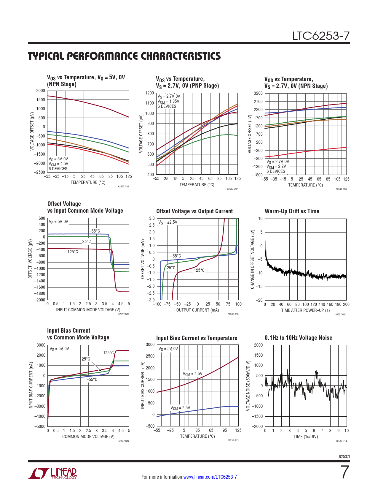

TYPICAL PERFORMANCE CHARACTERISTICS. VOS vs Temperature, VS = 5V, 0V. VOS vs Temperature,. (NPN Stage)
LTC6253-7
TYPICAL PERFORMANCE CHARACTERISTICS VOS vs Temperature, VS = 5V, 0V VOS vs Temperature, VOS vs Temperature, (NPN Stage) VS = 2.7V, 0V (PNP Stage) VS = 2.7V, 0V (NPN Stage)
2000 1200 3200 V 1500 S = 2.7V, 0V 1100 VCM = 1.35V 2700 1000 6 DEVICES 2200 V) 1000 500 V) V) 1700 900 0 1200 –500 800 700 TAGE OFFSET (µ 200 –1000 TAGE OFFSET (µ 700 TAGE OFFSET (µ VOL –300 –1500 VOL 600 VOL VS = 5V, 0V –800 –2000 V VS = 2.7V, 0V CM = 4.5V 500 6 DEVICES –1300 VCM = 2.2V –2500 6 DEVICES –55 –35 –15 5 25 45 65 85 105 125 400 –1800 –55 –35 –15 5 25 45 65 85 105 125 –55 –35 –15 5 25 45 65 85 105 125 TEMPERATURE (°C) TEMPERATURE (°C) TEMPERATURE (°C) 62537 G06 62537 G07 62537 G08
Offset Voltage vs Input Common Mode Voltage Offset Voltage vs Output Current Warm-Up Drift vs Time
600 3.0 10 V 400 S = 5V, 0V V 2.5 S = ±2.5V 200 –55°C 2.0 V) 5 0 V) 1.5 –200 25°C 1.0 TAGE (µ 0 –400 125°C 0.5 TAGE (µ –600 TAGE (mV) –55°C 0 –5 –800 –1000 –0.5 25°C –1.0 125°C –10 OFFSET VOL –1200 OFFSET VOL –1400 –1.5 –1600 –2.0 CHANGE IN OFFSET VOL –15 –1800 –2.5 –2000 –3.0 –20 0 0.5 1 1.5 2 2.5 3 3.5 4 4.5 5 –100 –75 –50 –25 0 25 50 75 100 0 20 40 60 80 100 120 140 160 180 200 INPUT COMMON MODE VOLTAGE (V) OUTPUT CURRENT (mA) TIME AFTER POWER–UP (s) 62537 G09 62537 G10 62357 G11
Input Bias Current vs Common Mode Voltage Input Bias Current vs Temperature 0.1Hz to 10Hz Voltage Noise
3000 3000 2000 VS = 5V, 0V VS = 5V, 0V 2000 125°C 2500 1500 25°C 1000 2000 /DIV) 1000 0 VCM = 4.5V 500 –55°C 1500 –1000 0 1000 –2000 –500 500 TAGE NOISE (500nV INPUT BIAS CURRENT (nA) –3000 –1000 INPUT BIAS CURRENT (nA) VCM = 2.5V VOL –4000 0 –1500 –5000 –500 –2000 0 0.5 1 1.5 2 2.5 3 3.5 4 4.5 5 –55 –25 5 35 65 95 125 0 1 2 3 4 5 6 7 8 9 10 COMMON MODE VOLTAGE (V) TEMPERATURE (°C) TIME (1s/DIV) 62537 G12 62537 G13 62537 G14 62537f For more information www.linear.com/LTC6253-7 7 Document Outline Features Applications Description Typical Application Absolute Maximum Ratings Order Information Electrical Characteristics Pin Functions Applications Information Typical Applications Typical Application Related Parts
