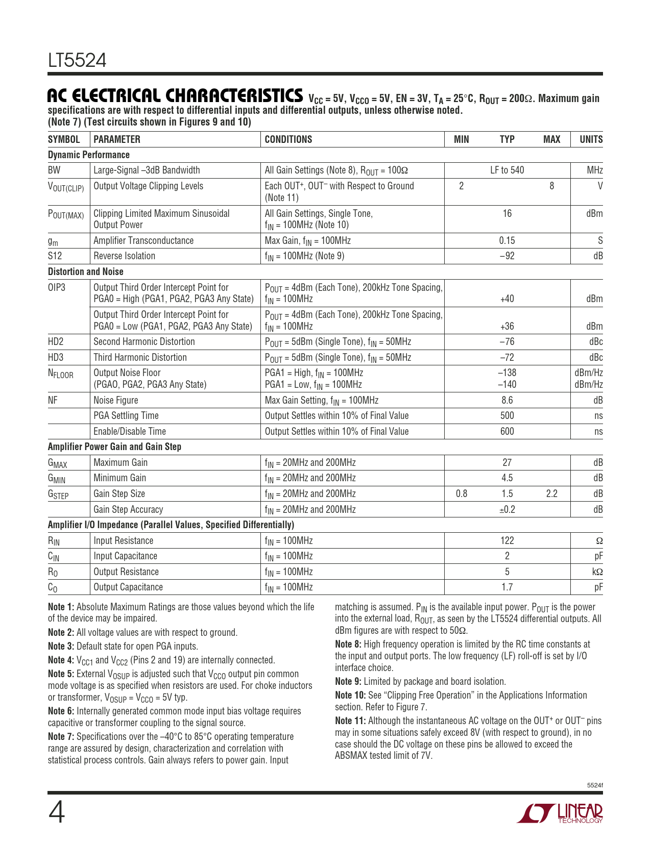

AC ELECTRICAL CHARACTERISTICS VCC = 5V, VCCO = 5V, EN = 3V, TA = 25. C, ROUT = 200. . Maximum gain
AC ELECTRICAL CHARACTERISTICS VCC = 5V, VCCO = 5V, EN = 3V, TA = 25 C, ROUT = 200  Maximum gain
LT5524
C, ROUT = 200
Ω
. Maximum gain specifications are with respect to differential inputs and differential outputs, unless otherwise noted. (Note 7) (Test circuits shown in Figures 9 and 10) SYMBOL PARAMETER CONDITIONS MIN TYP MAX UNITS Dynamic Performance
BW Large-Signal –3dB Bandwidth All Gain Settings (Note 8), ROUT = 100Ω LF to 540 MHz VOUT(CLIP) Output Voltage Clipping Levels Each OUT+, OUT– with Respect to Ground 2 8 V (Note 11) POUT(MAX) Clipping Limited Maximum Sinusoidal All Gain Settings, Single Tone, 16 dBm Output Power fIN = 100MHz (Note 10) gm Amplifier Transconductance Max Gain, fIN = 100MHz 0.15 S S12 Reverse Isolation fIN = 100MHz (Note 9) –92 dB
Distortion and Noise
OIP3 Output Third Order Intercept Point for POUT = 4dBm (Each Tone), 200kHz Tone Spacing, PGA0 = High (PGA1, PGA2, PGA3 Any State) fIN = 100MHz +40 dBm Output Third Order Intercept Point for POUT = 4dBm (Each Tone), 200kHz Tone Spacing, PGA0 = Low (PGA1, PGA2, PGA3 Any State) fIN = 100MHz +36 dBm HD2 Second Harmonic Distortion POUT = 5dBm (Single Tone), fIN = 50MHz –76 dBc HD3 Third Harmonic Distortion POUT = 5dBm (Single Tone), fIN = 50MHz –72 dBc NFLOOR Output Noise Floor PGA1 = High, fIN = 100MHz –138 dBm/Hz (PGAO, PGA2, PGA3 Any State) PGA1 = Low, fIN = 100MHz –140 dBm/Hz NF Noise Figure Max Gain Setting, fIN = 100MHz 8.6 dB PGA Settling Time Output Settles within 10% of Final Value 500 ns Enable/Disable Time Output Settles within 10% of Final Value 600 ns
Amplifier Power Gain and Gain Step
GMAX Maximum Gain fIN = 20MHz and 200MHz 27 dB GMIN Minimum Gain fIN = 20MHz and 200MHz 4.5 dB GSTEP Gain Step Size fIN = 20MHz and 200MHz 0.8 1.5 2.2 dB Gain Step Accuracy fIN = 20MHz and 200MHz ±0.2 dB
Amplifier I/O Impedance (Parallel Values, Specified Differentially)
RIN Input Resistance fIN = 100MHz 122 Ω CIN Input Capacitance fIN = 100MHz 2 pF RO Output Resistance fIN = 100MHz 5 kΩ CO Output Capacitance fIN = 100MHz 1.7 pF
