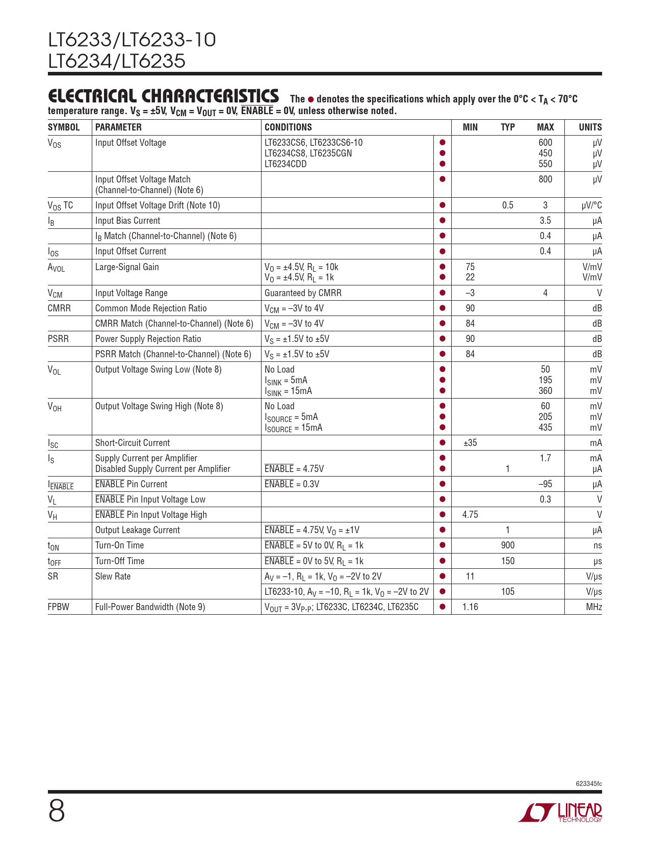

elecTrical characTerisTics. The. denotes the specifications which apply over the 0°C < TA < 70°C
elecTrical characTerisTics The denotes the specifications which apply over the 0°C < TA < 70°C
LT6233/LT6233-10 LT6234/LT6235
l
denotes the specifications which apply over the 0°C < TA < 70°C temperature range. VS = ±5V, VCM = VOUT = 0V, ENABLE = 0V, unless otherwise noted. SYMBOL PARAMETER CONDITIONS MIN TYP MAX UNITS
VOS Input Offset Voltage LT6233CS6, LT6233CS6-10 l 600 µV LT6234CS8, LT6235CGN l 450 µV LT6234CDD l 550 µV Input Offset Voltage Match l 800 µV (Channel-to-Channel) (Note 6) VOS TC Input Offset Voltage Drift (Note 10) l 0.5 3 µV/°C IB Input Bias Current l 3.5 µA IB Match (Channel-to-Channel) (Note 6) l 0.4 µA IOS Input Offset Current l 0.4 µA AVOL Large-Signal Gain VO = ±4.5V, RL = 10k l 75 V/mV VO = ±4.5V, RL = 1k l 22 V/mV VCM Input Voltage Range Guaranteed by CMRR l –3 4 V CMRR Common Mode Rejection Ratio VCM = –3V to 4V l 90 dB CMRR Match (Channel-to-Channel) (Note 6) VCM = –3V to 4V l 84 dB PSRR Power Supply Rejection Ratio VS = ±1.5V to ±5V l 90 dB PSRR Match (Channel-to-Channel) (Note 6) VS = ±1.5V to ±5V l 84 dB VOL Output Voltage Swing Low (Note 8) No Load l 50 mV ISINK = 5mA l 195 mV ISINK = 15mA l 360 mV VOH Output Voltage Swing High (Note 8) No Load l 60 mV ISOURCE = 5mA l 205 mV ISOURCE = 15mA l 435 mV ISC Short-Circuit Current l ±35 mA IS Supply Current per Amplifier l 1.7 mA Disabled Supply Current per Amplifier ENABLE = 4.75V l 1 µA IENABLE ENABLE Pin Current ENABLE = 0.3V l –95 µA VL ENABLE Pin Input Voltage Low l 0.3 V VH ENABLE Pin Input Voltage High l 4.75 V Output Leakage Current ENABLE = 4.75V, VO = ±1V l 1 µA tON Turn-On Time ENABLE = 5V to 0V, RL = 1k l 900 ns tOFF Turn-Off Time ENABLE = 0V to 5V, RL = 1k l 150 µs SR Slew Rate AV = –1, RL = 1k, VO = –2V to 2V l 11 V/µs LT6233-10, AV = –10, RL = 1k, VO = –2V to 2V l 105 V/µs FPBW Full-Power Bandwidth (Note 9) VOUT = 3VP-P ; LT6233C, LT6234C, LT6235C l 1.16 MHz 623345fc 8 Document Outline Features Applications Description Typical Application Absolute Maximum Ratings Pin Configuration Order Information Electrical Characteristics Typical Performance Characteristics Applications Information Typical Applications Package Description Revision History Typical Applications Related Parts
