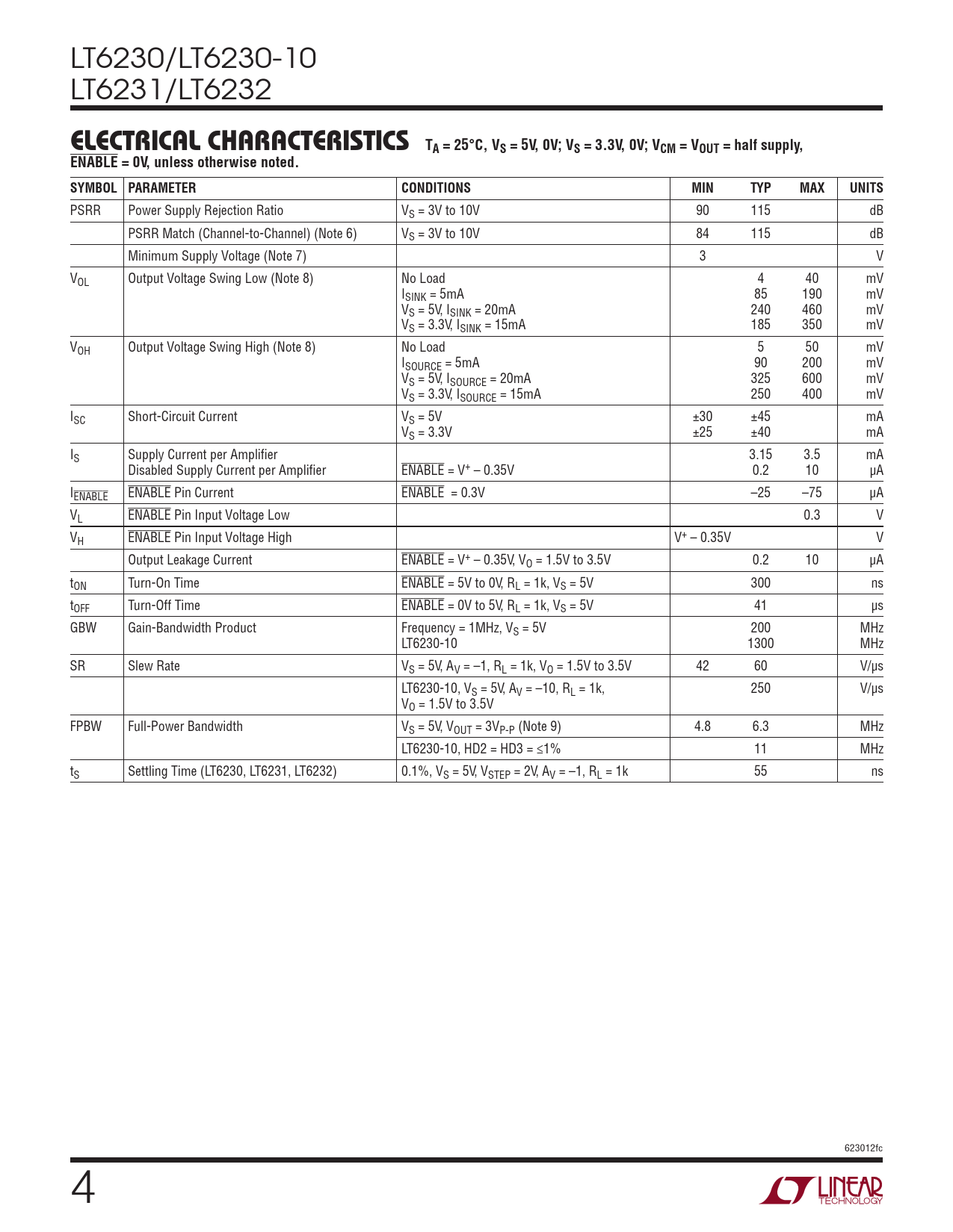

elecTrical characTerisTics TA = 25°C, VS = 5V, 0V; VS = 3.3V, 0V; VCM = VOUT = half supply, ENABLE = 0V, unless otherwise noted. SYMBOL PARAMETER CONDITIONS MIN TYP MAX UNITS
PSRR Power Supply Rejection Ratio VS = 3V to 10V 90 115 dB PSRR Match (Channel-to-Channel) (Note 6) VS = 3V to 10V 84 115 dB Minimum Supply Voltage (Note 7) 3 V VOL Output Voltage Swing Low (Note 8) No Load 4 40 mV ISINK = 5mA 85 190 mV VS = 5V, ISINK = 20mA 240 460 mV VS = 3.3V, ISINK = 15mA 185 350 mV VOH Output Voltage Swing High (Note 8) No Load 5 50 mV ISOURCE = 5mA 90 200 mV VS = 5V, ISOURCE = 20mA 325 600 mV VS = 3.3V, ISOURCE = 15mA 250 400 mV ISC Short-Circuit Current VS = 5V ±30 ±45 mA VS = 3.3V ±25 ±40 mA IS Supply Current per Amplifier 3.15 3.5 mA Disabled Supply Current per Amplifier ENABLE = V+ – 0.35V 0.2 10 µA IENABLE ENABLE Pin Current ENABLE = 0.3V –25 –75 µA VL ENABLE Pin Input Voltage Low 0.3 V VH ENABLE Pin Input Voltage High V+ – 0.35V V Output Leakage Current ENABLE = V+ – 0.35V, VO = 1.5V to 3.5V 0.2 10 µA tON Turn-On Time ENABLE = 5V to 0V, RL = 1k, VS = 5V 300 ns tOFF Turn-Off Time ENABLE = 0V to 5V, RL = 1k, VS = 5V 41 µs GBW Gain-Bandwidth Product Frequency = 1MHz, VS = 5V 200 MHz LT6230-10 1300 MHz SR Slew Rate VS = 5V, A V = –1, RL = 1k, VO = 1.5V to 3.5V 42 60 V/µs LT6230-10, VS = 5V, AV = –10, RL = 1k, 250 V/µs VO = 1.5V to 3.5V FPBW Full-Power Bandwidth VS = 5V, VOUT = 3VP-P (Note 9) 4.8 6.3 MHz LT6230-10, HD2 = HD3 = ≤1% 11 MHz tS Settling Time (LT6230, LT6231, LT6232) 0.1%, VS = 5V, VSTEP = 2V, AV = –1, RL = 1k 55 ns 623012fc 4 Document Outline Features Applications Description Typical Application Absolute Maximum Ratings Pin Configuration Order Information Electrical Characteristics Typical Performance Characteristics Applications Information Typical Applications Package Description Revision History Typical Applications Related Parts
