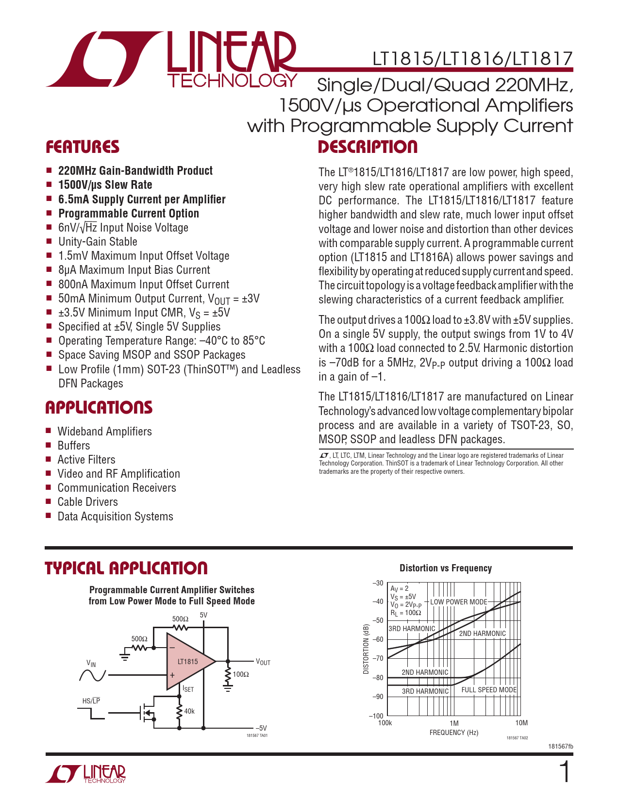

LT1815/LT1816/LT1817 Single/Dual/Quad 220MHz, 1500V/µs Operational Amplifi ers with Programmable Supply Current
FEATURES DESCRIPTION
n
220MHz Gain-Bandwidth Product
The LT®1815/LT1816/LT1817 are low power, high speed, n
1500V/μs Slew Rate
very high slew rate operational amplifi ers with excellent n
6.5mA Supply Current per Amplifi er
DC performance. The LT1815/LT1816/LT1817 feature n
Programmable Current Option
higher bandwidth and slew rate, much lower input offset n 6nV/√Hz Input Noise Voltage voltage and lower noise and distortion than other devices n Unity-Gain Stable with comparable supply current. A programmable current n 1.5mV Maximum Input Offset Voltage option (LT1815 and LT1816A) allows power savings and n 8μA Maximum Input Bias Current fl exibility by operating at reduced supply current and speed. n 800nA Maximum Input Offset Current The circuit topology is a voltage feedback amplifi er with the n 50mA Minimum Output Current, VOUT = ±3V slewing characteristics of a current feedback amplifi er. n ±3.5V Minimum Input CMR, VS = ±5V The output drives a 100Ω load to ±3.8V with ±5V supplies. n Specifi ed at ±5V, Single 5V Supplies On a single 5V supply, the output swings from 1V to 4V n Operating Temperature Range: –40°C to 85°C with a 100Ω load connected to 2.5V. Harmonic distortion n Space Saving MSOP and SSOP Packages is –70dB for a 5MHz, 2VP-P output driving a 100Ω load n Low Profi le (1mm) SOT-23 (ThinSOT™) and Leadless in a gain of –1. DFN Packages The LT1815/LT1816/LT1817 are manufactured on Linear
APPLICATIONS
Technology’s advanced low voltage complementary bipolar process and are available in a variety of TSOT-23, SO, n Wideband Amplifi ers MSOP, SSOP and leadless DFN packages. n Buffers n Active Filters L, LT, LTC, LTM, Linear Technology and the Linear logo are registered trademarks of Linear Technology Corporation. ThinSOT is a trademark of Linear Technology Corporation. All other n Video and RF Amplifi cation trademarks are the property of their respective owners. n Communication Receivers n Cable Drivers n Data Acquisition Systems
TYPICAL APPLICATION Distortion vs Frequency
–30
Programmable Current Amplifi er Switches
AV = 2
from Low Power Mode to Full Speed Mode
VS = ±5V –40 LOW POWER MODE VO = 2VP-P 5V RL = 100Ω 500Ω –50 3RD HARMONIC 2ND HARMONIC 500Ω –60 – LT1815 V –70 V OUT IN + 100Ω DISTORTION (dB) 2ND HARMONIC –80 ISET 3RD HARMONIC FULL SPEED MODE –90 HS/LP 40k –100 100k 1M 10M –5V FREQUENCY (Hz) 181567 TA01 181567 TA02 181567fb 1
