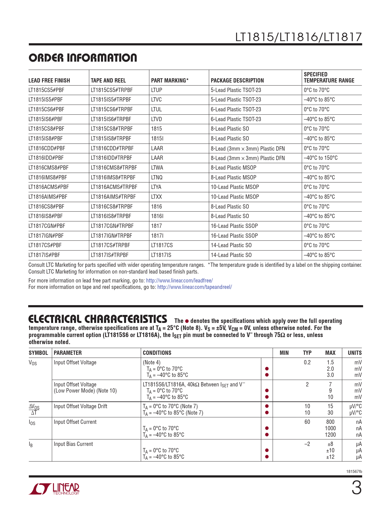

ORDER INFORMATION. SPECIFIED. LEAD FREE FINISH. TAPE AND REEL. PART MARKING*. PACKAGE DESCRIPTION. TEMPERATURE RANGE
ORDER INFORMATION SPECIFIED LEAD FREE FINISH TAPE AND REEL PART MARKING* PACKAGE DESCRIPTION TEMPERATURE RANGE
LT1815/LT1816/LT1817
LT1815CS5#PBF LT1815CS5#TRPBF LTUP 5-Lead Plastic TSOT-23 0°C to 70°C LT1815IS5#PBF LT1815IS5#TRPBF LTVC 5-Lead Plastic TSOT-23 –40°C to 85°C LT1815CS6#PBF LT1815CS6#TRPBF LTUL 6-Lead Plastic TSOT-23 0°C to 70°C LT1815IS6#PBF LT1815IS6#TRPBF LTVD 6-Lead Plastic TSOT-23 –40°C to 85°C LT1815CS8#PBF LT1815CS8#TRPBF 1815 8-Lead Plastic SO 0°C to 70°C LT1815IS8#PBF LT1815IS8#TRPBF 1815I 8-Lead Plastic SO –40°C to 85°C LT1816CDD#PBF LT1816CDD#TRPBF LAAR 8-Lead (3mm × 3mm) Plastic DFN 0°C to 70°C LT1816IDD#PBF LT1816IDD#TRPBF LAAR 8-Lead (3mm × 3mm) Plastic DFN –40°C to 150°C LT1816CMS8#PBF LT1816CMS8#TRPBF LTWA 8-Lead Plastic MSOP 0°C to 70°C LT1816IMS8#PBF LT1816IMS8#TRPBF LTNQ 8-Lead Plastic MSOP –40°C to 85°C LT1816ACMS#PBF LT1816ACMS#TRPBF LTYA 10-Lead Plastic MSOP 0°C to 70°C LT1816AIMS#PBF LT1816AIMS#TRPBF LTXX 10-Lead Plastic MSOP –40°C to 85°C LT1816CS8#PBF LT1816CS8#TRPBF 1816 8-Lead Plastic SO 0°C to 70°C LT1816IS8#PBF LT1816IS8#TRPBF 1816I 8-Lead Plastic SO –40°C to 85°C LT1817CGN#PBF LT1817CGN#TRPBF 1817 16-Lead Plastic SSOP 0°C to 70°C LT1817IGN#PBF LT1817IGN#TRPBF 1817I 16-Lead Plastic SSOP –40°C to 85°C LT1817CS#PBF LT1817CS#TRPBF LT1817CS 14-Lead Plastic SO 0°C to 70°C LT1817IS#PBF LT1817IS#TRPBF LT1817IS 14-Lead Plastic SO –40°C to 85°C Consult LTC Marketing for parts specifi ed with wider operating temperature ranges. *The temperature grade is identifi ed by a label on the shipping container. Consult LTC Marketing for information on non-standard lead based fi nish parts. For more information on lead free part marking, go to: http://www.linear.com/leadfree/ For more information on tape and reel specifi cations, go to: http://www.linear.com/tapeandreel/

denotes the specifi cations which apply over the full operating temperature range, otherwise specifi cations are at TA = 25°C (Note 8). VS = ±5V, VCM = 0V, unless otherwise noted. For the programmable current option (LT1815S6 or LT1816A), the ISET pin must be connected to V– through 75Ω or less, unless otherwise noted. SYMBOL PARAMETER CONDITIONS MIN TYP MAX UNITS
VOS Input Offset Voltage (Note 4) 0.2 1.5 mV TA = 0°C to 70°C l 2.0 mV TA = –40°C to 85°C l 3.0 mV Input Offset Voltage LT1815S6/LT1816A, 40kΩ Between ISET and V– 2 7 mV (Low Power Mode) (Note 10) TA = 0°C to 70°C l 9 mV TA = –40°C to 85°C l 10 mV ΔVOS Input Offset Voltage Drift TA = 0°C to 70°C (Note 7) l 10 15 μV/°C ΔT TA = –40°C to 85°C (Note 7) l 10 30 μV/°C IOS Input Offset Current 60 800 nA TA = 0°C to 70°C l 1000 nA TA = –40°C to 85°C l 1200 nA IB Input Bias Current –2 ±8 μA TA = 0°C to 70°C l ±10 μA TA = –40°C to 85°C l ±12 μA 181567fb 3
