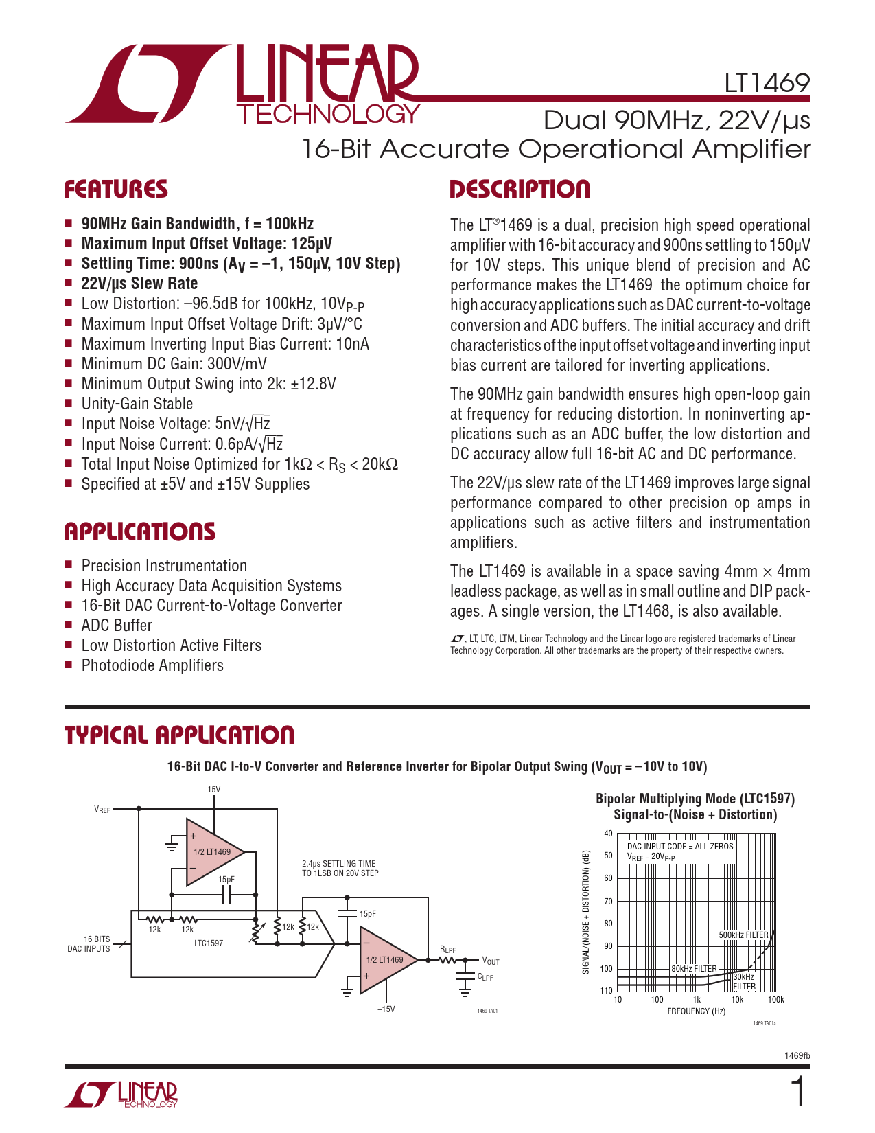

DescriptionDual 90MHz, 22V/µs 16-Bit Accurate Operational Amplifier

LT1469 Dual 90MHz, 22V/µs 16-Bit Accurate Operational Amplifier
FEATURES DESCRIPTION
n
90MHz Gain Bandwidth, f = 100kHz
The LT®1469 is a dual, precision high speed operational n
Maximum Input Offset Voltage: 125µV
amplifier with 16-bit accuracy and 900ns settling to 150µV n
Settling Time: 900ns (AV = –1, 150µV, 10V Step)
for 10V steps. This unique blend of precision and AC n
22V/µs Slew Rate
performance makes the LT1469 the optimum choice for n Low Distortion: –96.5dB for 100kHz, 10VP-P high accuracy applications such as DAC current-to-voltage n Maximum Input Offset Voltage Drift: 3µV/°C conversion and ADC buffers. The initial accuracy and drift n Maximum Inverting Input Bias Current: 10nA characteristics of the input offset voltage and inverting input n Minimum DC Gain: 300V/mV bias current are tailored for inverting applications. n Minimum Output Swing into 2k: ±12.8V The 90MHz gain bandwidth ensures high open-loop gain n Unity-Gain Stable at frequency for reducing distortion. In noninverting ap- n Input Noise Voltage: 5nV/√Hz plications such as an ADC buffer, the low distortion and n Input Noise Current: 0.6pA/√Hz DC accuracy allow full 16-bit AC and DC performance. n Total Input Noise Optimized for 1kΩ < RS < 20kΩ n Specified at ±5V and ±15V Supplies The 22V/µs slew rate of the LT1469 improves large signal performance compared to other precision op amps in

applications such as active filters and instrumentation amplifiers. n Precision Instrumentation The LT1469 is available in a space saving 4mm × 4mm n High Accuracy Data Acquisition Systems leadless package, as well as in small outline and DIP pack- n 16-Bit DAC Current-to-Voltage Converter ages. A single version, the LT1468, is also available. n ADC Buffer L, LT, LTC, LTM, Linear Technology and the Linear logo are registered trademarks of Linear n Low Distortion Active Filters Technology Corporation. All other trademarks are the property of their respective owners. n Photodiode Amplifiers
TYPICAL APPLICATION 16-Bit DAC I-to-V Converter and Reference Inverter for Bipolar Output Swing (VOUT = –10V to 10V)
