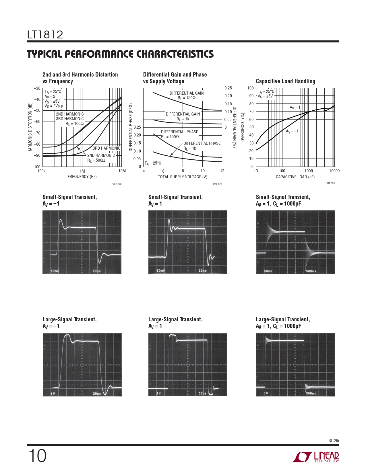

| Description | 3mA, 100MHz, 750V/µs Operational Amplifier with Shutdown |
| Pages / Page | 16 / 10 — TYPICAL PERFORMANCE CHARACTERISTICS. 2nd and 3rd Harmonic Distortion. … |
| File Format / Size | PDF / 251 Kb |
TYPICAL PERFORMANCE CHARACTERISTICS. 2nd and 3rd Harmonic Distortion. Differential Gain and Phase. vs Frequency
LT1812
TYPICAL PERFORMANCE CHARACTERISTICS 2nd and 3rd Harmonic Distortion Differential Gain and Phase vs Frequency vs Supply Voltage Capacitive Load Handling
–30 0.25 100 TA = 25°C DIFFERENTIAL GAIN TA = 25°C A 0.20 90 VS = ±5V –40 V = 2 RL = 150Ω VS = ±5V 0.15 80 VO = 2VP-P DIFFERENTIAL GAIN (%) AV = 1 –50 0.10 70 2ND HARMONIC DIFFERENTIAL GAIN 3RD HARMONIC RL = 1k 0.05 60 –60 RL = 100Ω 0.25 0 50 –70 DIFFERENTIAL PHASE AV = –1 0.20 R 40 L = 150Ω OVERSHOOT (%) –80 0.15 DIFFERENTIAL PHASE 30 3RD HARMONIC R HARMONIC DISTORTION (dB) DIFFERENTIAL PHASE (DEG) 0.10 L = 1k 20 –90 2ND HARMONIC R 0.05 10 L = 500Ω TA = 25°C –100 0 0 100k 1M 10M 4 6 8 10 12 10 100 1000 10000 FREQUENCY (Hz) TOTAL SUPPLY VOLTAGE (V) CAPACITIVE LOAD (pF) 1812 G28 1812 G29 1812 G30
Small-Signal Transient, Small-Signal Transient, Small-Signal Transient, AV = –1 AV = 1 AV = 1, CL = 1000pF Large-Signal Transient, Large-Signal Transient, Large-Signal Transient, AV = –1 AV = 1 AV = 1, CL = 1000pF
