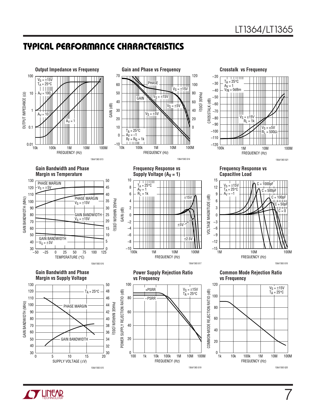

TYPICAL PERFORMANCE CHARACTERISTICS. Output Impedance vs Frequency. Gain and Phase vs Frequency. Crosstalk vs Frequency
LT1364/LT1365
W U TYPICAL PERFORMANCE CHARACTERISTICS Output Impedance vs Frequency Gain and Phase vs Frequency Crosstalk vs Frequency
100 70 120 – 20 VS = ±15V T T PHASE – 30 A = 25°C A = 25°C 60 100 AV = 1 VS = ±15V PHASE (DEG) – 40 VIN = 0dBm ) Ω 10 AV = 100 50 80 VS = ±15V – 50 GAIN 40 60 – 60 VS = ±5V 1 30 40 –70 A V V = 10 GAIN (dB) S = ±5V 20 20 – 80 VS = ±15V AV = 1 CROSSTALK (dB) RL = 1k – 90 OUTPUT IMPEDANCE ( 0.1 10 0 VS = ±5V TA = 25°C –100 RL = 500Ω 0 AV = –1 –110 RF = RG = 1k 0.01 –10 –120 10k 100k 1M 10M 100M 10k 100k 1M 10M 100M 100k 1M 10M 100M FREQUENCY (Hz) FREQUENCY (Hz) FREQUENCY (Hz) 1364/1365 G13 1364/1365 G14 1364/1365 G21
Gain Bandwidth and Phase Frequency Response vs Frequency Response vs Margin vs Temperature Supply Voltage (A Capacitive Load V = 1)
130 50 10 15 PHASE MARGIN T V C = 1000pF 120 V 45 A = 25°C S = ±15V S = ± 5V 8 12 A T V = 1 A = 25°C C = 500pF 110 40 6 RL = 1k 9 AV = –1 PHASE MARGIN (DEG) PHASE MARGIN ±15V C = 100pF 100 35 4 6 VS = ±15V C = 50pF 90 30 2 3 C = 0 80 GAIN BANDWIDTH 25 0 0 VS = ±15V 70 20 GAIN (dB) –2 – 3 ±5V 60 15 –4 – 6 GAIN BANDWIDTH (MHz) 50 10 VOLTAGE MAGNITUDE (dB) –6 – 9 GAIN BANDWIDTH ±2.5V 40 5 V –8 –12 S = ± 5V 30 0 –10 –15 – 50 –25 0 25 50 75 100 125 100k 1M 10M 100M 1M 10M 100M TEMPERATURE (°C) FREQUENCY (Hz) FREQUENCY (Hz) 1364/1365 G16 1364/1365 G17 1364/1365 G18
Gain Bandwidth and Phase Power Supply Rejection Ratio Common Mode Rejection Ratio Margin vs Supply Voltage vs Frequency vs Frequency
130 50 100 120 VS = ±15V +PSRR V 120 T 48 S = ±15V A = 25°C TA = 25°C TA = 25°C 100 110 46 80 – PSRR PHASE MARGIN (DEG) 100 44 PHASE MARGIN 80 90 42 60 80 40 60 70 38 40 40 60 36 GAIN BANDWIDTH (MHz) 50 GAIN BANDWIDTH 34 20 20 40 32 POWER SUPPLY REJECTION RATIO (dB) COMMON-MODE REJECTION RATIO (dB) 30 30 0 0 0 5 10 15 20 100 1k 10k 100k 1M 10M 100M 1k 10k 100k 1M 10M 100M SUPPLY VOLTAGE (±V) FREQUENCY (Hz) FREQUENCY (Hz) 1364/1365 G15 1364/1365 G19 1364/1365 G20 7
