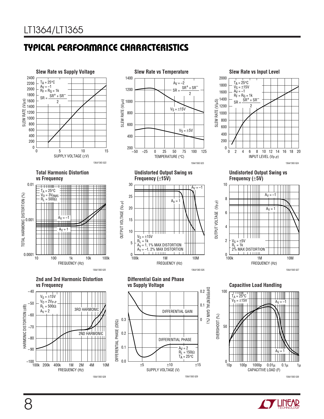

TYPICAL PERFORMANCE CHARACTERISTICS. Slew Rate vs Supply Voltage. Slew Rate vs Temperature. Slew Rate vs Input Level
LT1364/LT1365
W U TYPICAL PERFORMANCE CHARACTERISTICS Slew Rate vs Supply Voltage Slew Rate vs Temperature Slew Rate vs Input Level
2400 1400 2000 2200 TA = 25°C A T V = –2 A = 25°C A 1800 V = –1 V 2000 SR+ + SR– S = ±15V R 1200 F = RG = 1k SR = ————— 1600 AV = –1 1800 2 SR+ + SR– R SR = F = RG = 1k ————— 1400 µs) 1600 2 SR+ + SR– µs) 1000 µS) SR = ————— 1400 1200 2 VS = ±15V 1200 800 1000 1000 800 SLEW RATE (V/ 800 SLEW RATE (V/ 600 SLEW RATE (V/ 600 600 VS = ±5V 400 400 400 200 200 0 200 0 0 5 10 15 – 50 –25 0 25 50 75 100 125 0 2 4 6 8 10 12 14 16 18 20 SUPPLY VOLTAGE (±V) TEMPERATURE (°C) INPUT LEVEL (VP-P) 1364/1365 G22 1364/1365 G23 1364/1365 G24
Total Harmonic Distortion Undistorted Output Swing vs Undistorted Output Swing vs vs Frequency Frequency (
15V) Frequency (
5V)
0.01 30 10 AV = –1 TA = 25°C V A O = 3VRMS 25 V = –1 R 8 L = 500Ω ) A ) V = 1 P-P P-P 20 AV = 1 6 A 0.001 V = –1 15 4 AV = 1 10 OUTPUT VOLTAGE (V VS = ±15V OUTPUT VOLTAGE (V R 2 V 5 L = 1k S = ±5V TOTAL HARMONIC DISTORTION (%) AV = 1, 1% MAX DISTORTION RL = 1k AV = –1, 2% MAX DISTORTION 2% MAX DISTORTION 0.0001 0 0 10 100 1k 10k 100k 100k 1M 10M 100k 1M 10M FREQUENCY (Hz) FREQUENCY (Hz) FREQUENCY (Hz) 1364/1365 G25 1364/1365 G26 1364/1365 G27
2nd and 3rd Harmonic Distortion Differential Gain and Phase vs Frequency vs Supply Voltage
DIFFERENTIAL GAIN (%)
Capacitive Load Handling
– 40 0.2 100 VS = ±15V TA = 25°C V VS = ±15V – 50 O = 2VP-P AV = –1 R 0.1 L = 500Ω AV = 2 3RD HARMONIC DIFFERENTIAL GAIN – 60 0.3 0 –70 50 2ND HARMONIC 0.2 – 80 OVERSHOOT (%) DIFFERENTIAL PHASE HARMONIC DISTORTION (dB) 0.1 – 90 AV = 2 AV = 1 RL = 150Ω TA = 25°C –100 DIFFERENTIAL PHASE (DEG) 0.0 0 100k 200k 400k 1M 2M 4M 10M ±5 ±10 ±15 10p 100p 1000p 0.01µ 0.1µ 1µ FREQUENCY (Hz) SUPPLY VOLTAGE (V) CAPACITIVE LOAD (F) 1364/1365 G28 1364/1365 G29 1364/1365 G30 8
