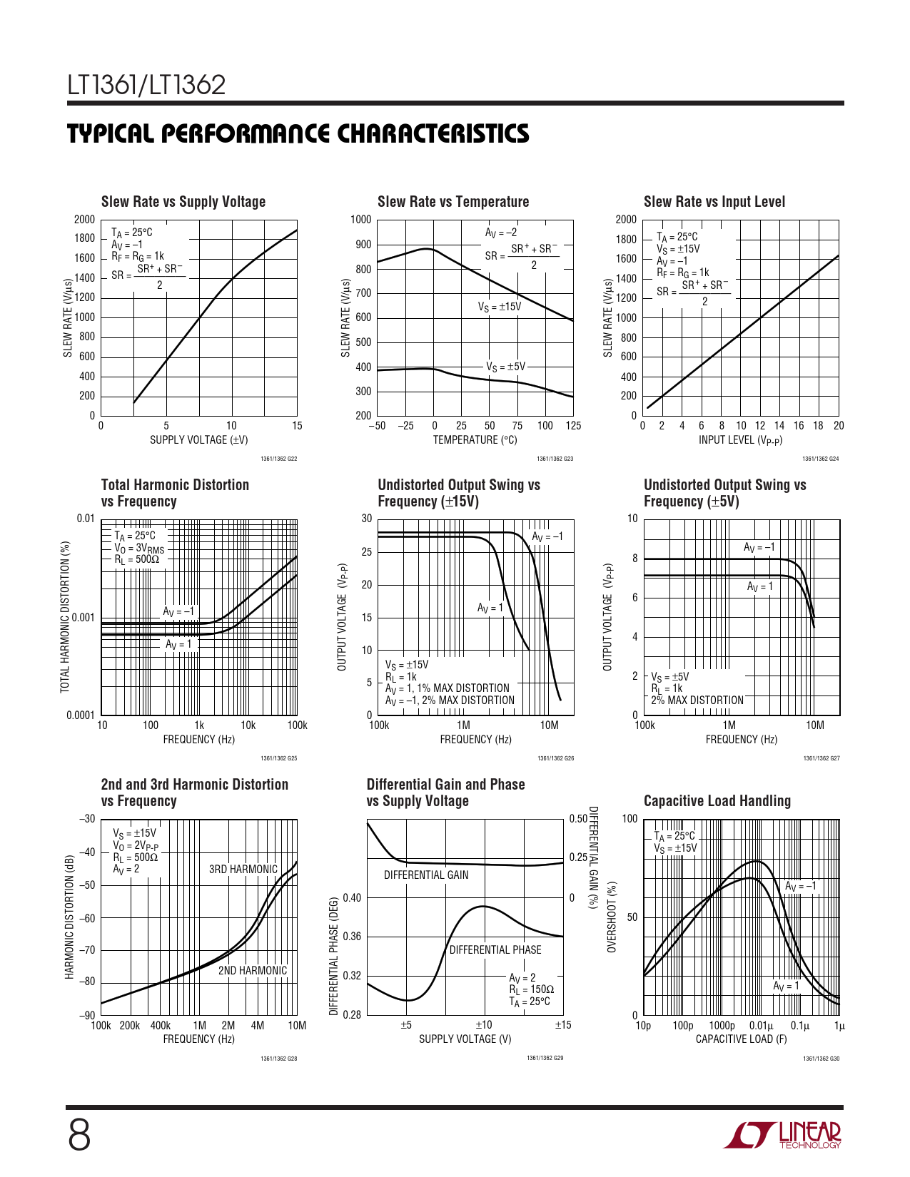

TYPICAL PERFORMANCE CHARACTERISTICS. Slew Rate vs Supply Voltage. Slew Rate vs Temperature. Slew Rate vs Input Level
LT1361/LT1362
W U TYPICAL PERFORMANCE CHARACTERISTICS Slew Rate vs Supply Voltage Slew Rate vs Temperature Slew Rate vs Input Level
2000 1000 2000 T A 1800 A = 25°C V = –2 T A 1800 A = 25°C V = –1 900 SR + + SR – VS = ±15V 1600 RF = RG = 1k SR = ————— 1600 AV = –1 SR+ + SR – 800 2 R 1400 SR = ————— 1400 F = RG = 1k µs) 2 µs) µs) SR + + SR – SR = 1200 700 ————— 1200 V 2 S = ±15V 1000 600 1000 800 500 800 SLEW RATE (V/ 600 SLEW RATE (V/ SLEW RATE (V/ 600 400 VS = ±5V 400 400 200 300 200 0 200 0 0 5 10 15 – 50 –25 0 25 50 75 100 125 0 2 4 6 8 10 12 14 16 18 20 SUPPLY VOLTAGE (±V) TEMPERATURE (°C) INPUT LEVEL (VP-P) 1361/1362 G22 1361/1362 G23 1361/1362 G24
Total Harmonic Distortion Undistorted Output Swing vs Undistorted Output Swing vs vs Frequency Frequency (
15V) Frequency (
5V)
0.01 30 10 TA = 25°C AV = –1 VO = 3VRMS A 25 V = –1 RL = 500Ω ) 8 P-P P-P 20 AV = 1 6 A AV = 1 0.001 V = –1 15 4 AV = 1 10 OUTPUT VOLTAGE (V VS = ±15V OUTPUT VOLTAGE (V R 2 V 5 L = 1k S = ±5V TOTAL HARMONIC DISTORTION (%) AV = 1, 1% MAX DISTORTION RL = 1k AV = –1, 2% MAX DISTORTION 2% MAX DISTORTION 0.0001 0 0 10 100 1k 10k 100k 100k 1M 10M 100k 1M 10M FREQUENCY (Hz) FREQUENCY (Hz) FREQUENCY (Hz) 1361/1362 G25 1361/1362 G26 1361/1362 G27
2nd and 3rd Harmonic Distortion Differential Gain and Phase vs Frequency vs Supply Voltage
DIFFERENTIAL GAIN (%)
Capacitive Load Handling
–30 0.50 100 VS = ±15V TA = 25°C V –40 O = 2VP-P VS = ±15V RL = 500Ω 0.25 AV = 2 3RD HARMONIC DIFFERENTIAL GAIN –50 AV = –1 0.40 0 –60 50 0.36 –70 DIFFERENTIAL PHASE OVERSHOOT (%) 2ND HARMONIC HARMONIC DISTORTION (dB) 0.32 –80 AV = 2 AV = 1 RL = 150Ω TA = 25°C –90 DIFFERENTIAL PHASE (DEG) 0.28 0 100k 200k 400k 1M 2M 4M 10M ±5 ±10 ±15 10p 100p 1000p 0.01µ 0.1µ 1µ FREQUENCY (Hz) SUPPLY VOLTAGE (V) CAPACITIVE LOAD (F) 1361/1362 G28 1361/1362 G29 1361/1362 G30 8
