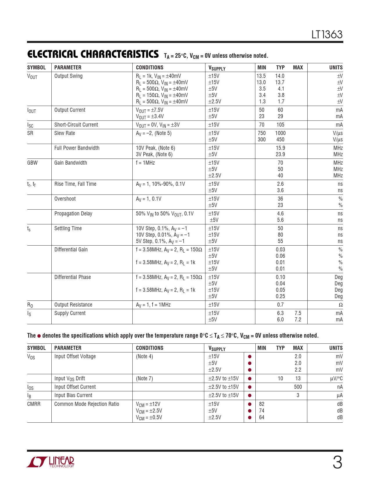

ELECTRICAL CHARACTERISTICS TA = 25. C, VCM = 0V unless otherwise noted. SYMBOL. PARAMETER. CONDITIONS. VSUPPLY. MIN. TYP. MAX. UNITS. The
LT1363
C, VCM = 0V unless otherwise noted. SYMBOL PARAMETER CONDITIONS VSUPPLY MIN TYP MAX UNITS
VOUT Output Swing RL = 1k, VIN = ±40mV ±15V 13.5 14.0 ±V RL = 500Ω, VIN = ±40mV ±15V 13.0 13.7 ±V RL = 500Ω, VIN = ±40mV ±5V 3.5 4.1 ±V RL = 150Ω, VIN = ±40mV ±5V 3.4 3.8 ±V RL = 500Ω, VIN = ±40mV ±2.5V 1.3 1.7 ±V IOUT Output Current VOUT = ±7.5V ±15V 50 60 mA VOUT = ±3.4V ±5V 23 29 mA ISC Short-Circuit Current VOUT = 0V, VIN = ±3V ±15V 70 105 mA SR Slew Rate AV = –2, (Note 5) ±15V 750 1000 V/µs ±5V 300 450 V/µs Full Power Bandwidth 10V Peak, (Note 6) ±15V 15.9 MHz 3V Peak, (Note 6) ±5V 23.9 MHz GBW Gain Bandwidth f = 1MHz ±15V 70 MHz ±5V 50 MHz ±2.5V 40 MHz tr, tf Rise Time, Fall Time AV = 1, 10%-90%, 0.1V ±15V 2.6 ns ±5V 3.6 ns Overshoot AV = 1, 0.1V ±15V 36 % ±5V 23 % Propagation Delay 50% VIN to 50% VOUT, 0.1V ±15V 4.6 ns ±5V 5.6 ns ts Settling Time 10V Step, 0.1%, AV = –1 ±15V 50 ns 10V Step, 0.01%, AV = –1 ±15V 80 ns 5V Step, 0.1%, AV = –1 ±5V 55 ns Differential Gain f = 3.58MHz, AV = 2, RL = 150Ω ±15V 0.03 % ±5V 0.06 % f = 3.58MHz, AV = 2, RL = 1k ±15V 0.01 % ±5V 0.01 % Differential Phase f = 3.58MHz, AV = 2, RL = 150Ω ±15V 0.10 Deg ±5V 0.04 Deg f = 3.58MHz, AV = 2, RL = 1k ±15V 0.05 Deg ±5V 0.25 Deg RO Output Resistance AV = 1, f = 1MHz ±15V 0.7 Ω IS Supply Current ±15V 6.3 7.5 mA ±5V 6.0 7.2 mA
The
denotes the specifications which apply over the temperature range 0
C
TA
70
VOS Input Offset Voltage (Note 4) ±15V ● 2.0 mV ±5V ● 2.0 mV ±2.5V ● 2.2 mV Input VOS Drift (Note 7) ±2.5V to ±15V ● 10 13 µV/°C IOS Input Offset Current ±2.5V to ±15V ● 500 nA IB Input Bias Current ±2.5V to ±15V ● 3 µA CMRR Common Mode Rejection Ratio VCM = ±12V ±15V ● 82 dB VCM = ±2.5V ±5V ● 74 dB VCM = ±0.5V ±2.5V ● 64 dB 3
