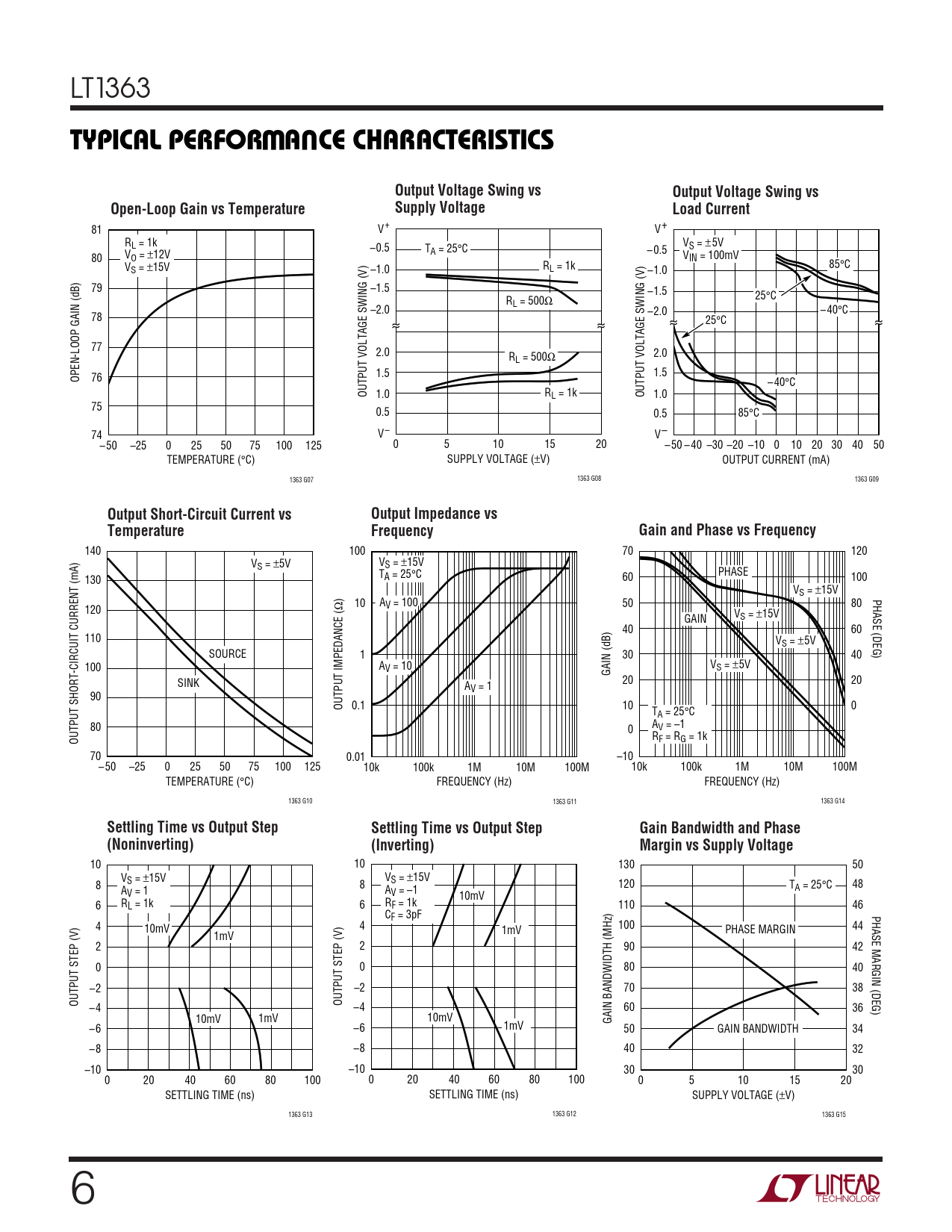

TYPICAL PERFORMANCE CHARACTERISTICS. Output Voltage Swing vs. Open-Loop Gain vs Temperature. Supply Voltage. Load Current
LT1363
W U TYPICAL PERFORMANCE CHARACTERISTICS Output Voltage Swing vs Output Voltage Swing vs Open-Loop Gain vs Temperature Supply Voltage Load Current
81 V + V + RL = 1k –0.5 V T S = ± 5V A = 25°C – 0.5 80 VO = ±12V VIN = 100mV V 85°C S = ±15V –1.0 RL = 1k –1.0 79 –1.5 –1.5 R 25°C L = 500Ω –2.0 –2.0 – 40°C 78 25°C 77 2.0 R 2.0 L = 500Ω 1.5 1.5 OPEN-LOOP GAIN (dB) 76 – 40°C OUTPUT VOLTAGE SWING (V) 1.0 RL = 1k OUTPUT VOLTAGE SWING (V) 1.0 75 0.5 0.5 85°C 74 V – V – – 50 –25 0 25 50 75 100 125 0 5 10 15 20 – 50 – 40 –30 –20 –10 0 10 20 30 40 50 TEMPERATURE (°C) SUPPLY VOLTAGE (±V) OUTPUT CURRENT (mA) 1363 G07 1363 G08 1363 G09
Output Short-Circuit Current vs Output Impedance vs Temperature Frequency Gain and Phase vs Frequency
140 100 70 120 V V S = ±5V S = ±15V T PHASE 130 A = 25°C 60 100 VS = ±15V ) PHASE (DEG) 10 A 50 80 120 Ω V = 100 VS = ±15V GAIN 40 60 110 VS = ±5V SOURCE 1 30 40 100 A V V = 10 GAIN (dB) S = ±5V SINK 20 20 AV = 1 90 OUTPUT IMPEDANCE ( 0.1 10 0 TA = 25°C 80 A 0 V = –1 OUTPUT SHORT-CIRCUIT CURRENT (mA) RF = RG = 1k 70 0.01 –10 – 50 –25 0 25 50 75 100 125 10k 100k 1M 10M 100M 10k 100k 1M 10M 100M TEMPERATURE (°C) FREQUENCY (Hz) FREQUENCY (Hz) 1363 G10 1363 G11 1363 G14
Settling Time vs Output Step Settling Time vs Output Step Gain Bandwidth and Phase (Noninverting) (Inverting) Margin vs Supply Voltage
