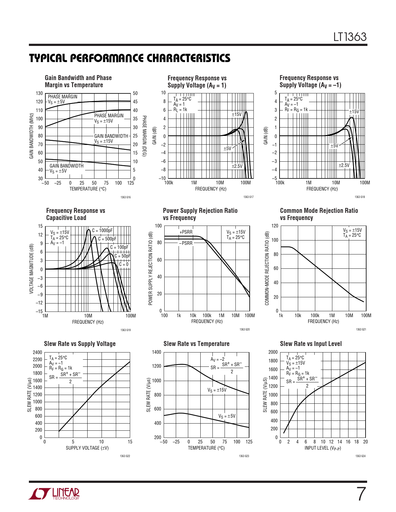

TYPICAL PERFORMANCE CHARACTERISTICS. Gain Bandwidth and Phase. Frequency Response vs. Margin vs Temperature. Supply Voltage (A
LT1363
W U TYPICAL PERFORMANCE CHARACTERISTICS Gain Bandwidth and Phase Frequency Response vs Frequency Response vs Margin vs Temperature Supply Voltage (A Supply Voltage (A V = 1) V = –1)
130 50 10 5 PHASE MARGIN T T 120 V 45 A = 25°C A = 25°C S = ± 5V 8 4 A A V = 1 V = –1 110 40 6 RL = 1k 3 RF = RG = 1k ± PHASE MARGIN (DEG) 15V PHASE MARGIN ±15V 100 35 4 2 VS = ±15V 90 30 2 1 80 GAIN BANDWIDTH 25 0 0 V 70 S = ±15V 20 GAIN (dB) GAIN (dB) –2 –1 ±5V ±5V 60 15 –4 –2 GAIN BANDWIDTH (MHz) 50 10 –6 – 3 GAIN BANDWIDTH ±2.5V ±2.5V 40 5 V –8 – 4 S = ± 5V 30 0 –10 –5 – 50 –25 0 25 50 75 100 125 100k 1M 10M 100M 100k 1M 10M 100M TEMPERATURE (°C) FREQUENCY (Hz) FREQUENCY (Hz) 1363 G16 1363 G17 1363 G18
Frequency Response vs Power Supply Rejection Ratio Common Mode Rejection Ratio Capacitive Load vs Frequency vs Frequency
15 100 120 V V C = 1000pF +PSRR V S = ±15V 12 S = ±15V S = ±15V T T A = 25°C A = 25°C C = 500pF TA = 25°C 100 9 AV = –1 80 – PSRR C = 100pF 6 C = 50pF 80 3 60 C = 0 0 60 – 3 40 40 – 6 VOLTAGE MAGNITUDE (dB) – 9 20 20 –12 POWER SUPPLY REJECTION RATIO (dB) COMMON-MODE REJECTION RATIO (dB) –15 0 0 1M 10M 100M 100 1k 10k 100k 1M 10M 100M 1k 10k 100k 1M 10M 100M FREQUENCY (Hz) FREQUENCY (Hz) FREQUENCY (Hz) 1363 G19 1363 G20 1363 G21
Slew Rate vs Supply Voltage Slew Rate vs Temperature Slew Rate vs Input Level
2400 1400 2000 2200 TA = 25°C A T V = –2 A = 25°C A 1800 V = –1 VS = ±15V 2000 SR+ + SR– R 1200 F = RG = 1k SR = ————— 1600 AV = –1 1800 2 SR+ + SR– RF = RG = 1k SR = ————— 1400 SR+ + SR– µs) 1600 2 µs) 1000 µS) SR = ————— 1400 1200 2 VS = ±15V 1200 800 1000 1000 800 SLEW RATE (V/ 800 SLEW RATE (V/ 600 SLEW RATE (V/ 600 600 VS = ±5V 400 400 400 200 200 0 200 0 0 5 10 15 – 50 –25 0 25 50 75 100 125 0 2 4 6 8 10 12 14 16 18 20 SUPPLY VOLTAGE (±V) TEMPERATURE (°C) INPUT LEVEL (VP-P) 1363 G22 1363 G23 1363 G24 7
