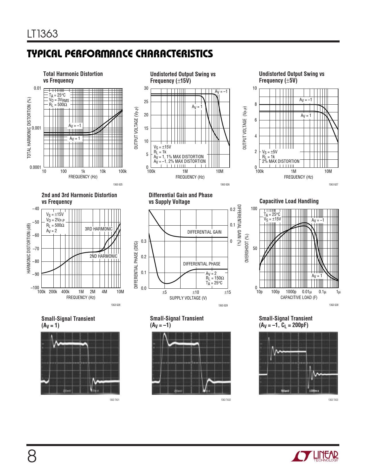

TYPICAL PERFORMANCE CHARACTERISTICS. Total Harmonic Distortion. Undistorted Output Swing vs. vs Frequency. Frequency (. 15V). 5V)
LT1363
W U TYPICAL PERFORMANCE CHARACTERISTICS Total Harmonic Distortion Undistorted Output Swing vs Undistorted Output Swing vs vs Frequency Frequency (
15V) Frequency (
5V)
0.01 30 10 AV = –1 TA = 25°C VO = 3VRMS A 25 V = –1 RL = 500Ω 8 ) A ) V = 1 P-P P-P 20 AV = 1 6 A 0.001 V = –1 15 4 AV = 1 10 OUTPUT VOLTAGE (V VS = ±15V OUTPUT VOLTAGE (V R 2 V 5 L = 1k S = ±5V TOTAL HARMONIC DISTORTION (%) AV = 1, 1% MAX DISTORTION RL = 1k AV = –1, 2% MAX DISTORTION 2% MAX DISTORTION 0.0001 0 0 10 100 1k 10k 100k 100k 1M 10M 100k 1M 10M FREQUENCY (Hz) FREQUENCY (Hz) FREQUENCY (Hz) 1363 G25 1363 G26 1363 G27
2nd and 3rd Harmonic Distortion Differential Gain and Phase vs Frequency vs Supply Voltage Capacitive Load Handling
DIFFERENTIAL GAIN (%) – 40 0.2 100 VS = ±15V TA = 25°C V V – 50 O = 2VP-P S = ±15V AV = –1 RL = 500Ω 0.1 AV = 2 3RD HARMONIC DIFFERENTIAL GAIN – 60 0.3 0 –70 50 2ND HARMONIC 0.2 – 80 OVERSHOOT (%) DIFFERENTIAL PHASE HARMONIC DISTORTION (dB) –90 0.1 AV = 2 A R V = 1 L = 150Ω TA = 25°C –100 DIFFERENTIAL PHASE (DEG) 0.0 0 100k 200k 400k 1M 2M 4M 10M ±5 ±10 ±15 10p 100p 1000p 0.01µ 0.1µ 1µ FREQUENCY (Hz) SUPPLY VOLTAGE (V) CAPACITIVE LOAD (F) 1363 G28 1363 G29 1363 G30
Small-Signal Transient Small-Signal Transient Small-Signal Transient (AV = 1) (AV = –1) (AV = –1, CL = 200pF)
1363 TA31 1363 TA32 1363 TA33 8
