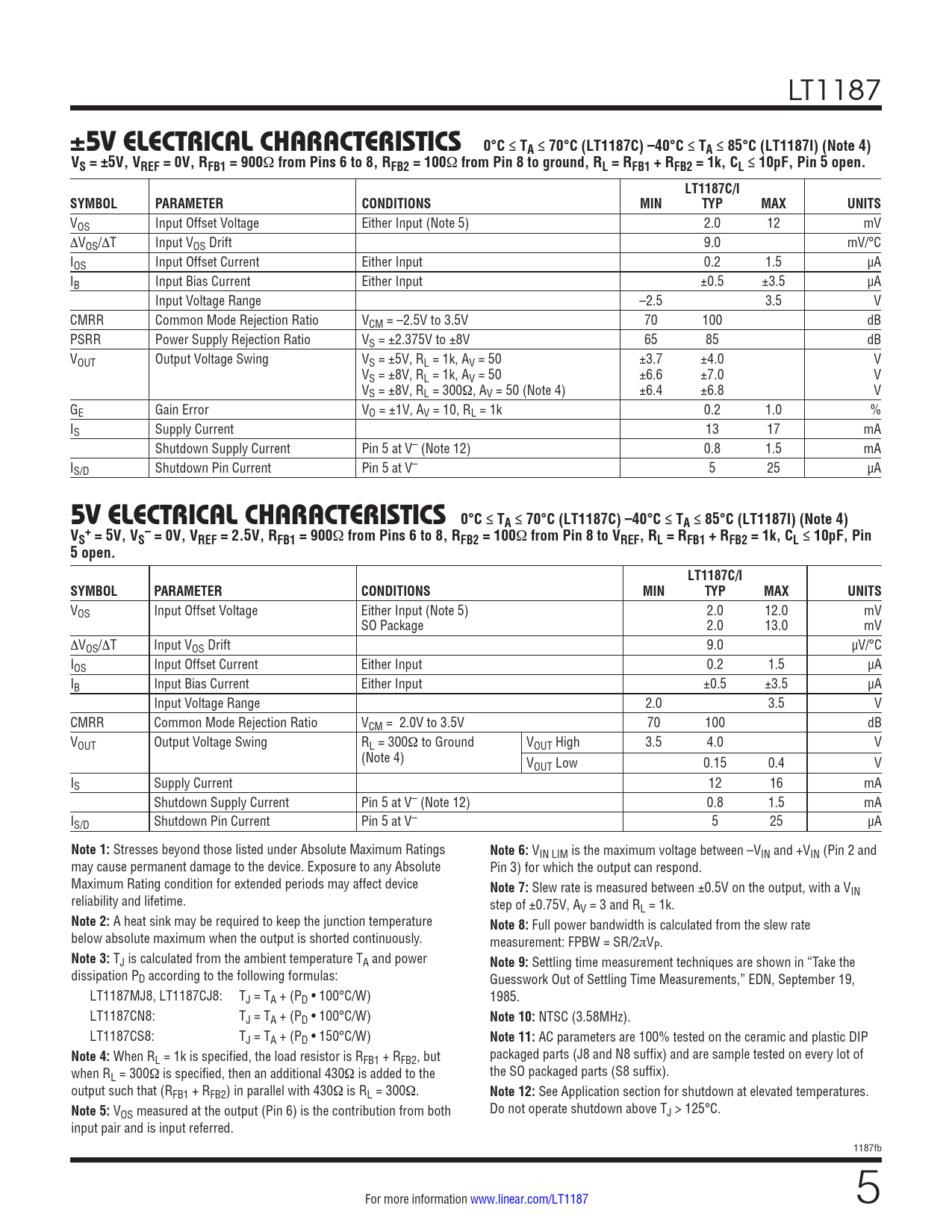

± 5V ELECTRICAL CHARACTERISTICS 0°C ≤ TA ≤ 70°C (LT1187C) –40°C ≤ TA ≤ 85°C (LT1187I) (Note 4)
LT1187
± 5V ELECTRICAL CHARACTERISTICS 0°C ≤ TA ≤ 70°C (LT1187C) –40°C ≤ TA ≤ 85°C (LT1187I) (Note 4) VS = ±5V, VREF = 0V, RFB1 = 900
Ω
from Pins 6 to 8, RFB2 = 100
Ω
from Pin 8 to ground, RL = RFB1 + RFB2 = 1k, CL ≤ 10pF, Pin 5 open. LT1187C/I SYMBOL PARAMETER CONDITIONS MIN TYP MAX UNITS
VOS Input Offset Voltage Either Input (Note 5) 2.0 12 mV ΔVOS/ΔT Input VOS Drift 9.0 mV/°C IOS Input Offset Current Either Input 0.2 1.5 µA IB Input Bias Current Either Input ±0.5 ±3.5 µA Input Voltage Range –2.5 3.5 V CMRR Common Mode Rejection Ratio VCM = –2.5V to 3.5V 70 100 dB PSRR Power Supply Rejection Ratio VS = ±2.375V to ±8V 65 85 dB VOUT Output Voltage Swing VS = ±5V, RL = 1k, AV = 50 ±3.7 ±4.0 V VS = ±8V, RL = 1k, AV = 50 ±6.6 ±7.0 V VS = ±8V, RL = 300Ω, AV = 50 (Note 4) ±6.4 ±6.8 V GE Gain Error VO = ±1V, AV = 10, RL = 1k 0.2 1.0 % IS Supply Current 13 17 mA Shutdown Supply Current Pin 5 at V– (Note 12) 0.8 1.5 mA IS/D Shutdown Pin Current Pin 5 at V– 5 25 µA
5V ELECTRICAL CHARACTERISTICS 0°C ≤ TA ≤ 70°C (LT1187C) –40°C ≤ TA ≤ 85°C (LT1187I) (Note 4) V + S = 5V, VS = 0V, VREF = 2.5V, RFB1 = 900
Ω
Ω
from Pin 8 to VREF, RL = RFB1 + RFB2 = 1k, CL ≤ 10pF, Pin 5 open. LT1187C/I SYMBOL PARAMETER CONDITIONS MIN TYP MAX UNITS
VOS Input Offset Voltage Either Input (Note 5) 2.0 12.0 mV SO Package 2.0 13.0 mV ΔVOS/ΔT Input VOS Drift 9.0 µV/°C IOS Input Offset Current Either Input 0.2 1.5 µA IB Input Bias Current Either Input ±0.5 ±3.5 µA Input Voltage Range 2.0 3.5 V CMRR Common Mode Rejection Ratio VCM = 2.0V to 3.5V 70 100 dB VOUT Output Voltage Swing RL = 300Ω to Ground VOUT High 3.5 4.0 V (Note 4) VOUT Low 0.15 0.4 V IS Supply Current 12 16 mA Shutdown Supply Current Pin 5 at V– (Note 12) 0.8 1.5 mA IS/D Shutdown Pin Current Pin 5 at V– 5 25 µA
Note 1:
Note 6:
VIN LIM is the maximum voltage between –VIN and +VIN (Pin 2 and may cause permanent damage to the device. Exposure to any Absolute Pin 3) for which the output can respond. Maximum Rating condition for extended periods may affect device
Note 7:
Slew rate is measured between ±0.5V on the output, with a VIN reliability and lifetime. step of ±0.75V, AV = 3 and RL = 1k.
Note 2:
A heat sink may be required to keep the junction temperature
Note 8:
Full power bandwidth is calculated from the slew rate below absolute maximum when the output is shorted continuously. measurement: FPBW = SR/2πVP.
Note 3:
TJ is calculated from the ambient temperature TA and power
Note 9:
Settling time measurement techniques are shown in “Take the dissipation PD according to the following formulas: Guesswork Out of Settling Time Measurements,” EDN, September 19, LT1187MJ8, LT1187CJ8: TJ = TA + (PD • 100°C/W) 1985. LT1187CN8: TJ = TA + (PD • 100°C/W)
Note 10:
NTSC (3.58MHz). LT1187CS8: TJ = TA + (PD • 150°C/W)
Note 11:
AC parameters are 100% tested on the ceramic and plastic DIP
Note 4:
When RL = 1k is specified, the load resistor is RFB1 + RFB2, but packaged parts (J8 and N8 suffix) and are sample tested on every lot of when RL = 300Ω is specified, then an additional 430Ω is added to the the SO packaged parts (S8 suffix). output such that (RFB1 + RFB2) in parallel with 430Ω is RL = 300Ω.
Note 12:
See Application section for shutdown at elevated temperatures.
Note 5:
VOS measured at the output (Pin 6) is the contribution from both Do not operate shutdown above TJ > 125°C. input pair and is input referred. 1187fb For more information www.linear.com/LT1187 5 Document Outline Features Applications Typical Application Description Absolute Maximum Ratings Pin Configuration Order Information ±5V Electrical Characteristics 5V Electrical Characteristics Typical Performance Characteristics Applications Information Simplified Schematic Package Description Revision History Related Parts
