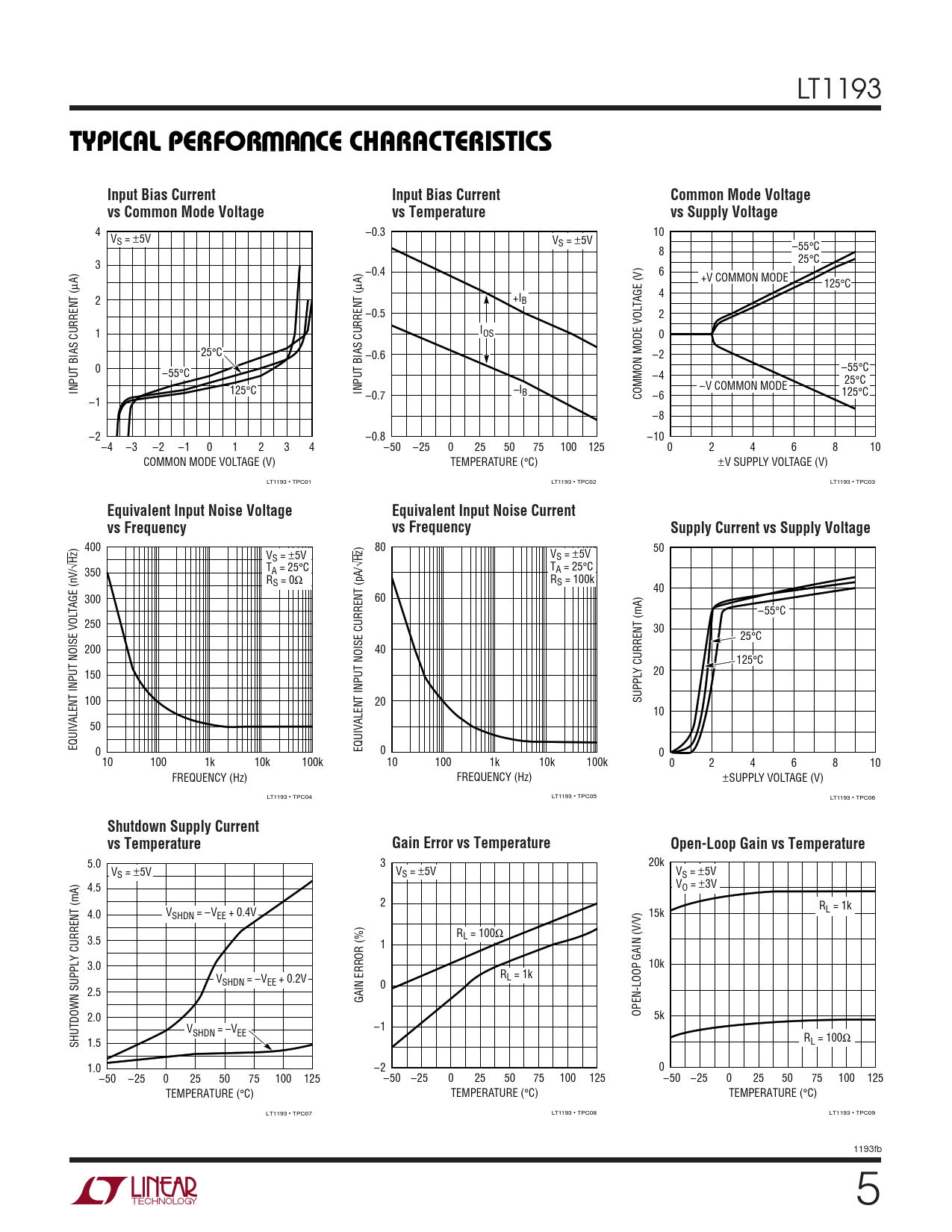

TYPICAL PERFOR A CE CHARACTERISTICS. Input Bias Current. Common Mode Voltage. vs Common Mode Voltage. vs Temperature
LT1193
W U TYPICAL PERFOR A CE CHARACTERISTICS Input Bias Current Input Bias Current Common Mode Voltage vs Common Mode Voltage vs Temperature vs Supply Voltage
4 –0.3 10 VS = ±5V VS = ±5V 8 –55°C 25°C 3 –0.4 6 +V COMMON MODE µA) µA) 125°C +I 4 2 B TAGE (V) –0.5 2 I 1 OS 0 25°C –0.6 –2 0 –55°C –55°C –4 25°C INPUT BIAS CURRENT ( 125°C INPUT BIAS CURRENT ( –I –V COMMON MODE –0.7 B COMMON MODE VOL –6 125°C –1 –8 –2 –0.8 –10 –4 –3 –2 –1 0 1 2 3 4 –50 –25 0 25 50 75 100 125 0 2 4 6 8 10 COMMON MODE VOLTAGE (V) TEMPERATURE (°C) ±V SUPPLY VOLTAGE (V) LT1193 • TPC01 LT1193 • TPC02 LT1193 • TPC03
Equivalent Input Noise Voltage Equivalent Input Noise Current vs Frequency vs Frequency Supply Current vs Supply Voltage
400 80 50 V VS = ±5V √Hz) S = ±5V √Hz) T 350 TA = 25°C A = 25°C RS = 0Ω RS = 100k 40 300 60 TAGE (nV/ –55°C 250 30 25°C 200 40 125°C Y CURRENT (mA) 150 20 100 20 SUPPL 10 ALENT INPUT NOISE VOL ALENT INPUT NOISE CURRENT (pA/ 50 EQUIV 0 EQUIV 0 0 10 100 1k 10k 100k 10 100 1k 10k 100k 0 2 4 6 8 10 FREQUENCY (Hz) FREQUENCY (Hz) ±SUPPLY VOLTAGE (V) LT1193 • TPC04 LT1193 • TPC05 LT1193 • TPC06
Shutdown Supply Current vs Temperature Gain Error vs Temperature Open-Loop Gain vs Temperature
5.0 3 20k VS = ±5V VS = ±5V VS = ±5V 4.5 VO = ±3V 2 RL = 1k 4.0 VSHDN = –VEE + 0.4V 15k R 3.5 L = 100Ω 1 3.0 10k V RL = 1k SHDN = –VEE + 0.2V 0 2.5 GAIN ERROR (%) OPEN-LOOP GAIN (V/V) 2.0 5k V –1 SHDN = –VEE R SHUTDOWN SUPPLY CURRENT (mA) 1.5 L = 100Ω 1.0 –2 0 –50 –25 0 25 50 75 100 125 –50 –25 0 25 50 75 100 125 –50 –25 0 25 50 75 100 125 TEMPERATURE (°C) TEMPERATURE (°C) TEMPERATURE (°C) LT1193 • TPC07 LT1193 • TPC08 LT1193 • TPC09 1193fb 5
