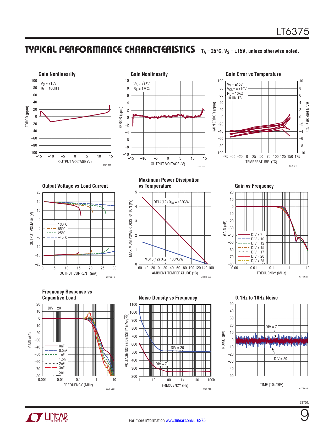

TYPICAL PERFORMANCE CHARACTERISTICS TA = 25°C, VS = ±15V, unless otherwise noted. Gain Nonlinearity
TYPICAL PERFORMANCE CHARACTERISTICS TA = 25°C, VS = ±15V, unless otherwise noted Gain Nonlinearity
LT6375
TYPICAL PERFORMANCE CHARACTERISTICS TA = 25°C, VS = ±15V, unless otherwise noted. Gain Nonlinearity Gain Nonlinearity Gain Error vs Temperature
100 10 100 10 VS = ±15V VS = ±15V VS = ±15V 80 RL = 100kΩ 8 RL = 1MΩ 80 VOUT = ±10V 8 60 6 RL = 10kΩ 60 6 10 UNITS 40 4 40 4 GAIN ERROR (m%) 20 2 20 2 0 0 0 0 –20 ERROR (ppm) –2 –20 –2 ERROR (ppm) –40 –4 GAIN ERROR (ppm) –40 –4 –60 –6 –60 –6 –80 –8 –80 –8 –100 –100 –10 –15 –10 –5 0 5 10 15 –10–15 –10 –5 0 5 10 15 –75 –50 –25 0 25 50 75 100 125 150 175 OUTPUT VOLTAGE (V) OUTPUT VOLTAGE (V) TEMPERATURE (°C) 6375 G16 6375 G18 6375 G17
Maximum Power Dissipation Output Voltage vs Load Current vs Temperature Gain vs Frequency
20 5 20 15 10 DF14(12) θJA = 43°C/W 4 0 10 ATION (W) –10 5 3 –20 TAGE (V) 130°C 0 85°C –30 25°C GAIN (dB) –40 DIV = 7 –5 –45°C 2 DIV = 10 OUTPUT VOL –50 DIV = 12 –10 1 DIV = 15 –60 DIV = 17 –15 MAXIMUM POWER DISSIP –70 DIV = 20 MS16(12) θJA = 130°C/W DIV = 25 –20 0 –80 0 5 10 15 20 25 30 –60 –40 –20 0 20 40 60 80 100 120 140 160 0.001 0.01 0.1 1 10 OUTPUT CURRENT (mA) AMBIENT TEMPERATURE (°C) FREQUENCY (MHz) 6375 G19 LT6375 G20 6375 G21
Frequency Response vs Capacitive Load Noise Density vs Frequency 0.1Hz to 10Hz Noise
