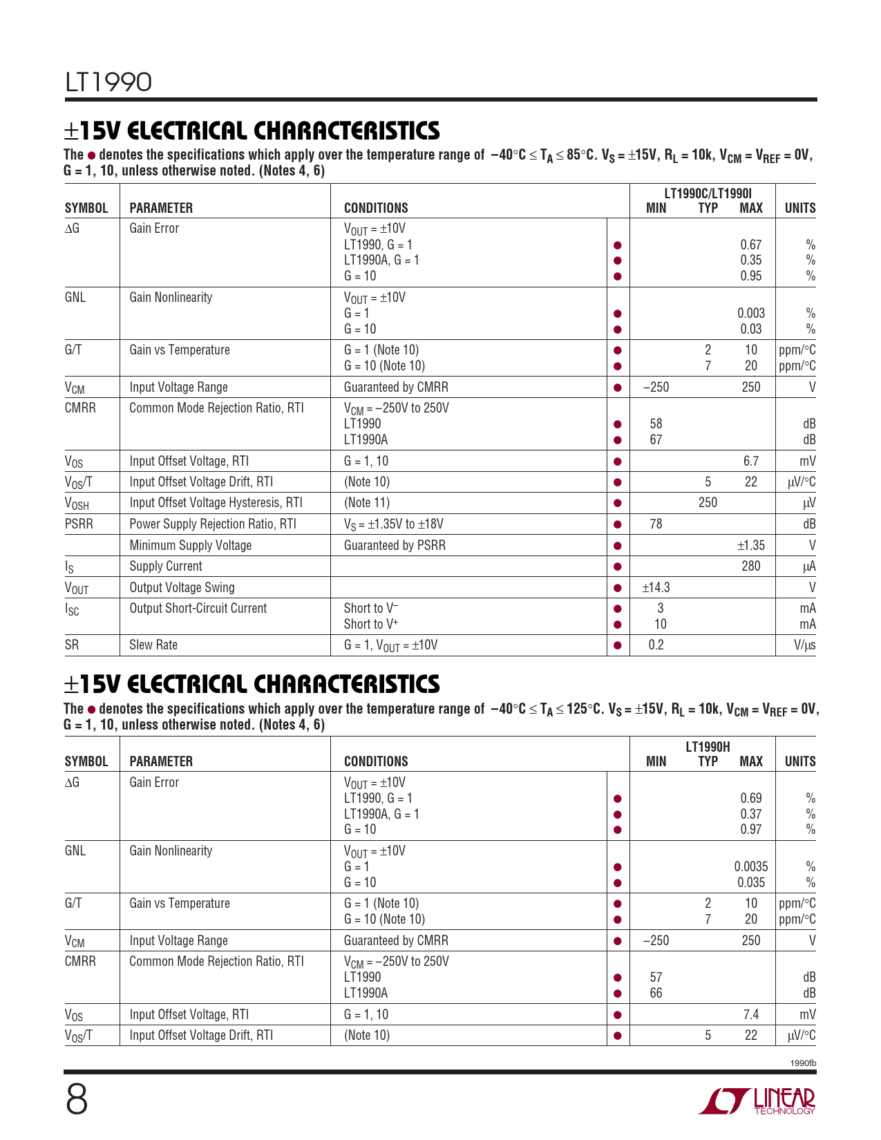

Description±250V Input Range G = 1, 10, Micropower, Difference Amplifier

15V ELECTRICAL CHARACTERISTICS. The. denotes the specifications which apply over the temperature range of –40. C. VS =
15V ELECTRICAL CHARACTERISTICS The denotes the specifications which apply over the temperature range of –40 C VS =
LT1990 ±
C
TA
85
C. VS =
15V, RL = 10k, VCM = VREF = 0V, G = 1, 10, unless otherwise noted. (Notes 4, 6) LT1990C/LT1990I SYMBOL PARAMETER CONDITIONS MIN TYP MAX UNITS
∆G Gain Error VOUT = ±10V LT1990, G = 1 ● 0.67 % LT1990A, G = 1 ● 0.35 % G = 10 ● 0.95 % GNL Gain Nonlinearity VOUT = ±10V G = 1 ● 0.003 % G = 10 ● 0.03 % G/T Gain vs Temperature G = 1 (Note 10) ● 2 10 ppm/°C G = 10 (Note 10) ● 7 20 ppm/°C VCM Input Voltage Range Guaranteed by CMRR ● –250 250 V CMRR Common Mode Rejection Ratio, RTI VCM = –250V to 250V LT1990 ● 58 dB LT1990A ● 67 dB VOS Input Offset Voltage, RTI G = 1, 10 ● 6.7 mV VOS/T Input Offset Voltage Drift, RTI (Note 10) ● 5 22 µV/°C VOSH Input Offset Voltage Hysteresis, RTI (Note 11) ● 250 µV PSRR Power Supply Rejection Ratio, RTI VS = ±1.35V to ±18V ● 78 dB Minimum Supply Voltage Guaranteed by PSRR ● ±1.35 V IS Supply Current ● 280 µA VOUT Output Voltage Swing ● ±14.3 V ISC Output Short-Circuit Current Short to V– ● 3 mA Short to V+ ● 10 mA SR Slew Rate G = 1, VOUT = ±10V ● 0.2 V/µs ±
C
TA
125
C. VS =
15V, RL = 10k, VCM = VREF = 0V, G = 1, 10, unless otherwise noted. (Notes 4, 6) LT1990H SYMBOL PARAMETER CONDITIONS MIN TYP MAX UNITS
∆G Gain Error VOUT = ±10V LT1990, G = 1 ● 0.69 % LT1990A, G = 1 ● 0.37 % G = 10 ● 0.97 % GNL Gain Nonlinearity VOUT = ±10V G = 1 ● 0.0035 % G = 10 ● 0.035 % G/T Gain vs Temperature G = 1 (Note 10) ● 2 10 ppm/°C G = 10 (Note 10) ● 7 20 ppm/°C VCM Input Voltage Range Guaranteed by CMRR ● –250 250 V CMRR Common Mode Rejection Ratio, RTI VCM = –250V to 250V LT1990 ● 57 dB LT1990A ● 66 dB VOS Input Offset Voltage, RTI G = 1, 10 ● 7.4 mV VOS/T Input Offset Voltage Drift, RTI (Note 10) ● 5 22 µV/°C 1990fb 8
