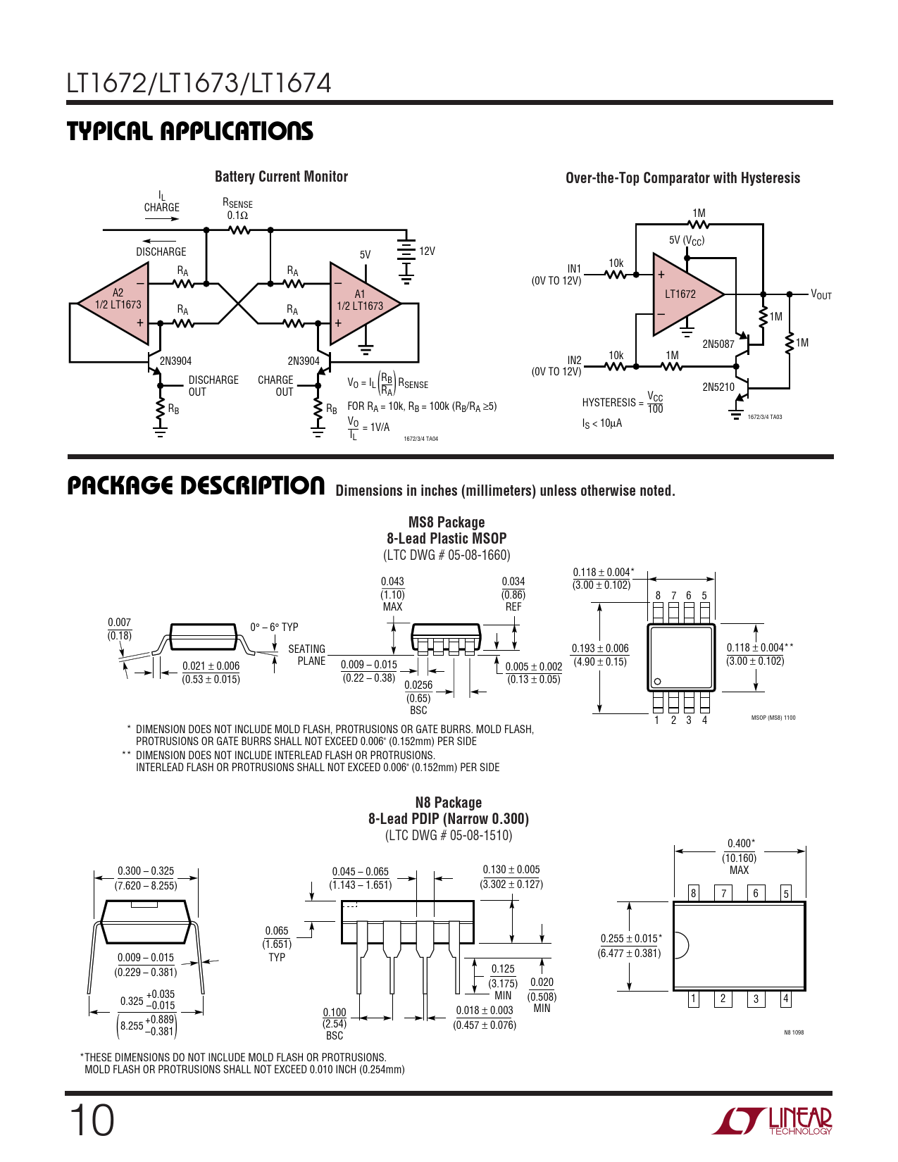

TYPICAL APPLICATIO S. Battery Current Monitor. Over-the-Top Comparator with Hysteresis. PACKAGE DESCRIPTIO
TYPICAL APPLICATIO S Battery Current Monitor Over-the-Top Comparator with Hysteresis PACKAGE DESCRIPTIO
LT1672/LT1673/LT1674
U TYPICAL APPLICATIO S Battery Current Monitor Over-the-Top Comparator with Hysteresis
IL RSENSE CHARGE 0.1Ω 1M 5V (VCC) DISCHARGE 5V 12V 10k – R R A A IN1 + – (0V TO 12V) A2 A1 LT1672 VOUT 1/2 LT1673 1/2 LT1673 + RA RA – + 1M 2N5087 1M 10k 1M 2N3904 2N3904 IN2 (0V TO 12V) DISCHARGE CHARGE R V B ( ) O = IL RSENSE 2N5210 OUT OUT RA VCC FOR R HYSTERESIS = R R A = 10k, RB = 100k (RB/RA ≥5) B B 100 V 1672/3/4 TA03 O = 1V/A IS < 10µA IL 1672/3/4 TA04
U PACKAGE DESCRIPTIO Dimensions in inches (millimeters) unless otherwise noted. MS8 Package 8-Lead Plastic MSOP
(LTC DWG # 05-08-1660) 0.118 ± 0.004* 0.043 0.034 (3.00 ± 0.102) (1.10) (0.86) 8 7 6 5 MAX REF 0.007 0° – 6° TYP (0.18) SEATING 0.193 ± 0.006 0.118 ± 0.004** PLANE (3.00 ± 0.102) 0.021 ± 0.006 0.009 – 0.015 0.005 ± 0.002 (4.90 ± 0.15) (0.53 ± 0.015) (0.22 – 0.38) (0.13 ± 0.05) 0.0256 (0.65) BSC MSOP (MS8) 1100 1 2 3 4 * DIMENSION DOES NOT INCLUDE MOLD FLASH, PROTRUSIONS OR GATE BURRS. MOLD FLASH, PROTRUSIONS OR GATE BURRS SHALL NOT EXCEED 0.006" (0.152mm) PER SIDE ** DIMENSION DOES NOT INCLUDE INTERLEAD FLASH OR PROTRUSIONS. INTERLEAD FLASH OR PROTRUSIONS SHALL NOT EXCEED 0.006" (0.152mm) PER SIDE
