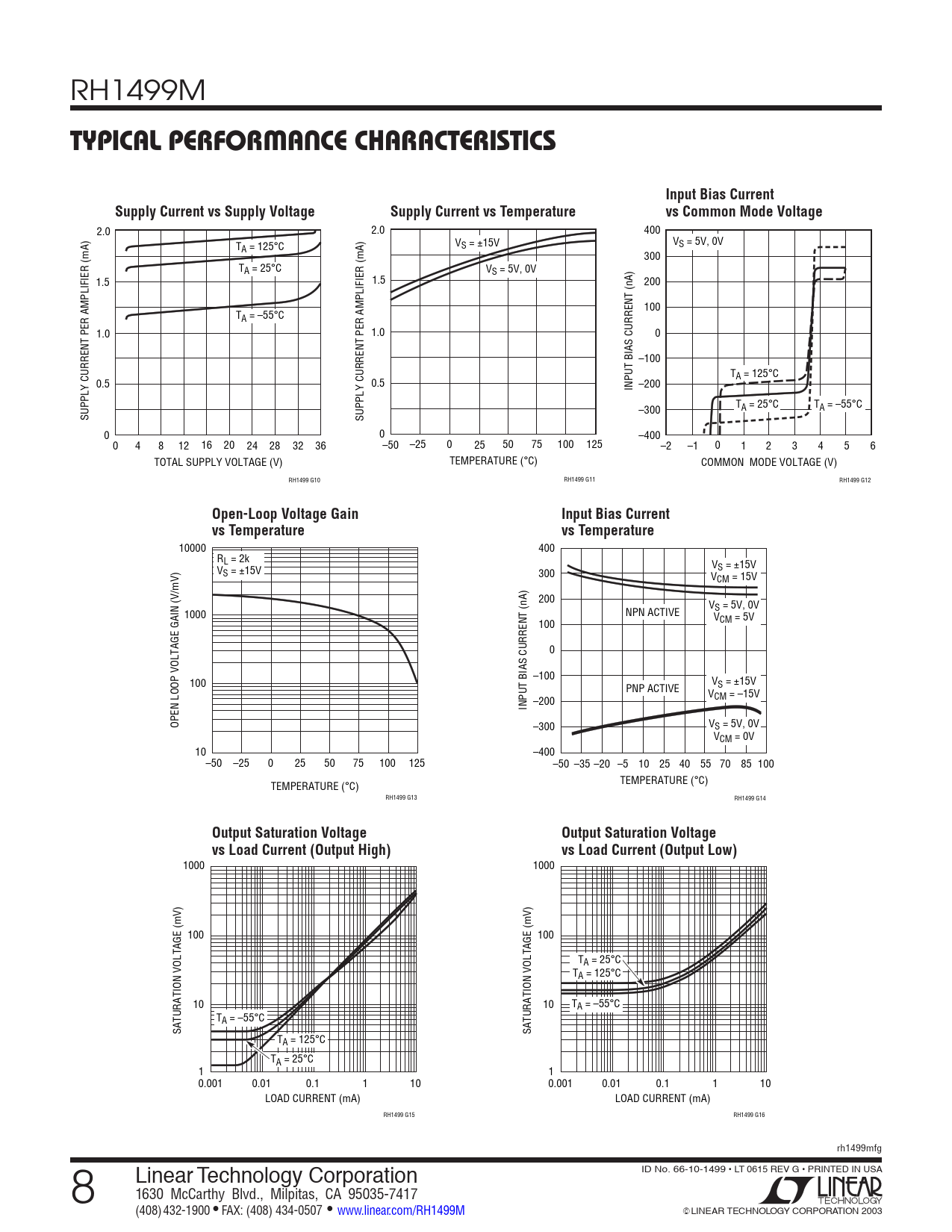

TYPICAL PERFORMANCE CHARACTERISTICS. Input Bias Current. Supply Current vs Supply Voltage. Supply Current vs Temperature
RH1499M
TYPICAL PERFORMANCE CHARACTERISTICS Input Bias Current Supply Current vs Supply Voltage Supply Current vs Temperature vs Common Mode Voltage
2.0 2.0 400 T V V A = 125°C S = ±15V S = 5V, 0V 300 TA = 25°C VS = 5V, 0V 1.5 1.5 200 100 TA = –55°C 1.0 1.0 0 –100 TA = 125°C 0.5 0.5 INPUT BIAS CURRENT (nA) –200 –300 TA = 25°C TA = –55°C SUPPLY CURRENT PER AMPLIFIER (mA) SUPPLY CURRENT PER AMPLIFIER (mA) 0 0 –400 0 4 8 12 16 20 24 28 32 36 –50 –25 0 25 50 75 100 125 –2 –1 0 1 2 3 4 5 6 TOTAL SUPPLY VOLTAGE (V) TEMPERATURE (°C) COMMON MODE VOLTAGE (V) RH1499 G10 RH1499 G11 RH1499 G12
Open-Loop Voltage Gain Input Bias Current vs Temperature vs Temperature
10000 400 RL = 2k V VS = ±15V S = ±15V 300 VCM = 15V 200 VS = 5V, 0V 1000 NPN ACTIVE V 100 CM = 5V 0 –100 100 VS = ±15V PNP ACTIVE VCM = –15V INPUT BIAS CURRENT (nA) –200 OPEN LOOP VOLTAGE GAIN (V/mV) –300 VS = 5V, 0V VCM = 0V 10 –400 –50 –25 0 25 50 75 100 125 –50 –35 –20 –5 10 25 40 55 70 85 100 TEMPERATURE (°C) TEMPERATURE (°C) RH1499 G13 RH1499 G14
Output Saturation Voltage Output Saturation Voltage vs Load Current (Output High) vs Load Current (Output Low)
1000 1000 100 100 TA = 25°C TA = 125°C 10 10 TA = –55°C TA = –55°C SATURATION VOLTAGE (mV) SATURATION VOLTAGE (mV) TA = 125°C TA = 25°C 1 1 0.001 0.01 0.1 1 10 0.001 0.01 0.1 1 10 LOAD CURRENT (mA) LOAD CURRENT (mA) RH1499 G15 RH1499 G16 rh1499mfg 8 ID No. 66-10-1499 • LT 0615 REV G • PRINTED IN USA Linear Technology Corporation 1630 McCarthy Blvd., Milpitas, CA 9 F5o0r 3m5o-r7e 4inf 17ormation www.linear.com/RH1499M (408) 432-1900 ● FAX: (408) 434-0507 ● www.linear.com/RH1499M LINEAR TECHNOLOGY CORPORATION 2003 Document Outline Description Absolute Maximum Ratings Burn-In Circuit Package Information Table 1: Electrical Characteristics Table 1A: Electrical Characteristics Table 2: Electrical Characteristics Table 2A: Electrical Characteristics Table 2: Electrical Test Requirements Total Dose Bias Circuit Typical Performance Characteristics
