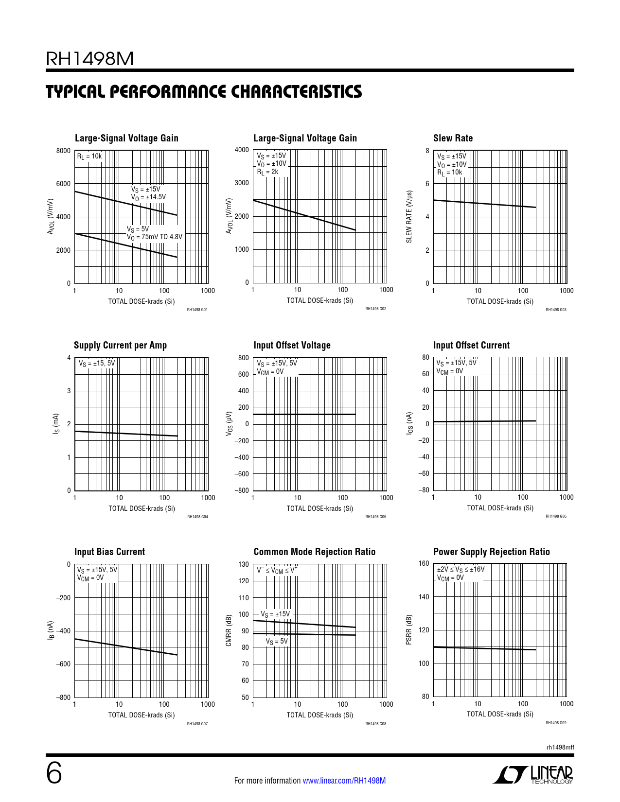

TYPICAL PERFORMANCE CHARACTERISTICS. Large-Signal Voltage Gain. Slew Rate. Supply Current per Amp. Input Offset Voltage
TYPICAL PERFORMANCE CHARACTERISTICS Large-Signal Voltage Gain Slew Rate Supply Current per Amp Input Offset Voltage
RH1498M
TYPICAL PERFORMANCE CHARACTERISTICS Large-Signal Voltage Gain Large-Signal Voltage Gain Slew Rate
8000 4000 8 RL = 10k VS = ±15V VS = ±15V VO = ±10V VO = ±10V RL = 2k RL = 10k 6000 3000 6 VS = ±15V VO = ±14.5V (V/mV) 4000 (V/mV) 2000 4 A VOL VS = 5V A VOL VO = 75mV TO 4.8V SLEW RATE (V/µs) 2000 1000 2 0 0 0 1 10 100 1000 1 10 100 1000 1 10 100 1000 TOTAL DOSE-krads (Si) TOTAL DOSE-krads (Si) TOTAL DOSE-krads (Si) RH1498 G01 RH1498 G02 RH1498 G03
Supply Current per Amp Input Offset Voltage Input Offset Current
4 800 80 VS = ±15, 5V VS = ±15V, 5V VS = ±15V, 5V 600 VCM = 0V 60 VCM = 0V 3 400 40 200 20 (mA) 2 (µV) 0 (nA) 0 I S V OS I OS –200 –20 1 –400 –40 –600 –60 0 –800 –80 1 10 100 1000 1 10 100 1000 1 10 100 1000 TOTAL DOSE-krads (Si) TOTAL DOSE-krads (Si) TOTAL DOSE-krads (Si) RH1498 G04 RH1498 G05 RH1498 G06
Input Bias Current Common Mode Rejection Ratio Power Supply Rejection Ratio
0 130 160 VS = ±15V, 5V V– ≤ VCM ≤ V+ ±2V ≤ VS ≤ ±16V VCM = 0V 120 VCM = 0V –200 110 140 100 VS = ±15V (nA) –400 90 120 I B CMRR (dB) VS = 5V PSRR (dB) 80 –600 70 100 60 –800 50 80 1 10 100 1000 1 10 100 1000 1 10 100 1000 TOTAL DOSE-krads (Si) TOTAL DOSE-krads (Si) TOTAL DOSE-krads (Si) RH1498 G07 RH1498 G08 RH1498 G09 rh1498mff 6 For more information www.linear.com/RH1498M Document Outline Description Absolute Maximum Ratings Burn-In Circuit Package Information Table 1: Electrical Characteristics Table 1A: Electrical Characteristics Table 2: Electrical Characteristics Table 2A: Electrical Characteristics TYPICAL PERFORMANCE CHARACTERISTICS
