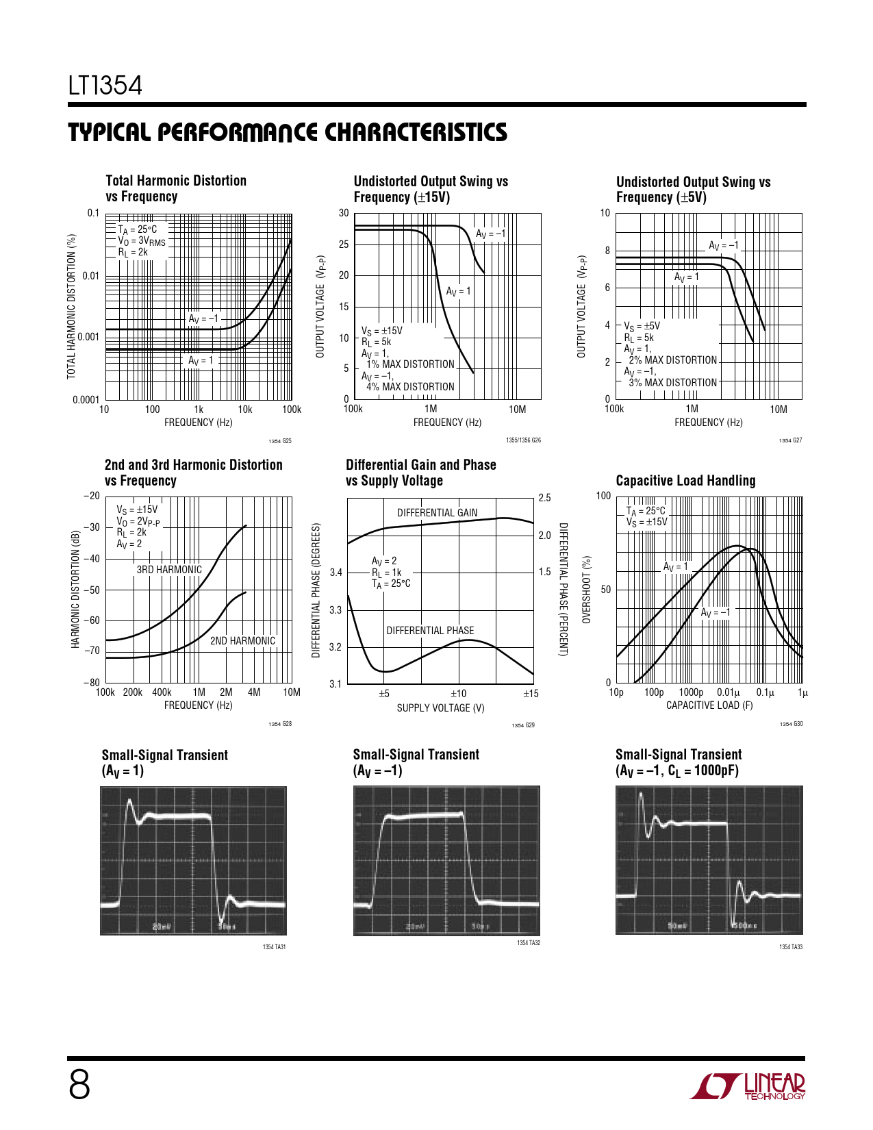

TYPICAL PERFORMANCE CHARACTERISTICS. Total Harmonic Distortion. Undistorted Output Swing vs. vs Frequency. Frequency (. 15V). 5V)
LT1354
W U TYPICAL PERFORMANCE CHARACTERISTICS Total Harmonic Distortion Undistorted Output Swing vs Undistorted Output Swing vs vs Frequency Frequency (
15V) Frequency (
5V)
0.1 30 10 TA = 25°C AV = –1 VO = 3VRMS 25 AV = –1 RL = 2k ) 8 P-P P-P 0.01 20 AV = 1 6 AV = 1 15 AV = –1 4 VS = ±5V VS = ±15V 0.001 10 RL = 5k RL = 5k A OUTPUT VOLTAGE (V AV = 1, OUTPUT VOLTAGE (V V = 1, AV = 1 2 2% MAX DISTORTION 5 1% MAX DISTORTION AV = –1, TOTAL HARMONIC DISTORTION (%) AV = –1, 3% MAX DISTORTION 4% MAX DISTORTION 0.0001 0 0 10 100 1k 10k 100k 100k 1M 10M 100k 1M 10M FREQUENCY (Hz) FREQUENCY (Hz) FREQUENCY (Hz) 1354 G25 1355/1356 G26 1354 G27
2nd and 3rd Harmonic Distortion Differential Gain and Phase vs Frequency vs Supply Voltage Capacitive Load Handling
– 20 2.5 100 VS = ±15V T DIFFERENTIAL GAIN A = 25°C V DIFFERENTIAL PHASE (PERCENT) O = 2VP-P VS = ±15V – 30 RL = 2k 2.0 AV = 2 – 40 AV = 2 A 3RD HARMONIC V = 1 3.4 R 1.5 L = 1k T – 50 A = 25°C 50 3.3 AV = –1 – 60 OVERSHOOT (%) DIFFERENTIAL PHASE HARMONIC DISTORTION (dB) 2ND HARMONIC –70 3.2 DIFFERENTIAL PHASE (DEGREES) – 80 3.1 0 100k 200k 400k 1M 2M 4M 10M ±5 ±10 ±15 10p 100p 1000p 0.01µ 0.1µ 1µ FREQUENCY (Hz) CAPACITIVE LOAD (F) SUPPLY VOLTAGE (V) 1354 G28 1354 G30 1354 G29
Small-Signal Transient Small-Signal Transient Small-Signal Transient (AV = 1) (A (A V = –1) V = –1, CL = 1000pF)
1354 TA32 1354 TA31 1354 TA33 8
