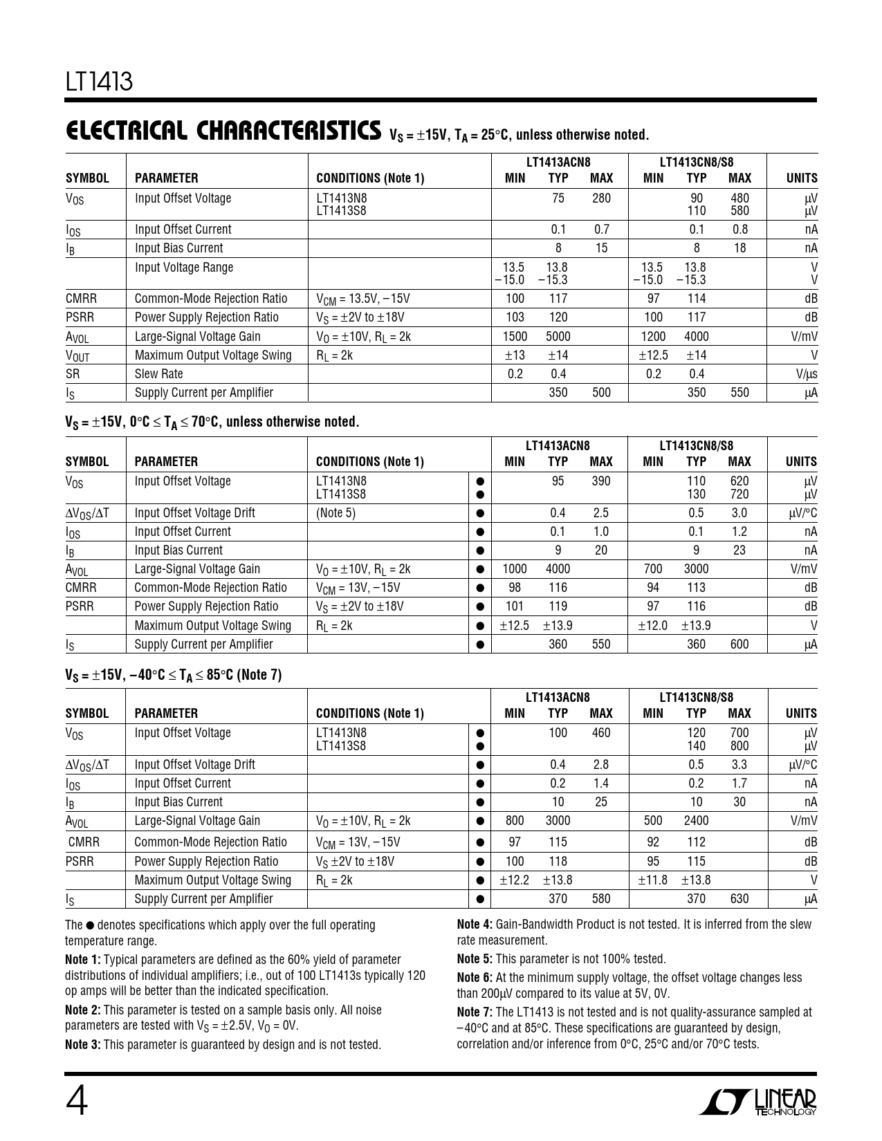

ELECTRICAL CHAR C. A TERISTICS VS =. 15V, TA = 25. C, unless otherwise noted. LT1413ACN8. LT1413CN8/S8. SYMBOL. PARAMETER
ELECTRICAL CHAR C A TERISTICS VS = 15V, TA = 25 C, unless otherwise noted LT1413ACN8 LT1413CN8/S8 SYMBOL PARAMETER
LT1413
15V, TA = 25
C, unless otherwise noted. LT1413ACN8 LT1413CN8/S8 SYMBOL PARAMETER CONDITIONS (Note 1) MIN TYP MAX MIN TYP MAX UNITS
VOS Input Offset Voltage LT1413N8 75 280 90 480 µV LT1413S8 110 580 µV IOS Input Offset Current 0.1 0.7 0.1 0.8 nA IB Input Bias Current 8 15 8 18 nA Input Voltage Range 13.5 13.8 13.5 13.8 V – 15.0 – 15.3 – 15.0 – 15.3 V CMRR Common-Mode Rejection Ratio VCM = 13.5V, – 15V 100 117 97 114 dB PSRR Power Supply Rejection Ratio VS = ±2V to ±18V 103 120 100 117 dB AVOL Large-Signal Voltage Gain VO = ±10V, RL = 2k 1500 5000 1200 4000 V/mV VOUT Maximum Output Voltage Swing RL = 2k ±13 ±14 ±12.5 ±14 V SR Slew Rate 0.2 0.4 0.2 0.4 V/µs IS Supply Current per Amplifier 350 500 350 550 µA
VS =
15V, 0
C
TA
70
VOS Input Offset Voltage LT1413N8 ● 95 390 110 620 µV LT1413S8 ● 130 720 µV ∆VOS/∆T Input Offset Voltage Drift (Note 5) ● 0.4 2.5 0.5 3.0 µV/°C IOS Input Offset Current ● 0.1 1.0 0.1 1.2 nA IB Input Bias Current ● 9 20 9 23 nA AVOL Large-Signal Voltage Gain VO = ±10V, RL = 2k ● 1000 4000 700 3000 V/mV CMRR Common-Mode Rejection Ratio VCM = 13V, – 15V ● 98 116 94 113 dB PSRR Power Supply Rejection Ratio VS = ±2V to ±18V ● 101 119 97 116 dB Maximum Output Voltage Swing RL = 2k ● ±12.5 ±13.9 ±12.0 ±13.9 V IS Supply Current per Amplifier ● 360 550 360 600 µA
VS =
15V, –40
C
TA
85
C (Note 7) LT1413ACN8 LT1413CN8/S8 SYMBOL PARAMETER CONDITIONS (Note 1) MIN TYP MAX MIN TYP MAX UNITS
VOS Input Offset Voltage LT1413N8 ● 100 460 120 700 µV LT1413S8 ● 140 800 µV ∆VOS/∆T Input Offset Voltage Drift ● 0.4 2.8 0.5 3.3 µV/°C IOS Input Offset Current ● 0.2 1.4 0.2 1.7 nA IB Input Bias Current ● 10 25 10 30 nA AVOL Large-Signal Voltage Gain VO = ±10V, RL = 2k ● 800 3000 500 2400 V/mV CMRR Common-Mode Rejection Ratio VCM = 13V, – 15V ● 97 115 92 112 dB PSRR Power Supply Rejection Ratio VS ±2V to ±18V ● 100 118 95 115 dB Maximum Output Voltage Swing RL = 2k ● ±12.2 ±13.8 ±11.8 ±13.8 V IS Supply Current per Amplifier ● 370 580 370 630 µA The ● denotes specifications which apply over the full operating
Note 4:
Gain-Bandwidth Product is not tested. It is inferred from the slew temperature range. rate measurement.
Note 1:
Typical parameters are defined as the 60% yield of parameter
Note 5:
This parameter is not 100% tested. distributions of individual amplifiers; i.e., out of 100 LT1413s typically 120
Note 6:
At the minimum supply voltage, the offset voltage changes less op amps will be better than the indicated specification. than 200µV compared to its value at 5V, 0V.
Note 2:
This parameter is tested on a sample basis only. All noise
Note 7:
The LT1413 is not tested and is not quality-assurance sampled at parameters are tested with VS = ±2.5V, VO = 0V. – 40°C and at 85°C. These specifications are guaranteed by design,
Note 3:
This parameter is guaranteed by design and is not tested. correlation and/or inference from 0°C, 25°C and/or 70°C tests. 4
