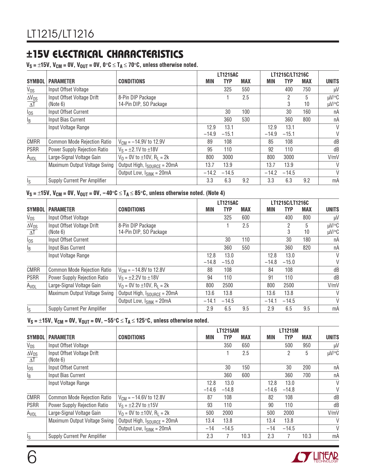

–15V ELECTRICAL CH. ARA TERISTICS. VS =. 15V, VCM = 0V, VOUT = 0V, 0. C, unless otherwise noted. LT1215AC. LT1215C/LT1216C
–15V ELECTRICAL CH ARA TERISTICS VS = 15V, VCM = 0V, VOUT = 0V, 0 C, unless otherwise noted LT1215AC LT1215C/LT1216C
LT1215/LT1216
+ –15V ELECTRICAL CH C ARA TERISTICS VS =
C
TA
70
C, unless otherwise noted. LT1215AC LT1215C/LT1216C SYMBOL PARAMETER CONDITIONS MIN TYP MAX MIN TYP MAX UNITS
VOS Input Offset Voltage 325 550 400 750 µV ∆VOS Input Offset Voltage Drift 8-Pin DIP Package 1 2.5 2 5 µV/°C ∆T (Note 6) 14-Pin DIP, SO Package 3 10 µV/°C IOS Input Offset Current 30 100 30 160 nA IB Input Bias Current 360 530 360 800 nA Input Voltage Range 12.9 13.1 12.9 13.1 V –14.9 –15.1 –14.9 –15.1 V CMRR Common Mode Rejection Ratio VCM = –14.9V to 12.9V 89 108 85 108 dB PSRR Power Supply Rejection Ratio VS = ±2.1V to ±18V 95 110 92 110 dB AVOL Large-Signal Voltage Gain VO = 0V to ±10V, RL = 2k 800 3000 800 3000 V/mV Maximum Output Voltage Swing Output High, ISOURCE = 20mA 13.7 13.9 13.7 13.9 V Output Low, ISINK = 20mA – 14.2 – 14.5 – 14.2 – 14.5 V IS Supply Current Per Amplifier 3.3 6.3 9.2 3.3 6.3 9.2 mA
VS =
15V, VCM = 0V, VOUT = 0V, – 40
C
TA
85
C, unless otherwise noted. (Note 4) LT1215AC LT1215C/LT1216C SYMBOL PARAMETER CONDITIONS MIN TYP MAX MIN TYP MAX UNITS
VOS Input Offset Voltage 325 600 400 800 µV ∆VOS Input Offset Voltage Drift 8-Pin DIP Package 1 2.5 2 5 µV/°C ∆T (Note 6) 14-Pin DIP, SO Package 3 10 µV/°C IOS Input Offset Current 30 110 30 180 nA IB Input Bias Current 360 550 360 820 nA Input Voltage Range 12.8 13.0 12.8 13.0 V –14.8 –15.0 –14.8 –15.0 V CMRR Common Mode Rejection Ratio VCM = – 14.8V to 12.8V 88 108 84 108 dB PSRR Power Supply Rejection Ratio VS = ±2.2V to ±18V 94 110 91 110 dB AVOL Large-Signal Voltage Gain VO = 0V to ±10V, RL = 2k 800 2500 800 2500 V/mV Maximum Output Voltage Swing Output High, ISOURCE = 20mA 13.6 13.8 13.6 13.8 V Output Low, ISINK = 20mA – 14.1 – 14.5 – 14.1 – 14.5 V IS Supply Current Per Amplifier 2.9 6.5 9.5 2.9 6.5 9.5 mA
VS =
15V, VCM = 0V, VOUT = 0V, – 55
C
TA
125
C, unless otherwise noted. LT1215AM LT1215M SYMBOL PARAMETER CONDITIONS MIN TYP MAX MIN TYP MAX UNITS
VOS Input Offset Voltage 350 650 500 950 µV ∆VOS Input Offset Voltage Drift 1 2.5 2 5 µV/°C ∆T (Note 6) IOS Input Offset Current 30 150 30 200 nA IB Input Bias Current 360 600 360 700 nA Input Voltage Range 12.8 13.0 12.8 13.0 V –14.6 –14.8 –14.6 –14.8 V CMRR Common Mode Rejection Ratio VCM = – 14.6V to 12.8V 87 108 82 108 dB PSRR Power Supply Rejection Ratio VS = ±2.2V to ±15V 93 110 90 110 dB AVOL Large-Signal Voltage Gain VO = 0V to ±10V, RL = 2k 500 2000 500 2000 V/mV Maximum Output Voltage Swing Output High, ISOURCE = 20mA 13.4 13.8 13.4 13.8 V Output Low, ISINK = 20mA –14 –14.5 –14 –14.5 V IS Supply Current Per Amplifier 2.3 7 10.3 2.3 7 10.3 mA 6
