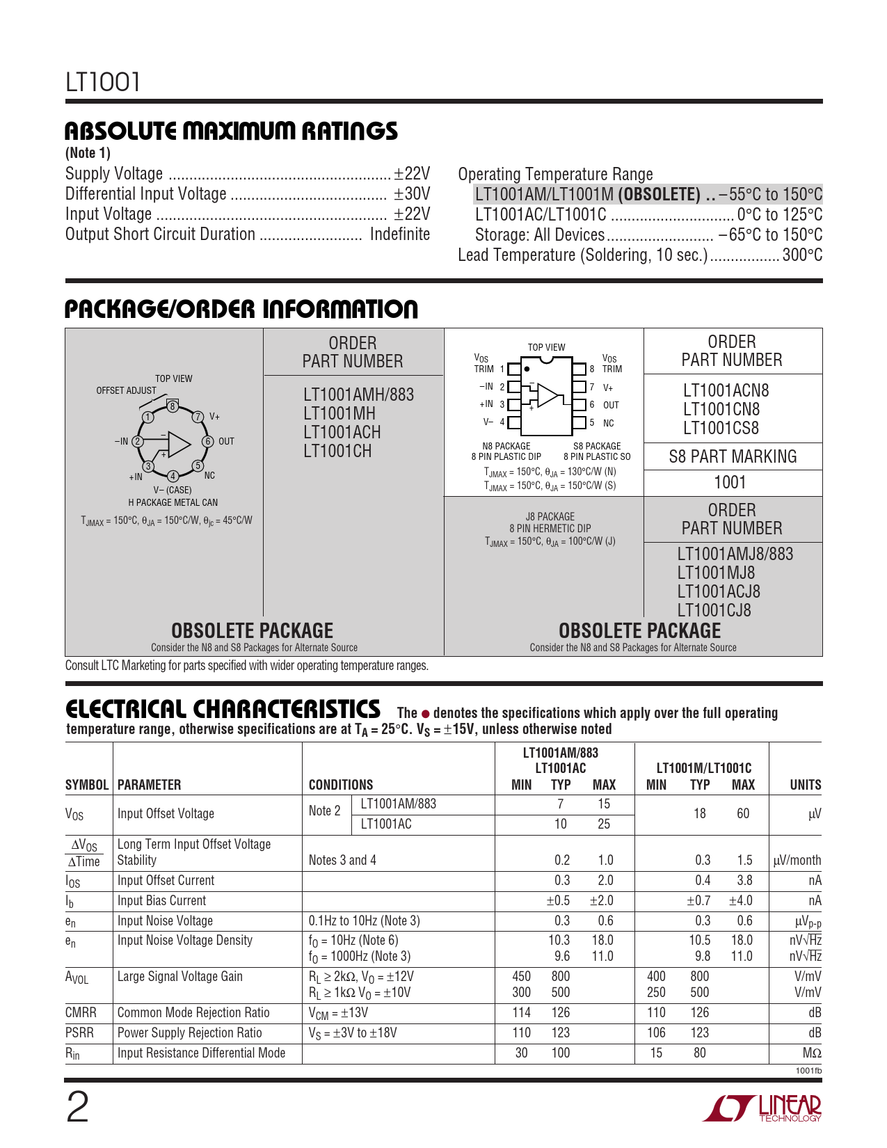

W W W U ABSOLUTE MAXIMUM RATINGS (Note 1)
Supply Voltage .. ±22V Operating Temperature Range Differential Input Voltage .. ±30V LT1001AM/LT1001M
(OBSOLETE) ..
– 55°C to 150°C Input Voltage .. ±22V LT1001AC/LT1001C .. 0°C to 125°C Output Short Circuit Duration ... Indefinite Storage: All Devices.. – 65°C to 150°C Lead Temperature (Soldering, 10 sec.)... 300°C
U W U PACKAGE/ORDER INFORMATION
ORDER ORDER TOP VIEW PART NUMBER VOS VOS PART NUMBER TRIM 1 8 TRIM TOP VIEW – OFFSET ADJUST –IN LT1001AMH/883 2 7 V+ LT1001ACN8 8 +IN 3 6 OUT + 1 7 V+ LT1001MH LT1001CN8 V– 4 5 NC – LT1001ACH LT1001CS8 –IN 2 6 OUT N8 PACKAGE S8 PACKAGE + LT1001CH 8 PIN PLASTIC DIP 8 PIN PLASTIC SO S8 PART MARKING 3 5 T +IN 4 NC JMAX = 150°C, θJA = 130°C/W (N) TJMAX = 150°C, θJA = 150°C/W (S) 1001 V– (CASE) H PACKAGE METAL CAN ORDER J8 PACKAGE TJMAX = 150°C, θJA = 150°C/W, θjc = 45°C/W 8 PIN HERMETIC DIP PART NUMBER TJMAX = 150°C, θJA = 100°C/W (J) LT1001AMJ8/883 LT1001MJ8 LT1001ACJ8 LT1001CJ8
OBSOLETE PACKAGE OBSOLETE PACKAGE
Consider the N8 and S8 Packages for Alternate Source Consider the N8 and S8 Packages for Alternate Source Consult LTC Marketing for parts specified with wider operating temperature ranges.
C. VS =
15V, unless otherwise noted LT1001AM/883 LT1001AC LT1001M/LT1001C SYMBOL PARAMETER CONDITIONS MIN TYP MAX MIN TYP MAX UNITS
LT1001AM/883 7 15 VOS Input Offset Voltage Note 2 18 60 µV LT1001AC 10 25 ∆VOS Long Term Input Offset Voltage ∆Time Stability Notes 3 and 4 0.2 1.0 0.3 1.5 µV/month IOS Input Offset Current 0.3 2.0 0.4 3.8 nA Ib Input Bias Current ±0.5 ±2.0 ±0.7 ±4.0 nA en Input Noise Voltage 0.1Hz to 10Hz (Note 3) 0.3 0.6 0.3 0.6 µVp-p en Input Noise Voltage Density fO = 10Hz (Note 6) 10.3 18.0 10.5 18.0 nV√Hz fO = 1000Hz (Note 3) 9.6 11.0 9.8 11.0 nV√Hz AVOL Large Signal Voltage Gain RL ≥ 2kΩ, VO = ±12V 450 800 400 800 V/mV RL ≥ 1kΩ VO = ±10V 300 500 250 500 V/mV CMRR Common Mode Rejection Ratio VCM = ±13V 114 126 110 126 dB PSRR Power Supply Rejection Ratio VS = ±3V to ±18V 110 123 106 123 dB Rin Input Resistance Differential Mode 30 100 15 80 MΩ 1001fb 2
