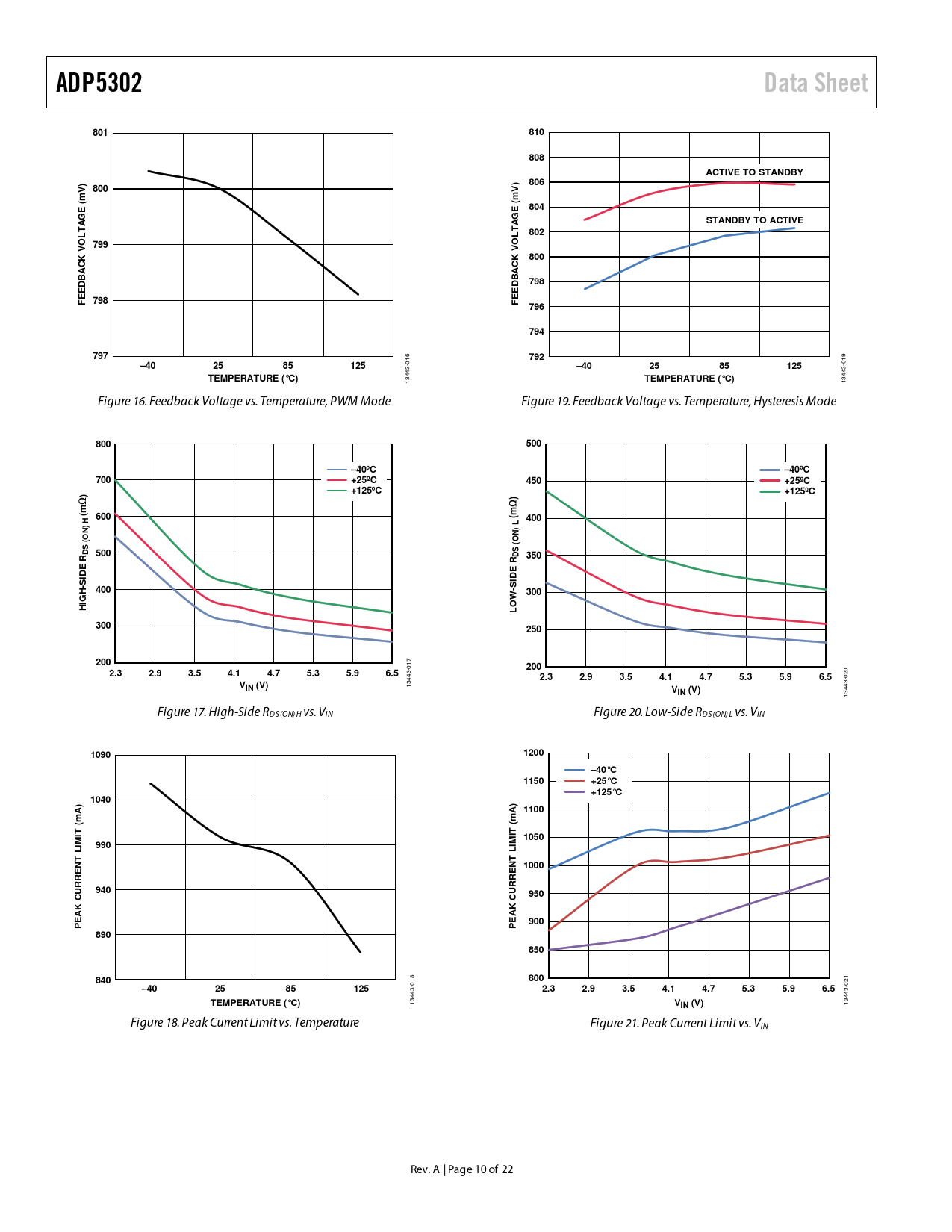

ADP5302. Data Sheet. 801. 810. 808. ACTIVE TO STANDBY. 806. 800. 804. STANDBY TO ACTIVE. 802. O 799. DBACK V. 798. F 798. 796. 794. 797. 792. –40. 125

13443- Figure 16. Feedback Voltage vs. Temperature, PWM Mode Figure 19. Feedback Voltage vs. Temperature, Hysteresis Mode

13443- Figure 17. High-Side RDS (ON) H vs. VIN Figure 20. Low-Side RDS (ON) L vs. VIN

Figure 18. Peak Current Limit vs. Temperature Figure 21. Peak Current Limit vs. VIN Rev. A | Page 10 of 22 Document Outline FEATURES APPLICATIONS TYPICAL APPLICATION CIRCUIT GENERAL DESCRIPTION REVISION HISTORY DETAILED FUNCTIONAL BLOCK DIAGRAM SPECIFICATIONS ABSOLUTE MAXIMUM RATINGS THERMAL RESISTANCE ESD CAUTION PIN CONFIGURATION AND FUNCTION DESCRIPTIONS TYPICAL PERFORMANCE CHARACTERISTICS THEORY OF OPERATION BUCK REGULATOR OPERATIONAL MODES PWM Mode Hysteresis Mode Mode Selection OSCILLATOR AND SYNCHRONIZATION ADJUSTABLE AND FIXED OUTPUT VOLTAGES UNDERVOLTAGE LOCKOUT (UVLO) ENABLE/DISABLE CURRENT LIMIT SHORT-CIRCUIT PROTECTION SOFT START STARTUP WITH PRECHARGED OUTPUT 100% DUTY OPERATION ACTIVE DISCHARGE VINOK FUNCTION STOP SWITCHING THERMAL SHUTDOWN APPLICATIONS INFORMATION EXTERNAL COMPONENT SELECTION SELECTING THE INDUCTOR OUTPUT CAPACITOR INPUT CAPACITOR EFFICIENCY Power Switch Conduction Losses Inductor Losses Driver Losses Transition Losses PRINTED CIRCUIT BOARD LAYOUT RECOMMENDATIONS TYPICAL APPLICATION CIRCUITS FACTORY PROGRAMMABLE OPTIONS OUTLINE DIMENSIONS ORDERING GUIDE
