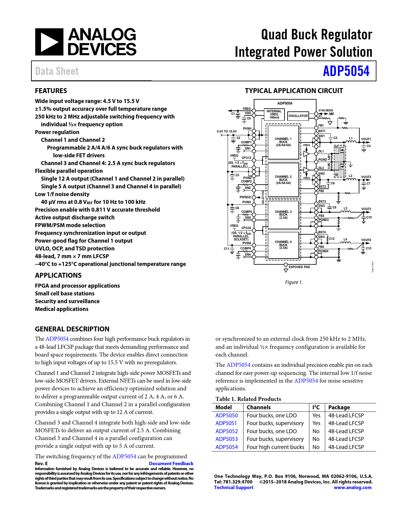

Quad Buck Regulator Integrated Power Solution Data Sheet ADP5054 FEATURES TYPICAL APPLICATION CIRCUIT Wide input voltage range: 4.5 V to 15.5 V ADP5054 ±1.5% output accuracy over full temperature range VREG INTERNAL SYNC/MODE C1 VDD 250 kHz to 2 MHz adjustable switching frequency with VREG OSCILLATOR 100mA RT C0 individual ½× frequency option FB1 PVIN1 Power regulation 4.5V TO 15.5V BST1 SW1 Channel 1 and Channel 2 C2 C3 L1 CHANNEL 1 VOUT1 COMP1 BUCK (2A/4A/6A) VREG Programmable 2 A/4 A/6 A sync buck regulators with Q1 C4 EN1 DL1 low-side FET drivers 1 VREG IM CFG12 PGND IL Channel 3 and Channel 4: 2.5 A sync buck regulators (SS, 1/2 × f 2 SW, IM PARALLEL) DL2 IL Flexible parallel operation SW2 Q2 C5 L2 Single 12 A output (Channel 1 and Channel 2 in parallel) PVIN2 CHANNEL 2 VOUT2 VREG BUCK COMP2 (2A/4A/6A) C6 C7 Single 5 A output (Channel 3 and Channel 4 in parallel) BST2 EN2 FB2 Low 1/f noise density IVE T PWRGD EC 40 μV rms at 0.8 V L REF for 10 Hz to 100 kHz E BST3 PVIN3 S SW3 Precision enable with 0.811 V accurate threshold C8 C9 L3 VOUT3 COMP3 CHANNEL 3 BUCK Active output discharge switch FB3 EN3 (2.5A) C10 PGND3 FPWM/PSM mode selection VREG CFG34 Frequency synchronization input or output (SS, 1/2 × f BST4 SW, PARALLEL, SW4 Power-good flag for Channel 1 output SCLKSET) C12 L4 VOUT4 PVIN4 CHANNEL 4 BUCK UVLO, OCP, and TSD protection FB4 C11 COMP4 (2.5A) C13 PGND4 48-lead, 7 mm × 7 mm LFCSP EN4 −40°C to +125°C operational junctional temperature range

Figure 1.

The ADP5054 combines four high performance buck regulators in or synchronized to an external clock from 250 kHz to 2 MHz, a 48-lead LFCSP package that meets demanding performance and and an individual ½× frequency configuration is available for board space requirements. The device enables direct connection each channel. to high input voltages of up to 15.5 V with no preregulators. The ADP5054 contains an individual precision enable pin on each Channel 1 and Channel 2 integrate high-side power MOSFETs and channel for easy power-up sequencing. The internal low 1/f noise low-side MOSFET drivers. External NFETs can be used in low-side reference is implemented in the ADP5054 for noise sensitive power devices to achieve an efficiency optimized solution and applications. to deliver a programmable output current of 2 A, 4 A, or 6 A.
Table 1. Related Products
Combining Channel 1 and Channel 2 in a parallel configuration
Model Channels I2C Package
provides a single output with up to 12 A of current. ADP5050 Four bucks, one LDO Yes 48-Lead LFCSP Channel 3 and Channel 4 integrate both high-side and low-side ADP5051 Four bucks, supervisory Yes 48-Lead LFCSP MOSFETs to deliver an output current of 2.5 A. Combining ADP5052 Four bucks, one LDO No 48-Lead LFCSP Channel 3 and Channel 4 in a parallel configuration can ADP5053 Four bucks, supervisory No 48-Lead LFCSP provide a single output with up to 5 A of current. ADP5054 Four high current bucks No 48-Lead LFCSP The switching frequency of the ADP5054 can be programmed
