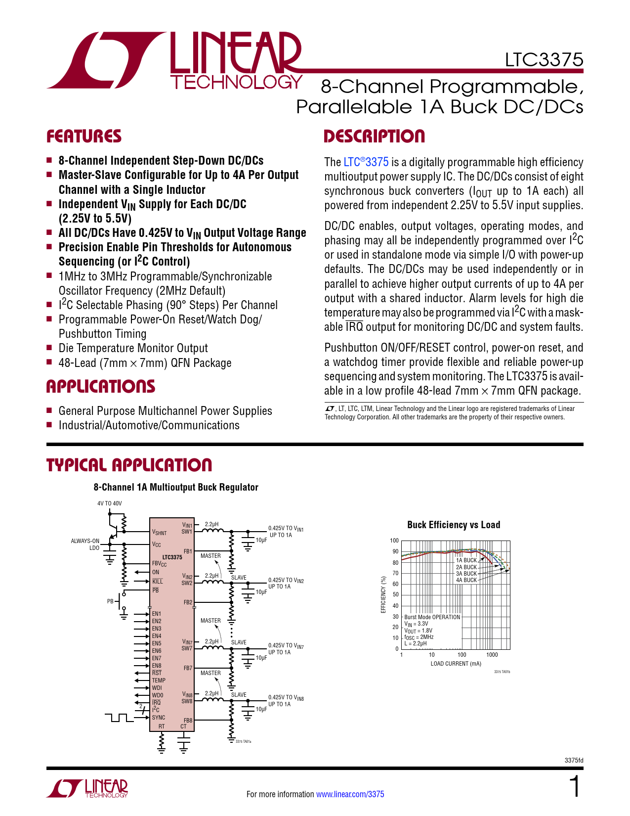

Description8-Channel Programmable, Parallelable 1A Buck DC/DCs

The LTC®3375 is a digitally programmable high efficiency n
Master-Slave Configurable for Up to 4A Per Output
multioutput power supply IC. The DC/DCs consist of eight
Channel with a Single Inductor
synchronous buck converters (IOUT up to 1A each) all n
Independent VIN Supply for Each DC/DC
powered from independent 2.25V to 5.5V input supplies.
(2.25V to 5.5V)
DC/DC enables, output voltages, operating modes, and n
All DC/DCs Have 0.425V to VIN Output Voltage Range
phasing may all be independently programmed over I2C n
Precision Enable Pin Thresholds for Autonomous
or used in standalone mode via simple I/O with power-up
Sequencing (or I2C Control)
defaults. The DC/DCs may be used independently or in n 1MHz to 3MHz Programmable/Synchronizable parallel to achieve higher output currents of up to 4A per Oscillator Frequency (2MHz Default) output with a shared inductor. Alarm levels for high die n I2C Selectable Phasing (90° Steps) Per Channel temperature may also be programmed via I2C with a mask- n Programmable Power-On Reset/Watch Dog/ able IRQ output for monitoring DC/DC and system faults. Pushbutton Timing n Die Temperature Monitor Output Pushbutton ON/OFF/RESET control, power-on reset, and n 48-Lead (7mm × 7mm) QFN Package a watchdog timer provide flexible and reliable power-up sequencing and system monitoring. The LTC3375 is avail-

Typical applicaTion 8-Channel 1A Multioutput Buck Regulator
4V TO 40V VIN1 2.2µH 0.425V TO V
Buck Efficiency vs Load
IN1 VSHNT SW1 UP TO 1A ALWAYS-ON 10µF V 100 CC LDO FB1 90
