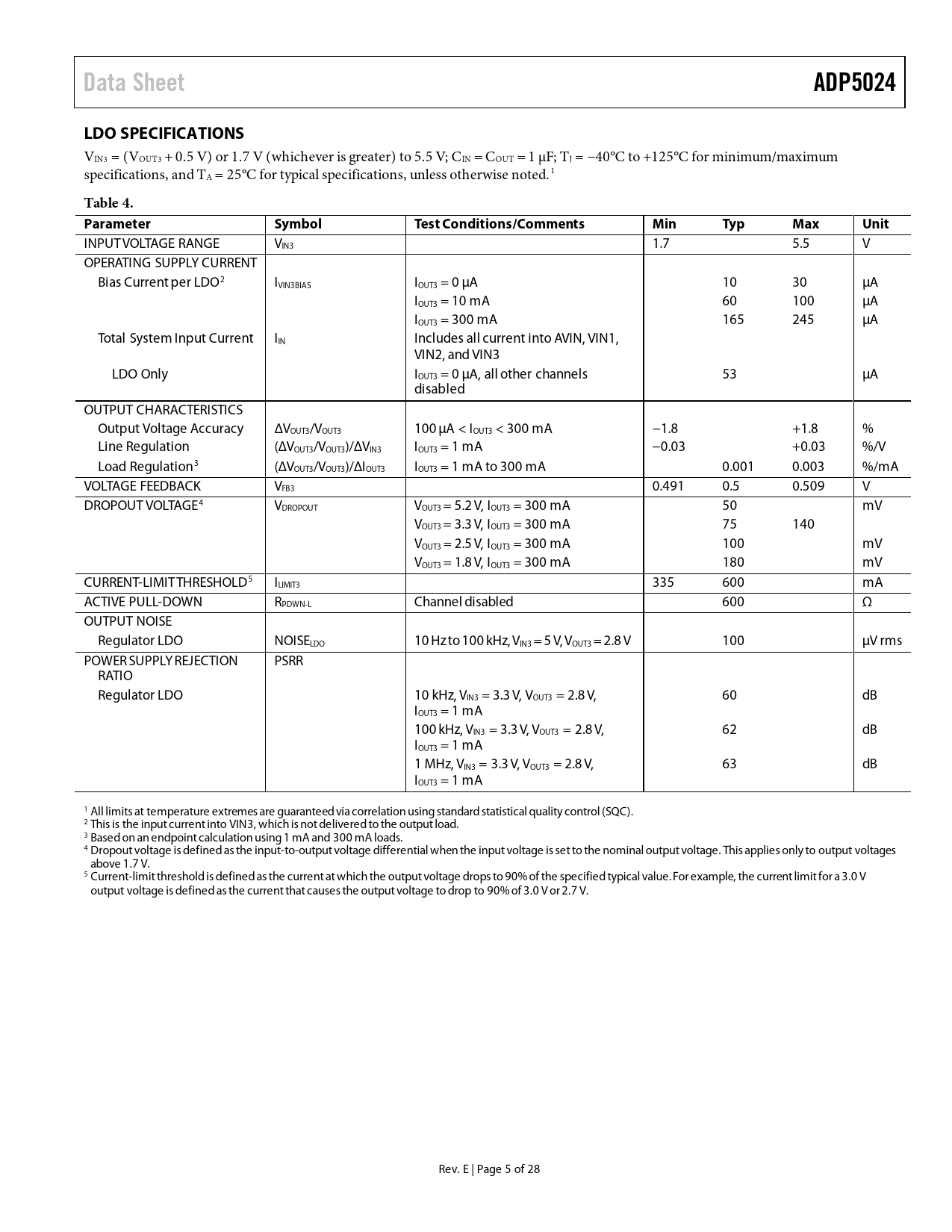

Data Sheet. ADP5024. LDO SPECIFICATIONS. Table 4. Parameter. Symbol. Test Conditions/Comments. Min. Typ. Max. Unit
Data Sheet ADP5024 LDO SPECIFICATIONS Table 4 Parameter Symbol Test Conditions/Comments Min Typ Max Unit
link to page 5 link to page 5 link to page 5 link to page 5 link to page 5
VIN3 = (VOUT3 + 0.5 V) or 1.7 V (whichever is greater) to 5.5 V; CIN = COUT = 1 µF; TJ = −40°C to +125°C for minimum/maximum specifications, and TA = 25°C for typical specifications, unless otherwise noted.1
Table 4. Parameter Symbol Test Conditions/Comments Min Typ Max Unit
INPUT VOLTAGE RANGE VIN3 1.7 5.5 V OPERATING SUPPLY CURRENT Bias Current per LDO2 IVIN3BIAS IOUT3 = 0 µA 10 30 µA IOUT3 = 10 mA 60 100 µA IOUT3 = 300 mA 165 245 µA Total System Input Current IIN Includes all current into AVIN, VIN1, VIN2, and VIN3 LDO Only IOUT3 = 0 µA, all other channels 53 µA disabled OUTPUT CHARACTERISTICS Output Voltage Accuracy ΔVOUT3/VOUT3 100 µA < IOUT3 < 300 mA −1.8 +1.8 % Line Regulation (ΔVOUT3/VOUT3)/ΔVIN3 IOUT3 = 1 mA −0.03 +0.03 %/V Load Regulation3 (ΔVOUT3/VOUT3)/ΔIOUT3 IOUT3 = 1 mA to 300 mA 0.001 0.003 %/mA VOLTAGE FEEDBACK VFB3 0.491 0.5 0.509 V DROPOUT VOLTAGE4 VDROPOUT VOUT3 = 5.2 V, IOUT3 = 300 mA 50 mV VOUT3 = 3.3 V, IOUT3 = 300 mA 75 140 VOUT3 = 2.5 V, IOUT3 = 300 mA 100 mV VOUT3 = 1.8 V, IOUT3 = 300 mA 180 mV CURRENT-LIMIT THRESHOLD5 ILIMIT3 335 600 mA ACTIVE PULL-DOWN RPDWN-L Channel disabled 600 Ω OUTPUT NOISE Regulator LDO NOISELDO 10 Hz to 100 kHz, VIN3 = 5 V, VOUT3 = 2.8 V 100 µV rms POWER SUPPLY REJECTION PSRR RATIO Regulator LDO 10 kHz, VIN3 = 3.3 V, VOUT3 = 2.8 V, 60 dB IOUT3 = 1 mA 100 kHz, VIN3 = 3.3 V, VOUT3 = 2.8 V, 62 dB IOUT3 = 1 mA 1 MHz, VIN3 = 3.3 V, VOUT3 = 2.8 V, 63 dB IOUT3 = 1 mA 1 All limits at temperature extremes are guaranteed via correlation using standard statistical quality control (SQC). 2 This is the input current into VIN3, which is not delivered to the output load. 3 Based on an endpoint calculation using 1 mA and 300 mA loads. 4 Dropout voltage is defined as the input-to-output voltage differential when the input voltage is set to the nominal output voltage. This applies only to output voltages above 1.7 V. 5 Current-limit threshold is defined as the current at which the output voltage drops to 90% of the specified typical value. For example, the current limit for a 3.0 V output voltage is defined as the current that causes the output voltage to drop to 90% of 3.0 V or 2.7 V. Rev. E | Page 5 of 28 Document Outline Features Applications General Description Typical Application Circuit Revision History Specifications General Specifications BUCK1 and BUCK2 Specifications LDO Specifications Input and Output Capacitor, Recommended Specifications Absolute Maximum Ratings Thermal Resistance ESD Caution Pin Configuration and Function Descriptions Typical Performance Characteristics Theory of Operation Power Management Unit Thermal Protection Undervoltage Lockout Enable/Shutdown BUCK1 and BUCK2 Control Scheme PWM Mode Power Save Mode (PSM) PSM Current Threshold Oscillator/Phasing of Inductor Switching Short-Circuit Protection Soft Start Current Limit 100% Duty Operation Active Pull-Down Resistors LDO Applications Information Buck External Component Selection Feedback Resistors Inductor Output Capacitor Input Capacitor LDO External Component Selection Feedback Resistors Output Capacitor Input Bypass Capacitor Input and Output Capacitor Properties Power Dissipation and Thermal Considerations Buck Regulator Power Dissipation LDO Regulator Power Dissipation Junction Temperature PCB Layout Guidelines Typical Application Schematics Bill of Materials Outline Dimensions Ordering Guide
