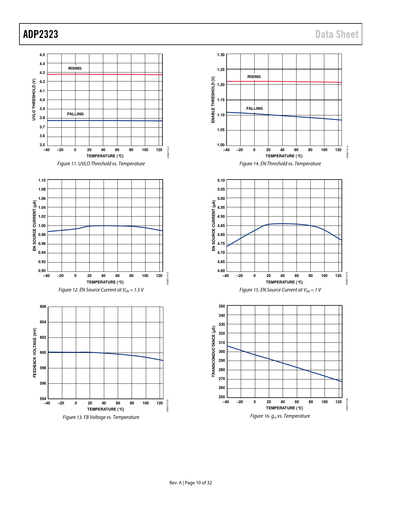

ADP2323. Data Sheet. 4.5. 1.30. 4.4. RISING. 1.25. 4.3. 4.2. D (. 1.20. 4.1. 4.0. 1.15. HRE. 3.9. FALLING. O L. 1.10. 3.8. NABL E. 3.7. 1.05. 3.6. 3.5. 1.00. –40. –20. 100. 120

09357- 09357- Figure 11. UVLO Threshold vs. Temperature Figure 14. EN Threshold vs. Temperature

09357- 09357- Figure 12. EN Source Current at VEN = 1.5 V Figure 15. EN Source Current at VEN = 1 V

09357- 09357- Figure 13. FB Voltage vs. Temperature Figure 16. gm vs. Temperature Rev. A | Page 10 of 32 Document Outline Features Applications Typical Application Circuit General Description Revision History Functional Block Diagram Specifications Absolute Maximum Ratings Thermal Resistance Boundary Condition ESD Caution Pin Configuration and Function Descriptions Typical Performance Characteristics Theory of Operation Control Scheme PWM Mode PFM Mode Precision Enable/Shutdown Separate Input Voltages Internal Regulator (INTVCC) Bootstrap Circuitry Low-Side Driver Oscillator Synchronization Soft Start Peak Current-Limit and Short-Circuit Protection Voltage Tracking Parallel Operation Power Good Overvoltage Protection Undervoltage Lockout Thermal Shutdown Applications Information ADIsimPower Design Tool Input Capacitor Selection Output Voltage Setting Voltage Conversion Limitations Current-Limit Setting Inductor Selection Output Capacitor Selection Low-Side Power Device Selection Programming UVLO Input Compensation Components Design Design Example Output Voltage Setting Current-Limit Setting Frequency Setting Inductor Selection Output Capacitor Selection Low-Side MOSFET Selection Compensation Components Soft Start Time Programming Input Capacitor Selection External Components Recommendation Typical Application Circuits Outline Dimensions Ordering Guide
