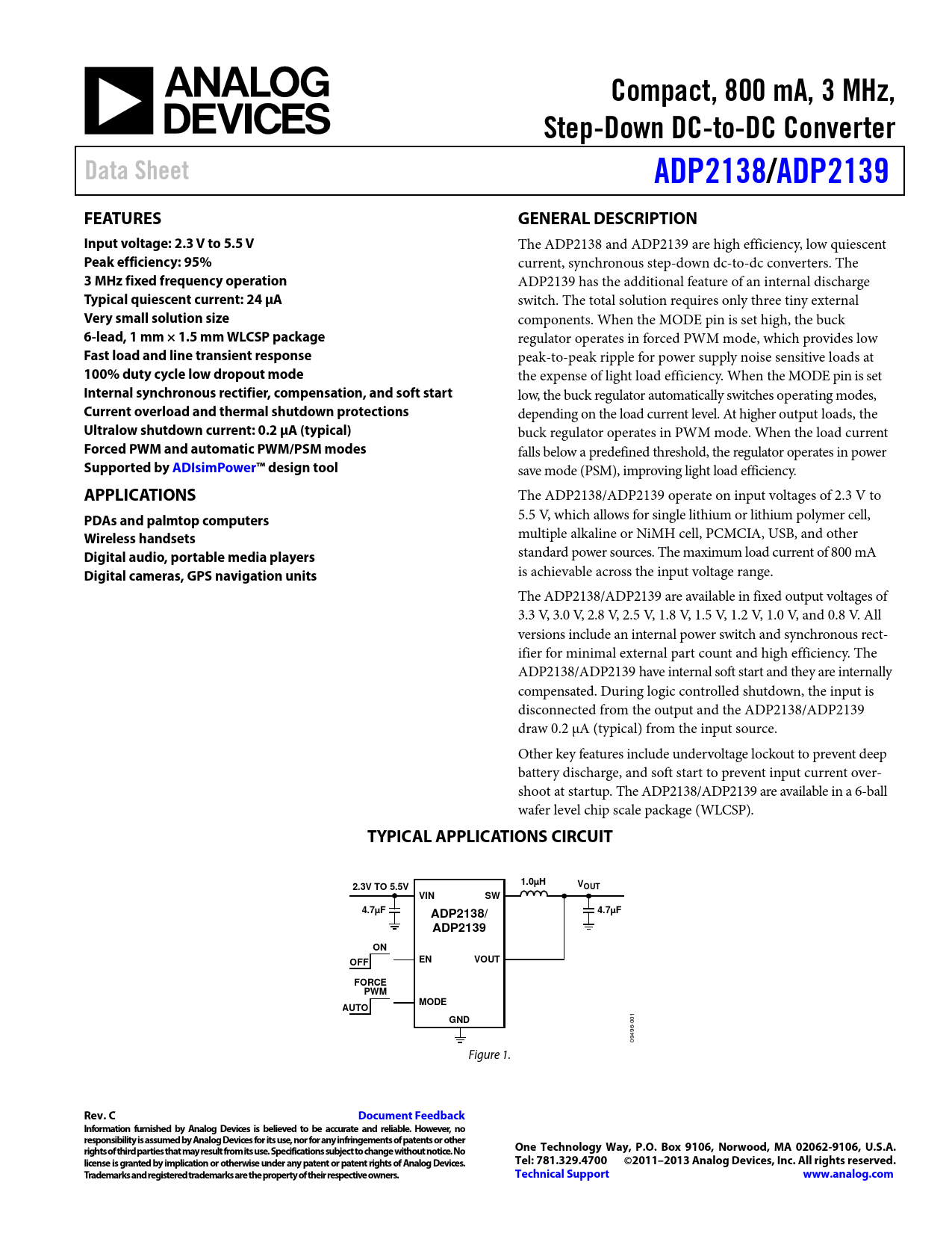

Compact, 800 mA, 3 MHz,. Step-Down DC-to-DC Converter. Data Sheet. ADP2138/. ADP2139. FEATURES. GENERAL DESCRIPTION
Datasheet ADP2138, ADP2139 Analog Devices, Revision: C
Compact, 800 mA, 3 MHz, Step-Down DC-to-DC Converter Data Sheet ADP2138/ ADP2139 FEATURES GENERAL DESCRIPTION Input voltage: 2.3 V to 5.5 V
The ADP2138 and ADP2139 are high efficiency, low quiescent
Peak efficiency: 95%
current, synchronous step-down dc-to-dc converters. The
3 MHz fixed frequency operation
ADP2139 has the additional feature of an internal discharge
Typical quiescent current: 24 μA
switch. The total solution requires only three tiny external
Very small solution size
components. When the MODE pin is set high, the buck
6-lead, 1 mm × 1.5 mm WLCSP package
regulator operates in forced PWM mode, which provides low
Fast load and line transient response
peak-to-peak ripple for power supply noise sensitive loads at
100% duty cycle low dropout mode
the expense of light load efficiency. When the MODE pin is set
Internal synchronous rectifier, compensation, and soft start
low, the buck regulator automatical y switches operating modes,
Current overload and thermal shutdown protections
depending on the load current level. At higher output loads, the
Ultralow shutdown current: 0.2 μA (typical)
buck regulator operates in PWM mode. When the load current
Forced PWM and automatic PWM/PSM modes
falls below a predefined threshold, the regulator operates in power
Supported by ADIsimPower™ design tool
save mode (PSM), improving light load efficiency.
APPLICATIONS
The ADP2138/ADP2139 operate on input voltages of 2.3 V to
PDAs and palmtop computers
5.5 V, which al ows for single lithium or lithium polymer cel ,
Wireless handsets
multiple alkaline or NiMH cell, PCMCIA, USB, and other
Digital audio, portable media players
standard power sources. The maximum load current of 800 mA
Digital cameras, GPS navigation units
is achievable across the input voltage range. The ADP2138/ADP2139 are available in fixed output voltages of 3.3 V, 3.0 V, 2.8 V, 2.5 V, 1.8 V, 1.5 V, 1.2 V, 1.0 V, and 0.8 V. All versions include an internal power switch and synchronous rect- ifier for minimal external part count and high efficiency. The ADP2138/ADP2139 have internal soft start and they are internal y compensated. During logic controlled shutdown, the input is disconnected from the output and the ADP2138/ADP2139 draw 0.2 μA (typical) from the input source. Other key features include undervoltage lockout to prevent deep battery discharge, and soft start to prevent input current over- shoot at startup. The ADP2138/ADP2139 are available in a 6-ball wafer level chip scale package (WLCSP).
TYPICAL APPLICATIONS CIRCUIT 1.0µH 2.3V TO 5.5V VOUT VIN SW 4.7µF ADP2138/ 4.7µF ADP2139 ON OFF EN VOUT FORCE PWM MODE AUTO GND
001 09496- Figure 1.
