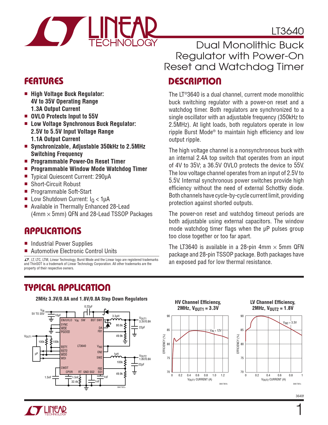

LT3640 Dual Monolithic Buck Regulator with Power-On Reset and Watchdog Timer FeaTures DescripTion n
High Voltage Buck Regulator:
The LT®3640 is a dual channel, current mode monolithic
4V to 35V Operating Range
buck switching regulator with a power-on reset and a
1.3A Output Current
watchdog timer. Both regulators are synchronized to a n
OVLO Protects Input to 55V
single oscillator with an adjustable frequency (350kHz to n
Low Voltage Synchronous Buck Regulator:
2.5MHz). At light loads, both regulators operate in low
2.5V to 5.5V Input Voltage Range
ripple Burst Mode® to maintain high efficiency and low
1.1A Output Current
output ripple. n
Synchronizable, Adjustable 350kHz to 2.5MHz
The high voltage channel is a nonsynchronous buck with
Switching Frequency
an internal 2.4A top switch that operates from an input n
Programmable Power-On Reset Timer
of 4V to 35V; a 36.5V OVLO protects the device to 55V. n
Programmable Window Mode Watchdog Timer
The low voltage channel operates from an input of 2.5V to n Typical Quiescent Current: 290µA 5.5V. Internal synchronous power switches provide high n Short-Circuit Robust efficiency without the need of external Schottky diode. n Programmable Soft-Start Both channels have cycle-by-cycle current limit, providing n Low Shutdown Current: IQ < 1µA protection against shorted outputs. n Available in Thermally Enhanced 28-Lead (4mm × 5mm) QFN and 28-Lead TSSOP Packages The power-on reset and watchdog timeout periods are both adjustable using external capacitors. The window mode watchdog timer flags when the µP pulses group applicaTions too close together or too far apart. n Industrial Power Supplies The LT3640 is available in a 28-pin 4mm × 5mm QFN n Automotive Electronic Control Units package and 28-pin TSSOP package. Both packages have L, LT, LTC, LTM, Linear Technology, Burst Mode and the Linear logo are registered trademarks and ThinSOT is a trademark of Linear Technology Corporation. All other trademarks are the an exposed pad for low thermal resistance. property of their respective owners. Typical applicaTion
2MHz 3.3V/0.8A and 1.8V/0.8A Step Down Regulators HV Channel Efficiency, LV Channel Efficiency,
0.22µF
2MHz, V 2MHz, V
V
OUT1 = 3.3V OUT2 = 1.8V
