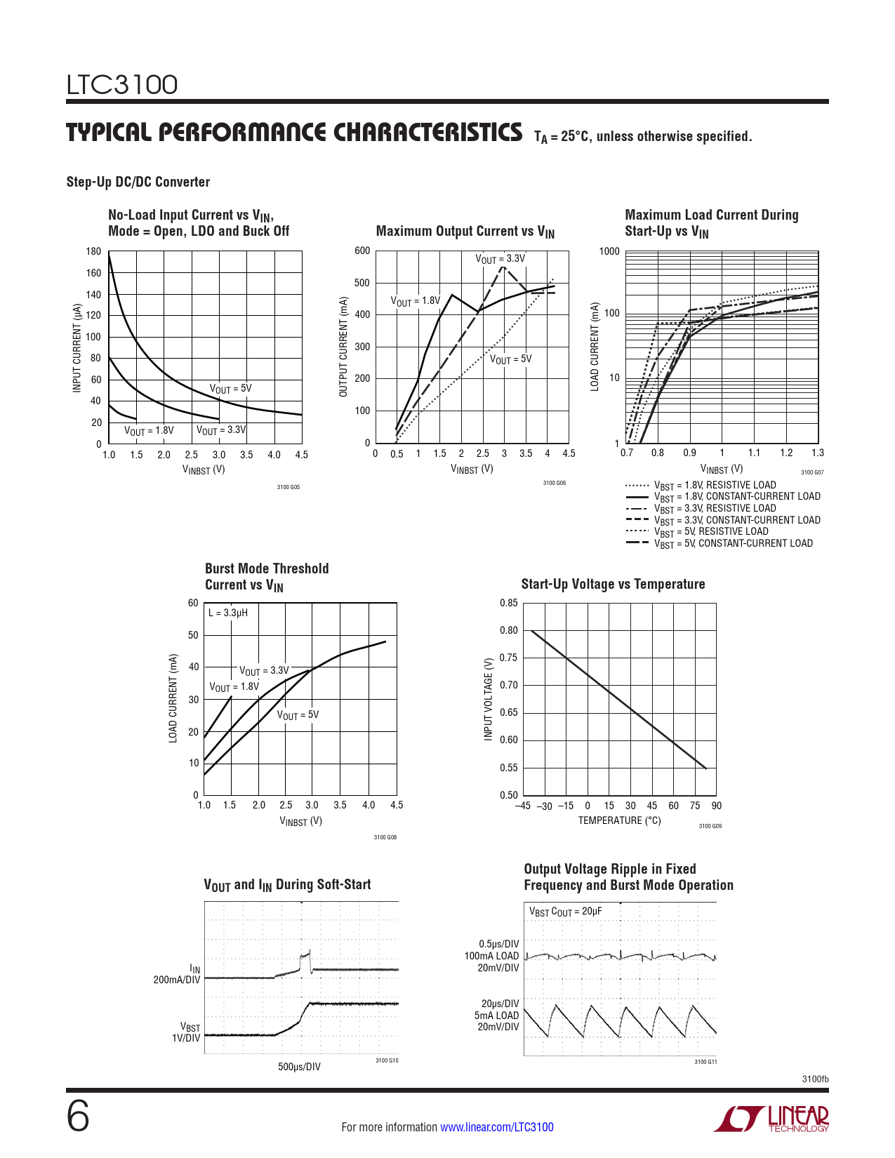

TYPICAL PERFORMANCE CHARACTERISTICS TA = 25°C, unless otherwise specified. Step-Up DC/DC Converter
LTC3100
TYPICAL PERFORMANCE CHARACTERISTICS TA = 25°C, unless otherwise specified. Step-Up DC/DC Converter No-Load Input Current vs VIN, Maximum Load Current During Mode = Open, LDO and Buck Off Maximum Output Current vs VIN Start-Up vs VIN
180 600 1000 VOUT = 3.3V 160 500 140 VOUT = 1.8V 120 400 100 100 300 80 VOUT = 5V 60 200 10 INPUT CURRENT (µA) VOUT = 5V LOAD CURRENT (mA) OUTPUT CURRENT (mA) 40 100 20 V V OUT = 1.8V OUT = 3.3V 0 0 1 1.0 1.5 2.0 2.5 3.0 3.5 4.0 4.5 0 0.5 1 1.5 2 2.5 3 3.5 4 4.5 0.7 0.8 0.9 1 1.1 1.2 1.3 V V INBST (V) INBST (V) VINBST (V) 3100 G07 3100 G06 3100 G05 VBST = 1.8V, RESISTIVE LOAD VBST = 1.8V, CONSTANT-CURRENT LOAD VBST = 3.3V, RESISTIVE LOAD VBST = 3.3V, CONSTANT-CURRENT LOAD VBST = 5V, RESISTIVE LOAD VBST = 5V, CONSTANT-CURRENT LOAD
Burst Mode Threshold Current vs VIN Start-Up Voltage vs Temperature
60 0.85 L = 3.3µH 50 0.80 0.75 40 VOUT = 3.3V VOUT = 1.8V 0.70 30 VOUT = 5V 0.65 20 LOAD CURRENT (mA) INPUT VOLTAGE (V) 0.60 10 0.55 0 0.50 1.0 1.5 2.0 2.5 3.0 3.5 4.0 4.5 –45 –30 –15 0 15 30 45 60 75 90 VINBST (V) TEMPERATURE (°C) 3100 G09 3100 G08
Output Voltage Ripple in Fixed VOUT and IIN During Soft-Start Frequency and Burst Mode Operation
