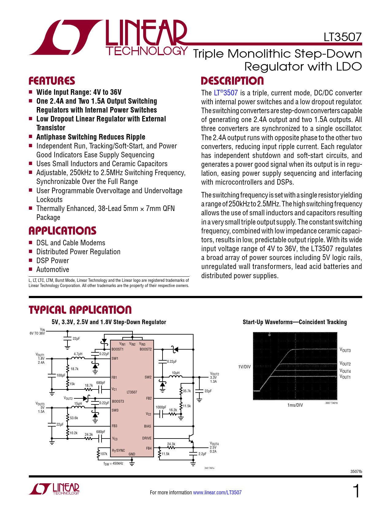

DescriptionTriple Monolithic Step-Down Regulator with LDO
Pages / Page30 / 1 — Features. Description. Wide Input Range: 4V to 36V. One 2.4A and Two 1.5A …
File Format / SizePDF / 395 Kb
Features. Description. Wide Input Range: 4V to 36V. One 2.4A and Two 1.5A Output Switching
Datasheet LT3507 Analog Devices
LT3507 Triple Monolithic Step-Down Regulator with LDO
Features Description
The LT®3507 is a triple, current mode, DC/DC converter n
with internal power switches and a low dropout regulator.
Regulators with Internal Power Switches
The switching converters are step-down converters capable n
Low Dropout Linear Regulator with External
of generating one 2.4A output and two 1.5A outputs. All
Transistor
three converters are synchronized to a single oscillator. n
Antiphase Switching Reduces Ripple
The 2.4A output runs with opposite phase to the other two n Independent Run, Tracking/Soft-Start, and Power converters, reducing input ripple current. Each regulator Good Indicators Ease Supply Sequencing has independent shutdown and soft-start circuits, and n Uses Small Inductors and Ceramic Capacitors generates a power good signal when its output is in regu- n Adjustable, 250kHz to 2.5MHz Switching Frequency, lation, easing power supply sequencing and interfacing Synchronizable Over the Full Range with microcontrollers and DSPs. n User Programmable Overvoltage and Undervoltage The switching frequency is set with a single resistor yielding Lockouts a range of 250kHz to 2.5MHz. The high switching frequency n Thermally Enhanced, 38-Lead 5mm × 7mm QFN allows the use of small inductors and capacitors resulting Package in a very small triple output supply. The constant switching

typical application 5V, 3.3V, 2.5V and 1.8V Step-Down Regulator Start-Up Waveforms—Coincident Tracking
VIN 6V TO 36V 22µF VIN1 VIN2 VIN3 BOOST1 BOOST2 VOUT3 V 4.7µH 0.22µF OUT1 1.8V SW1 2.4A 0.22µF VOUT2 18.7k 1V/DIV V 10µH V OUT4 OUT2 100µF FB1 SW2 3.3V VOUT1 1.3A 15k 680pF 18.7k VC1 LT3507 35.7k 22µF VOUT2 FB2 BOOST3 V 15µH 0.22µF OUT3 1ms/DIV 3507 TA01b 5V 1000pF 11.5k SW3 1.5A 16.2k VC2 53.6k 22µF FB3 BIAS 10.2k 680pF 24.3k VC3 DRIVE 24.3k VOUT4 FB4 2.5V RT/SYNC 0.2A 107k GND 11.5k 2.2µF fSW = 450kHz 3507 TA01a 3507fb For more information www.linear.com/LT3507 1
