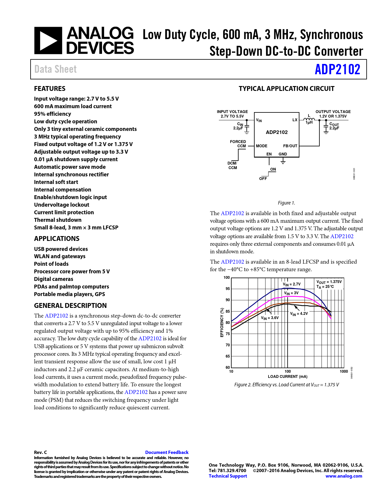

Low Duty Cycle, 600 mA, 3 MHz, Synchronous. Step-Down DC-to-DC Converter. Data Sheet. ADP2102. FEATURES
Low Duty Cycle, 600 mA, 3 MHz, Synchronous Step-Down DC-to-DC Converter Data Sheet ADP2102 FEATURES TYPICAL APPLICATION CIRCUIT Input voltage range: 2.7 V to 5.5 V 600 mA maximum load current 95% efficiency INPUT VOLTAGE OUTPUT VOLTAGE 2.7V TO 5.5V L 1.2V OR 1.375V Low duty cycle operation V LX IN C 1µH IN COUT Only 3 tiny external ceramic components 2.2µF 2.2µF ADP2102 3 MHz typical operating frequency Fixed output voltage of 1.2 V or 1.375 V FORCED CCM MODE FB/OUT Adjustable output voltage up to 3.3 V EN GND 0.01 µA shutdown supply current DCM/ Automatic power save mode CCM ON
001
Internal synchronous rectifier Internal soft start OFF
06631-
Internal compensation Enable/shutdown logic input Undervoltage lockout
Figure 1.
Current limit protection
The ADP2102 is available in both fixed and adjustable output
Thermal shutdown
voltage options with a 600 mA maximum output current. The fixed
Small 8-lead, 3 mm × 3 mm LFCSP
output voltage options are 1.2 V and 1.375 V. The adjustable output
APPLICATIONS
voltage options are available from 1.5 V to 3.3 V. The ADP2102 requires only three external components and consumes 0.01 µA
USB powered devices
in shutdown mode.
WLAN and gateways Point of loads
The ADP2102 is available in an 8-lead LFCSP and is specified
Processor core power from 5 V
for the −40°C to +85°C temperature range.
Digital cameras 100 VOUT = 1.375V PDAs and palmtop computers VIN = 2.7V TA = 25°C 95 Portable media players, GPS VIN = 3V 90 GENERAL DESCRIPTION %) 85
The ADP2102 is a synchronous step-down dc-to-dc converter
( VIN = 4.2V VIN = 3.6V
that converts a 2.7 V to 5.5 V unregulated input voltage to a lower
NCY E 80
regulated output voltage with up to 95% efficiency and 1%
ICI F F 75
accuracy. The low duty cycle capability of the ADP2102 is ideal for
E
USB applications or 5 V systems that power up submicron subvolt
70
processor cores. Its 3 MHz typical operating frequency and excel-
65
lent transient response allow the use of small, low cost 1 µH inductors and 2.2 µF ceramic capacitors. At medium-to-high
60 10 100 1000
052 load currents, it uses a current mode, pseudofixed frequency pulse-
LOAD CURRENT (mA)
06631- width modulation to extend battery life. To ensure the longest Figure 2. Efficiency vs. Load Current at VOUT = 1.375 V battery life in portable applications, the ADP2102 has a power save mode (PSM) that reduces the switching frequency under light load conditions to significantly reduce quiescent current.
