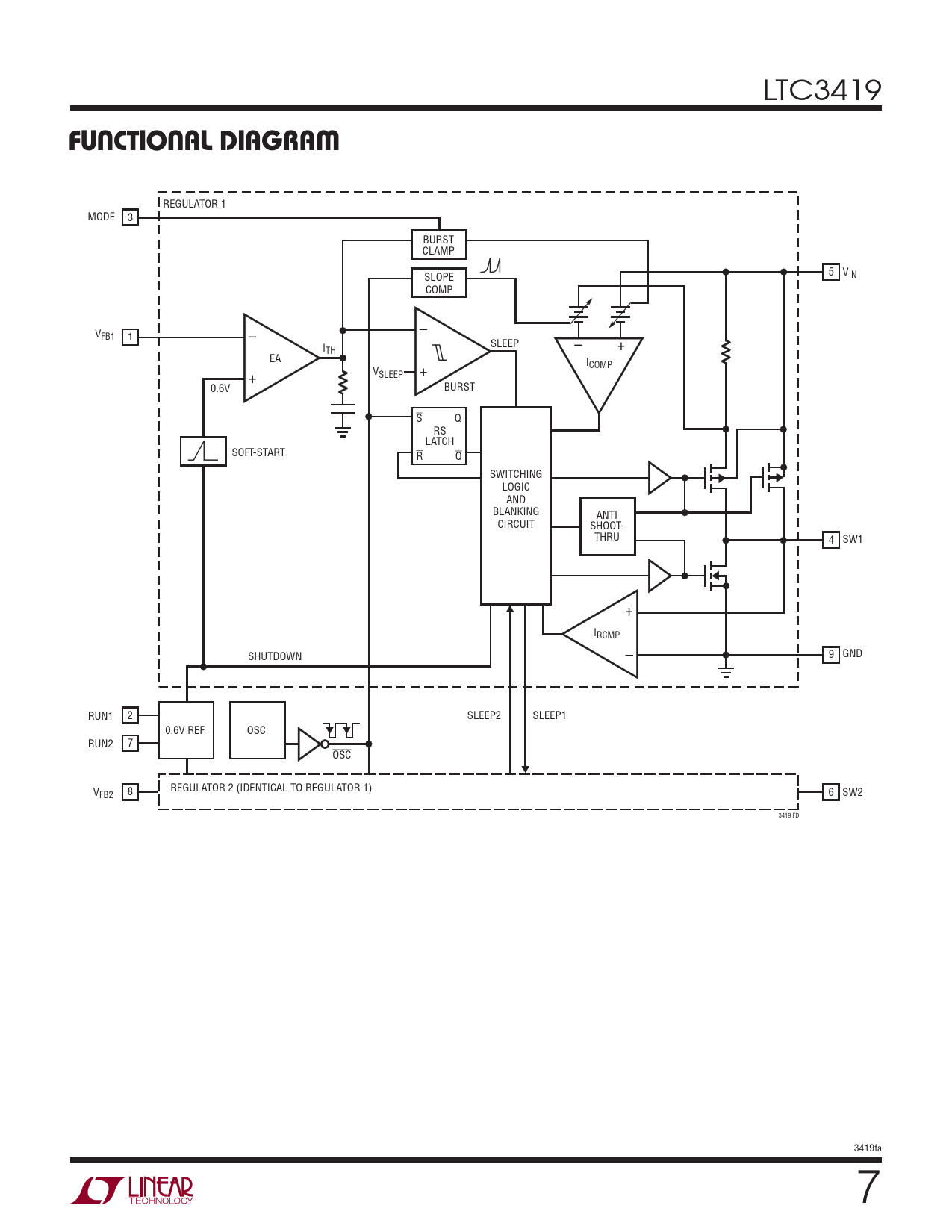

FUNCTIONAL DIAGRAM
LTC3419
FUNCTIONAL DIAGRAM
REGULATOR 1 MODE 3 BURST CLAMP 5 V SLOPE IN COMP VFB1 1 – – I SLEEP – + TH EA ICOMP + VSLEEP + 0.6V BURST S Q RS LATCH SOFT-START R Q SWITCHING LOGIC AND BLANKING ANTI CIRCUIT SHOOT- THRU 4 SW1 + IRCMP – SHUTDOWN 9 GND RUN1 2 SLEEP2 SLEEP1 0.6V REF OSC RUN2 7 OSC REGULATOR 2 (IDENTICAL TO REGULATOR 1) V 8 6 SW2 FB2 3419 FD 3419fa 7
