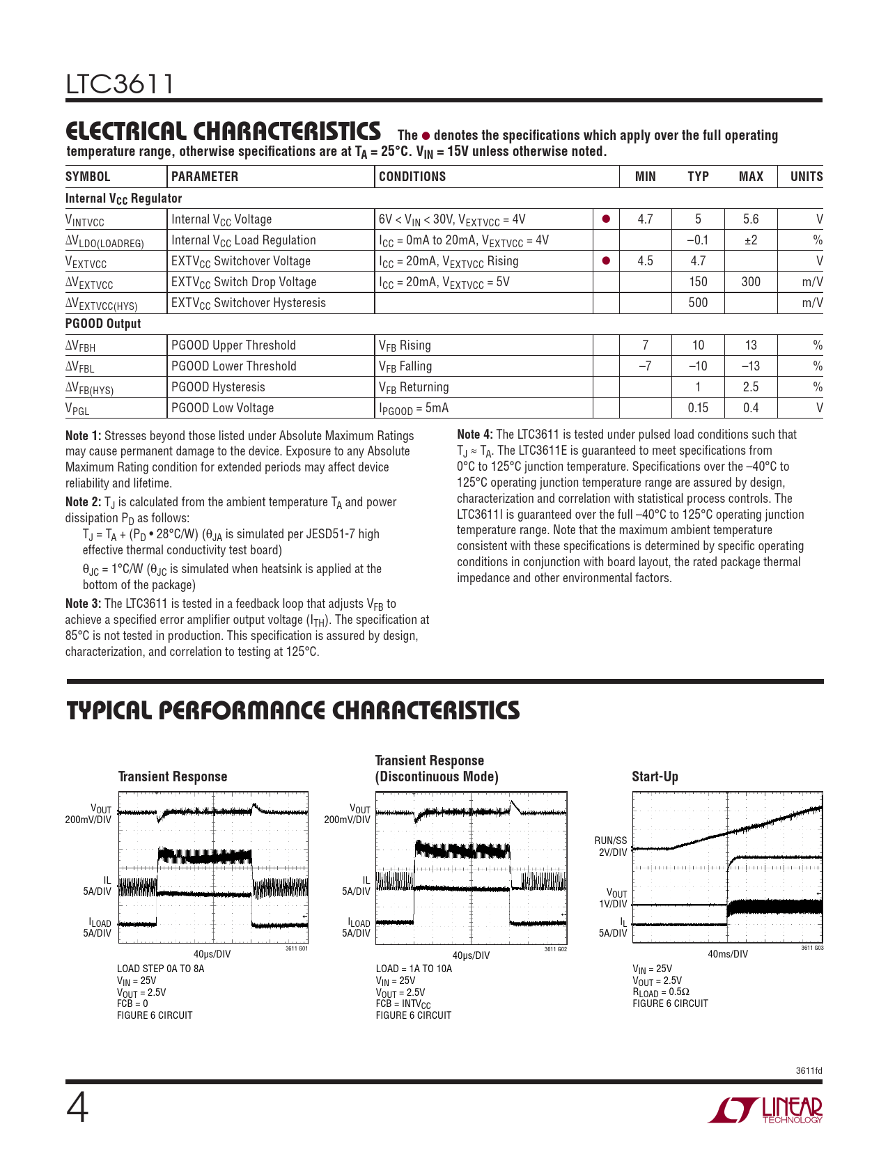

LTC3611 e
lectricAl chArActeristics
The
l
denotes the specifications which apply over the full operating temperature range, otherwise specifications are at TA = 25°C. VIN = 15V unless otherwise noted. SYMBOL PARAMETER CONDITIONS MIN TYP MAX UNITS Internal VCC Regulator
VINTVCC Internal VCC Voltage 6V < VIN < 30V, VEXTVCC = 4V l 4.7 5 5.6 V ΔVLDO(LOADREG) Internal VCC Load Regulation ICC = 0mA to 20mA, VEXTVCC = 4V –0.1 ±2 % VEXTVCC EXTVCC Switchover Voltage ICC = 20mA, VEXTVCC Rising l 4.5 4.7 V ΔVEXTVCC EXTVCC Switch Drop Voltage ICC = 20mA, VEXTVCC = 5V 150 300 m/V ΔVEXTVCC(HYS) EXTVCC Switchover Hysteresis 500 m/V
PGOOD Output
ΔVFBH PGOOD Upper Threshold VFB Rising 7 10 13 % ΔVFBL PGOOD Lower Threshold VFB Fal ing –7 –10 –13 % ΔVFB(HYS) PGOOD Hysteresis VFB Returning 1 2.5 % VPGL PGOOD Low Voltage IPGOOD = 5mA 0.15 0.4 V
Note 1:
Note 4:
The LTC3611 is tested under pulsed load conditions such that may cause permanent damage to the device. Exposure to any Absolute TJ ≈ TA. The LTC3611E is guaranteed to meet specifications from Maximum Rating condition for extended periods may affect device 0°C to 125°C junction temperature. Specifications over the –40°C to reliability and lifetime. 125°C operating junction temperature range are assured by design,
Note 2:
T characterization and correlation with statistical process controls. The J is calculated from the ambient temperature TA and power dissipation P LTC3611I is guaranteed over the full –40°C to 125°C operating junction D as follows: T temperature range. Note that the maximum ambient temperature J = TA + (PD • 28°C/W) (θJA is simulated per JESD51-7 high effective thermal conductivity test board) consistent with these specifications is determined by specific operating θ conditions in conjunction with board layout, the rated package thermal JC = 1°C/W (θJC is simulated when heatsink is applied at the bottom of the package) impedance and other environmental factors.
Note 3:
The LTC3611 is tested in a feedback loop that adjusts VFB to achieve a specified error amplifier output voltage (ITH). The specification at 85°C is not tested in production. This specification is assured by design, characterization, and correlation to testing at 125°C. typicAl perForMAnce chArActeristics
Transient Response Transient Response (Discontinuous Mode) Start-Up
