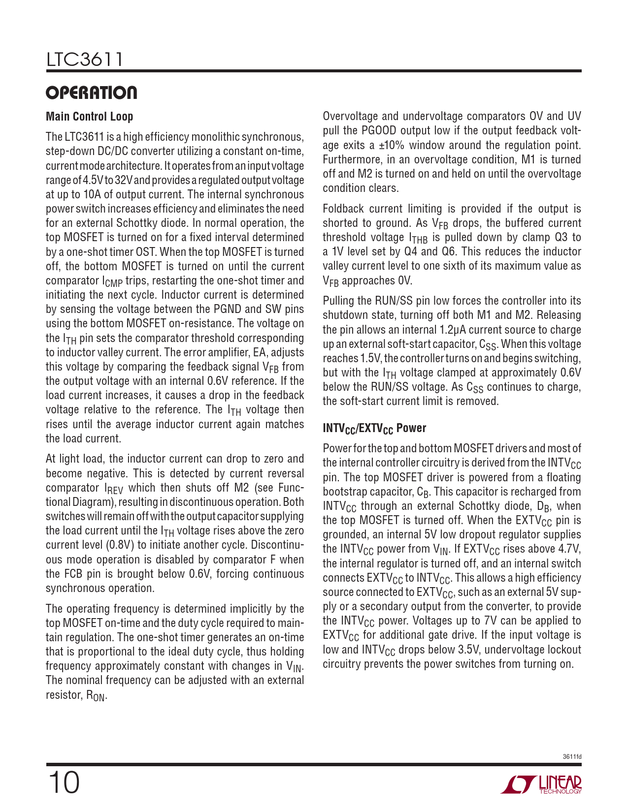

LTC3611 operAtion
Main Control Loop
Overvoltage and undervoltage comparators OV and UV The LTC3611 is a high efficiency monolithic synchronous, pull the PGOOD output low if the output feedback volt- step-down DC/DC converter utilizing a constant on-time, age exits a ±10% window around the regulation point. current mode architecture. It operates from an input voltage Furthermore, in an overvoltage condition, M1 is turned range of 4.5V to 32V and provides a regulated output voltage off and M2 is turned on and held on until the overvoltage at up to 10A of output current. The internal synchronous condition clears. power switch increases efficiency and eliminates the need Foldback current limiting is provided if the output is for an external Schottky diode. In normal operation, the shorted to ground. As VFB drops, the buffered current top MOSFET is turned on for a fixed interval determined threshold voltage ITHB is pul ed down by clamp Q3 to by a one-shot timer OST. When the top MOSFET is turned a 1V level set by Q4 and Q6. This reduces the inductor off, the bottom MOSFET is turned on until the current val ey current level to one sixth of its maximum value as comparator ICMP trips, restarting the one-shot timer and VFB approaches 0V. initiating the next cycle. Inductor current is determined Pul ing the RUN/SS pin low forces the control er into its by sensing the voltage between the PGND and SW pins shutdown state, turning off both M1 and M2. Releasing using the bottom MOSFET on-resistance. The voltage on the pin al ows an internal 1.2μA current source to charge the ITH pin sets the comparator threshold corresponding up an external soft-start capacitor, C to inductor val ey current. The error amplifier, EA, adjusts SS. When this voltage reaches 1.5V, the control er turns on and begins switching, this voltage by comparing the feedback signal VFB from but with the I the output voltage with an internal 0.6V reference. If the TH voltage clamped at approximately 0.6V below the RUN/SS voltage. As C load current increases, it causes a drop in the feedback SS continues to charge, the soft-start current limit is removed. voltage relative to the reference. The ITH voltage then rises until the average inductor current again matches
INTV
the load current.
CC/EXTVCC Power
Power for the top and bottom MOSFET drivers and most of At light load, the inductor current can drop to zero and the internal control er circuitry is derived from the INTV become negative. This is detected by current reversal CC pin. The top MOSFET driver is powered from a floating comparator IREV which then shuts off M2 (see Func- bootstrap capacitor, C tional Diagram), resulting in discontinuous operation. Both B. This capacitor is recharged from INTV switches wil remain off with the output capacitor supplying CC through an external Schottky diode, DB, when the top MOSFET is turned off. When the EXTV the load current until the I CC pin is TH voltage rises above the zero grounded, an internal 5V low dropout regulator supplies current level (0.8V) to initiate another cycle. Discontinu- the INTV ous mode operation is disabled by comparator F when CC power from VIN. If EXTVCC rises above 4.7V, the internal regulator is turned off, and an internal switch the FCB pin is brought below 0.6V, forcing continuous connects EXTV synchronous operation. CC to INTVCC. This al ows a high efficiency source connected to EXTVCC, such as an external 5V sup- The operating frequency is determined implicitly by the ply or a secondary output from the converter, to provide top MOSFET on-time and the duty cycle required to main- the INTVCC power. Voltages up to 7V can be applied to tain regulation. The one-shot timer generates an on-time EXTVCC for additional gate drive. If the input voltage is that is proportional to the ideal duty cycle, thus holding low and INTVCC drops below 3.5V, undervoltage lockout frequency approximately constant with changes in VIN. circuitry prevents the power switches from turning on. The nominal frequency can be adjusted with an external resistor, RON. 3611fd 0 Document Outline Features Applications Description Typical Application Absolute Maximum Ratings Pin Configuration order information Electrical Characteristics Typical Performance Characteristics Pin Functions Functional Diagram Operation Applications Information Typical Applications Package Description Revision History Typical Application Related Parts
