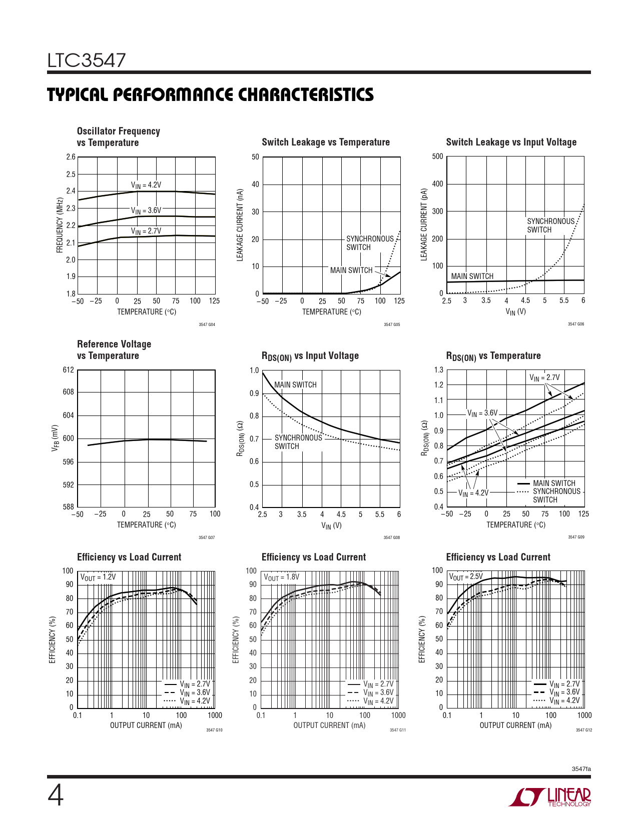

TYPICAL PERFOR A CE CHARACTERISTICS. Oscillator Frequency vs Temperature. Switch Leakage vs Temperature
TYPICAL PERFOR A CE CHARACTERISTICS Oscillator Frequency vs Temperature Switch Leakage vs Temperature
LTC3547
W U TYPICAL PERFOR A CE CHARACTERISTICS Oscillator Frequency vs Temperature Switch Leakage vs Temperature Switch Leakage vs Input Voltage
2.6 50 500 2.5 VIN = 4.2V 40 400 2.4 2.3 VIN = 3.6V 30 300 SYNCHRONOUS 2.2 V SWITCH IN = 2.7V 20 SYNCHRONOUS 200 2.1 FREQUENCY (MHz) SWITCH 2.0 LEAKAGE CURRENT (nA) LEAKAGE CURRENT (pA) 10 100 MAIN SWITCH 1.9 MAIN SWITCH 1.8 0 0 – 50 – 25 0 25 50 75 100 125 – 50 – 25 0 25 50 75 100 125 2.5 3 3.5 4 4.5 5 5.5 6 TEMPERATURE (°C) TEMPERATURE (°C) VIN (V) 3547 G04 3547 G05 3547 G06
Reference Voltage vs Temperature RDS(ON) vs Input Voltage RDS(ON) vs Temperature
612 1.0 1.3 VIN = 2.7V MAIN SWITCH 1.2 608 0.9 1.1 604 0.8 1.0 VIN = 3.6V ) Ω Ω ( 0.9 (mV) 600 0.7 SYNCHRONOUS FB SWITCH 0.8 V DS(ON) DS(ON) R R 596 0.6 0.7 0.6 592 0.5 MAIN SWITCH 0.5 SYNCHRONOUS VIN = 4.2V SWITCH 588 0.4 0.4 – 50 – 25 0 25 50 75 100 2.5 3 3.5 4 4.5 5 5.5 6 – 50 – 25 0 25 50 75 100 125 TEMPERATURE (°C) VIN (V) TEMPERATURE (°C) 3547 G07 3547 G08 3547 G09
Effi ciency vs Load Current Effi ciency vs Load Current Effi ciency vs Load Current
100 100 100 VOUT = 1.2V VOUT = 1.8V VOUT = 2.5V 90 90 90 80 80 80 70 70 70 60 60 60 50 50 50 40 40 40 EFFICIENCY (%) EFFICIENCY (%) EFFICIENCY (%) 30 30 30 20 20 20 VIN = 2.7V VIN = 2.7V VIN = 2.7V 10 VIN = 3.6V 10 VIN = 3.6V 10 VIN = 3.6V VIN = 4.2V VIN = 4.2V VIN = 4.2V 0 0 0 0.1 1 10 100 1000 0.1 1 10 100 1000 0.1 1 10 100 1000 OUTPUT CURRENT (mA) OUTPUT CURRENT (mA) OUTPUT CURRENT (mA) 3547 G10 3547 G11 3547 G12 3547fa 4
