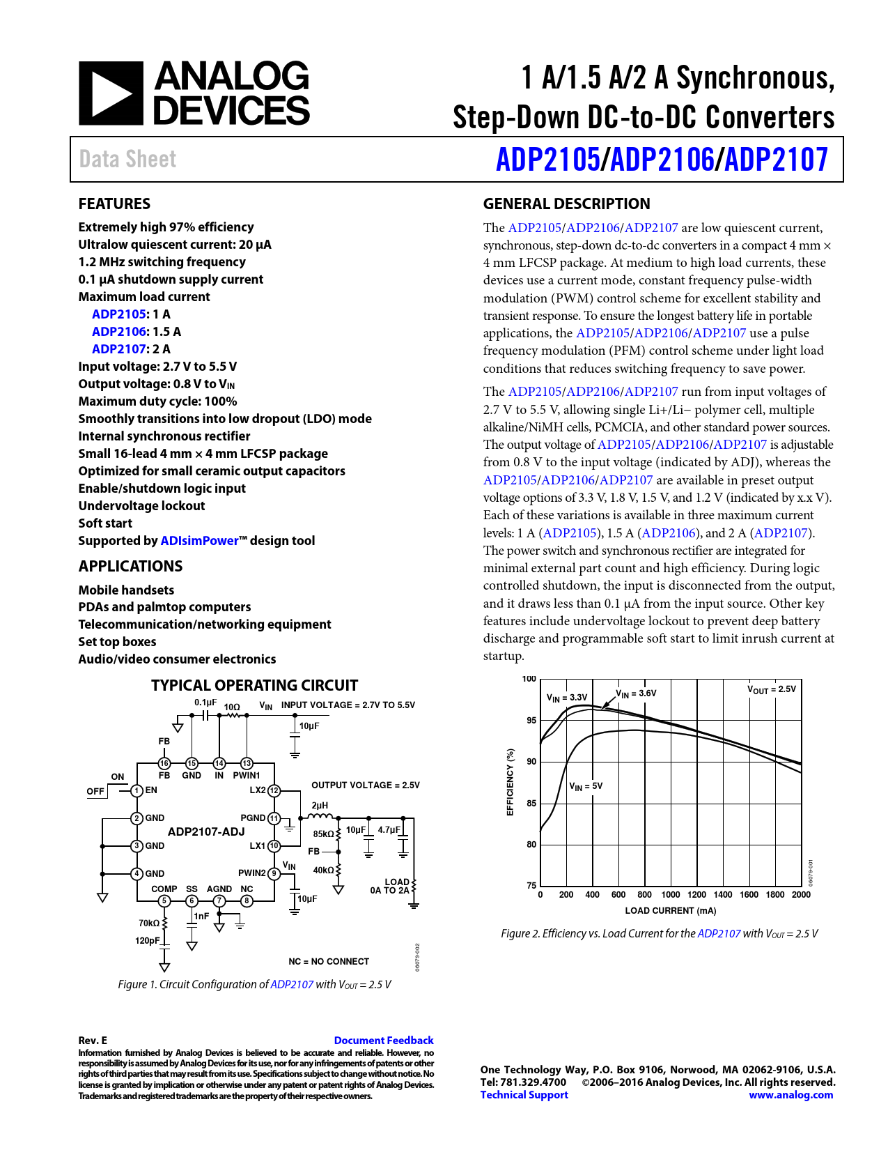

TYPICAL OPERATING CIRCUIT 100 VOUT = 2.5V 0.1μF VIN = 3.3V VIN = 3.6V V 10Ω IN INPUT VOLTAGE = 2.7V TO 5.5V 10μF 95 FB %) 16 15 14 13 ( 90 FB GND IN PWIN1 ON NCY OUTPUT VOLTAGE = 2.5V E V OFF 1 EN LX2 12 IN = 5V ICI 2μH F F 85 E 2 GND PGND 11 ADP2107-ADJ 10μF 4.7μF 85kΩ 3 GND LX1 10 80 FB VIN 40kΩ
001
4 GND PWIN2 9 LOAD
06079-
COMP SS AGND NC 75 0A TO 2A 0 200 400 600 800 1000 1200 1400 1600 1800 2000 5 6 7 8 10μF LOAD CURRENT (mA) 1nF 70kΩ
Figure 2. Efficiency vs. Load Current for the ADP2107 with VOUT = 2.5 V
120pF
002
NC = NO CONNECT
06079- Figure 1. Circuit Configuration of ADP2107 with VOUT = 2.5 V
