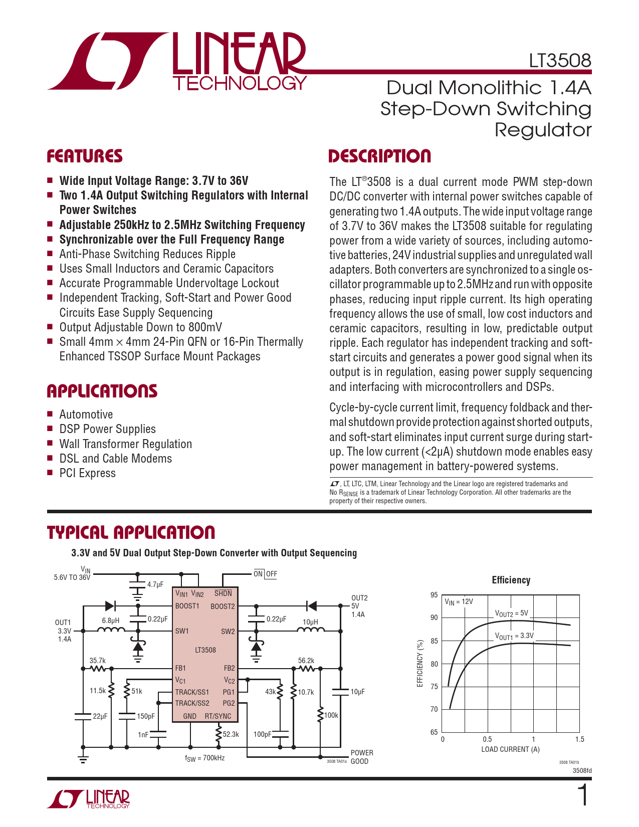

LT3508 Dual Monolithic 1.4A Step-Down Switching Regulator
FEATURES DESCRIPTION
n
Wide Input Voltage Range: 3.7V to 36V
The LT®3508 is a dual current mode PWM step-down n
Two 1.4A Output Switching Regulators with Internal
DC/DC converter with internal power switches capable of
Power Switches
generating two 1.4A outputs. The wide input voltage range n
Adjustable 250kHz to 2.5MHz Switching Frequency
of 3.7V to 36V makes the LT3508 suitable for regulating n
Synchronizable over the Full Frequency Range
power from a wide variety of sources, including automo- n Anti-Phase Switching Reduces Ripple tive batteries, 24V industrial supplies and unregulated wall n Uses Small Inductors and Ceramic Capacitors adapters. Both converters are synchronized to a single os- n Accurate Programmable Undervoltage Lockout cillator programmable up to 2.5MHz and run with opposite n Independent Tracking, Soft-Start and Power Good phases, reducing input ripple current. Its high operating Circuits Ease Supply Sequencing frequency allows the use of small, low cost inductors and n Output Adjustable Down to 800mV ceramic capacitors, resulting in low, predictable output n Small 4mm × 4mm 24-Pin QFN or 16-Pin Thermally ripple. Each regulator has independent tracking and soft- Enhanced TSSOP Surface Mount Packages start circuits and generates a power good signal when its output is in regulation, easing power supply sequencing
APPLICATIONS
and interfacing with microcontrollers and DSPs. Cycle-by-cycle current limit, frequency foldback and ther- n Automotive mal shutdown provide protection against shorted outputs, n DSP Power Supplies and soft-start eliminates input current surge during start- n Wall Transformer Regulation up. The low current (<2μA) shutdown mode enables easy n DSL and Cable Modems power management in battery-powered systems. n PCI Express L, LT, LTC, LTM, Linear Technology and the Linear logo are registered trademarks and No RSENSE is a trademark of Linear Technology Corporation. All other trademarks are the property of their respective owners.
TYPICAL APPLICATION 3.3V and 5V Dual Output Step-Down Converter with Output Sequencing
