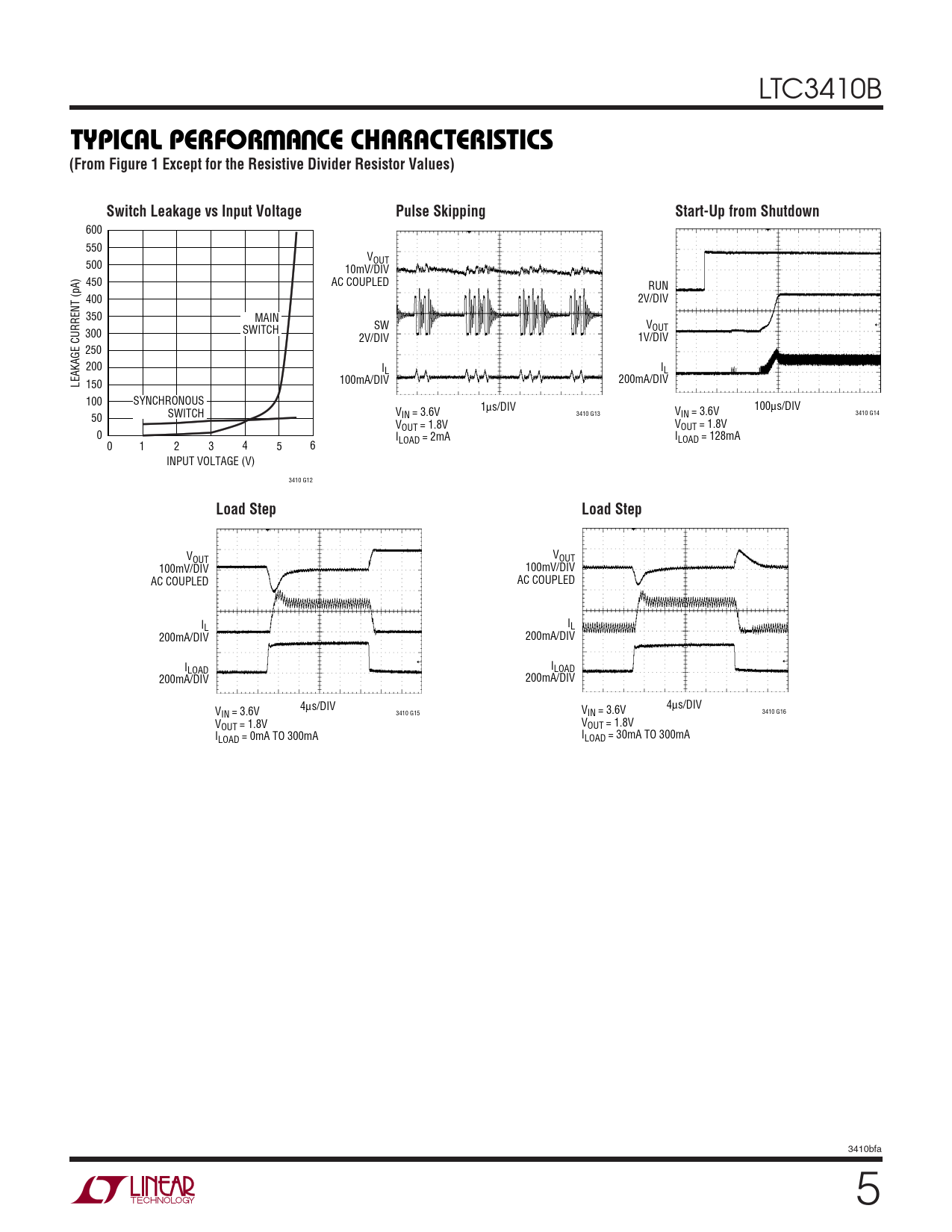

TYPICAL PERFOR A CE CHARACTERISTICS. (From Figure 1 Except for the Resistive Divider Resistor Values)
TYPICAL PERFOR A CE CHARACTERISTICS (From Figure 1 Except for the Resistive Divider Resistor Values)
LTC3410B
W U TYPICAL PERFOR A CE CHARACTERISTICS (From Figure 1 Except for the Resistive Divider Resistor Values) Switch Leakage vs Input Voltage Pulse Skipping Start-Up from Shutdown
600 550 V 500 OUT 10mV/DIV 450 AC COUPLED RUN 400 2V/DIV 350 MAIN SW VOUT 300 SWITCH 2V/DIV 1V/DIV 250 200 IL IL LEAKAGE CURRENT (pA) 150 100mA/DIV 200mA/DIV 100 SYNCHRONOUS 1µs/DIV 100µs/DIV V V 3410 G14 50 SWITCH IN = 3.6V 3410 G13 IN = 3.6V VOUT = 1.8V VOUT = 1.8V 0 ILOAD = 2mA ILOAD = 128mA 0 1 2 3 4 5 6 INPUT VOLTAGE (V) 3410 G12
Load Step Load Step
VOUT VOUT 100mV/DIV 100mV/DIV AC COUPLED AC COUPLED IL IL 200mA/DIV 200mA/DIV ILOAD ILOAD 200mA/DIV 200mA/DIV 4µs/DIV 4µs/DIV VIN = 3.6V 3410 G15 VIN = 3.6V 3410 G16 VOUT = 1.8V VOUT = 1.8V ILOAD = 0mA TO 300mA ILOAD = 30mA TO 300mA 3410bfa 5
