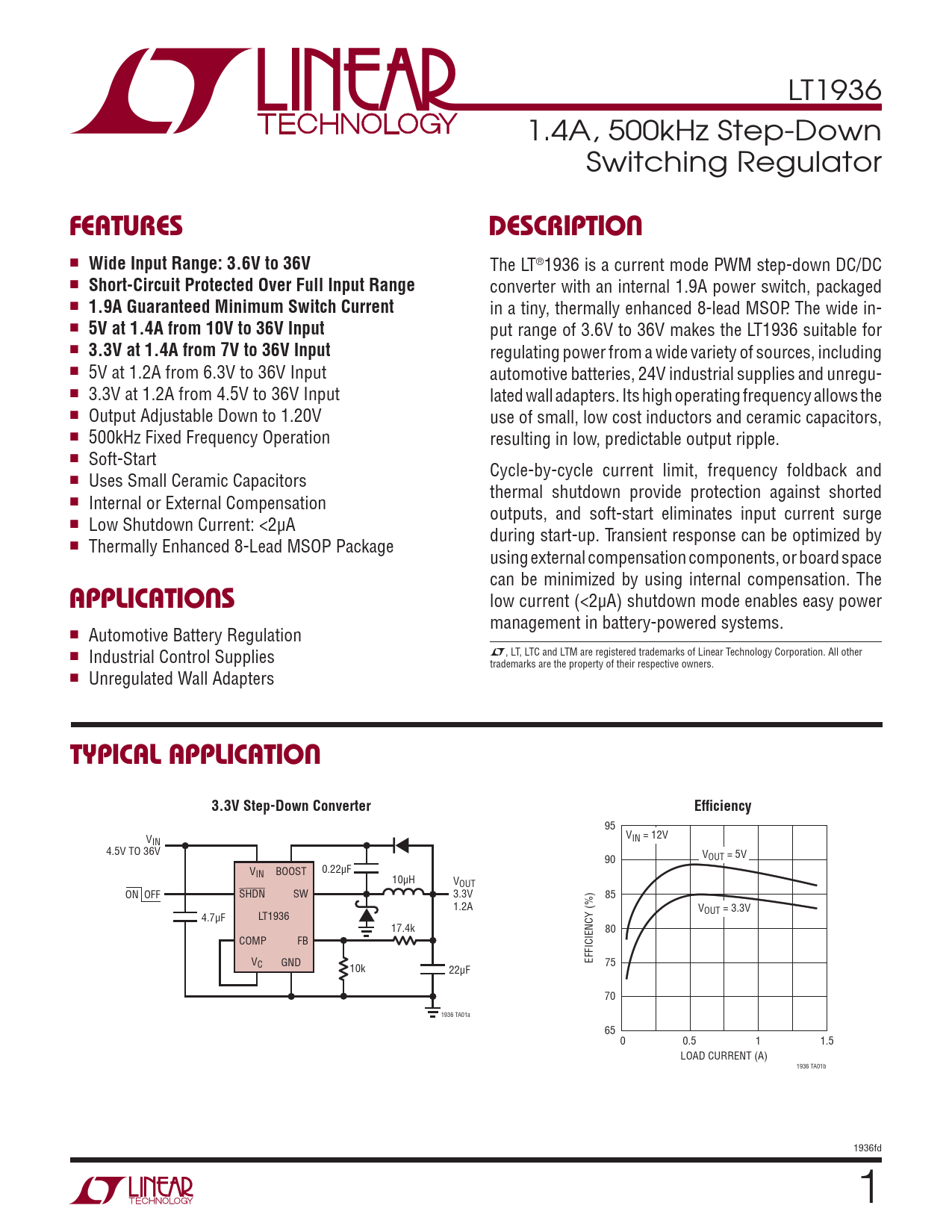

FEATURES. DESCRIPTION. Wide Input Range: 3.6V to 36V. Short-Circuit Protected Over Full Input Range
Datasheet LT1936 Analog Devices
LT1936 1.4A, 500kHz Step-Down Switching Regulator
FEATURES DESCRIPTION
The LT®1936 is a current mode PWM step-down DC/DC ■
converter with an internal 1.9A power switch, packaged ■
1.9A Guaranteed Minimum Switch Current
in a tiny, thermally enhanced 8-lead MSOP. The wide in- ■
5V at 1.4A from 10V to 36V Input
put range of 3.6V to 36V makes the LT1936 suitable for ■
3.3V at 1.4A from 7V to 36V Input
regulating power from a wide variety of sources, including ■ 5V at 1.2A from 6.3V to 36V Input automotive batteries, 24V industrial supplies and unregu- ■ 3.3V at 1.2A from 4.5V to 36V Input lated wall adapters. Its high operating frequency allows the ■ Output Adjustable Down to 1.20V use of small, low cost inductors and ceramic capacitors, ■ 500kHz Fixed Frequency Operation resulting in low, predictable output ripple. ■ Soft-Start Cycle-by-cycle current limit, frequency foldback and ■ Uses Small Ceramic Capacitors thermal shutdown provide protection against shorted ■ Internal or External Compensation outputs, and soft-start eliminates input current surge ■ Low Shutdown Current: <2μA during start-up. Transient response can be optimized by ■ Thermally Enhanced 8-Lead MSOP Package using external compensation components, or board space can be minimized by using internal compensation. The
APPLICATIONS
low current (<2μA) shutdown mode enables easy power management in battery-powered systems. ■ Automotive Battery Regulation ■ Industrial Control Supplies L, LT, LTC and LTM are registered trademarks of Linear Technology Corporation. All other trademarks are the property of their respective owners. ■ Unregulated Wall Adapters
TYPICAL APPLICATION 3.3V Step-Down Converter Effi ciency
