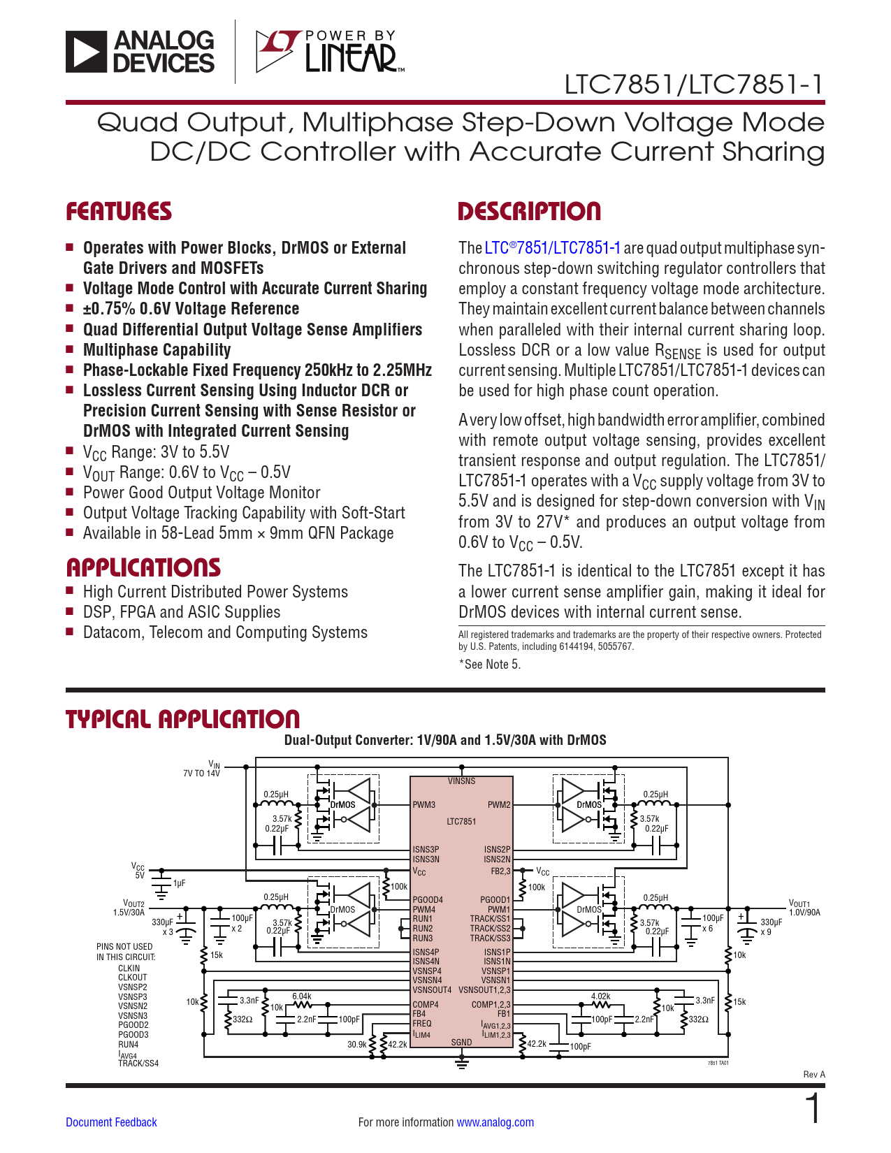

TYPICAL APPLICATION Dual-Output Converter: 1V/90A and 1.5V/30A with DrMOS
