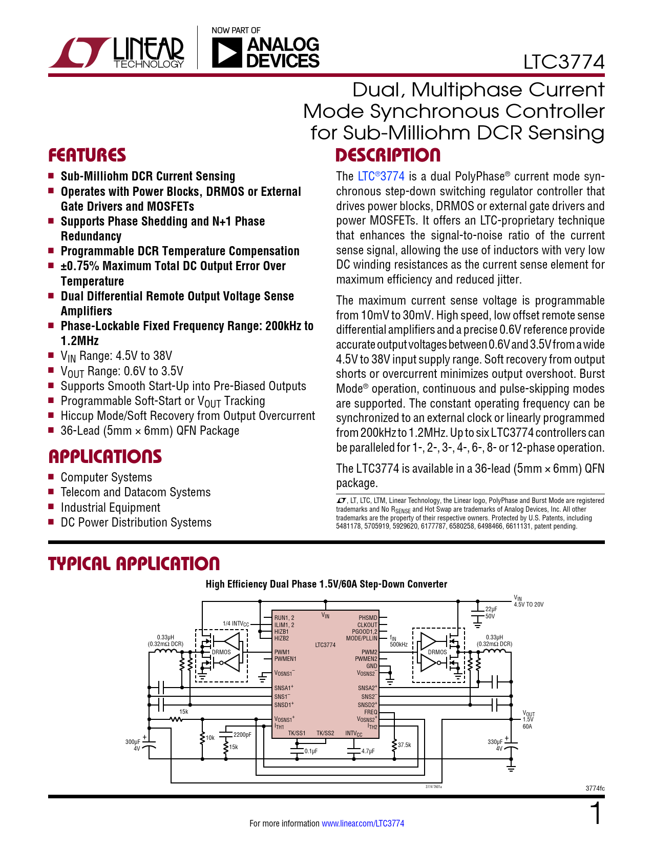

DescriptionDual, Multiphase Current Mode Synchronous Controller for Sub-Milliohm DCR Sensing

Sub-Milliohm DCR Current Sensing
The LTC®3774 is a dual PolyPhase® current mode syn- n
Operates with Power Blocks, DRMOS or External
chronous step-down switching regulator controller that
Gate Drivers and MOSFETs
drives power blocks, DRMOS or external gate drivers and n
Supports Phase Shedding and N+1 Phase
power MOSFETs. It offers an LTC-proprietary technique
Redundancy
that enhances the signal-to-noise ratio of the current n
Programmable DCR Temperature Compensation
sense signal, allowing the use of inductors with very low n
±0.75% Maximum Total DC Output Error Over
DC winding resistances as the current sense element for
Temperature
maximum efficiency and reduced jitter. n
Dual Differential Remote Output Voltage Sense
The maximum current sense voltage is programmable
Amplifiers
from 10mV to 30mV. High speed, low offset remote sense n
Phase-Lockable Fixed Frequency Range: 200kHz to
differential amplifiers and a precise 0.6V reference provide
1.2MHz
accurate output voltages between 0.6V and 3.5V from a wide n VIN Range: 4.5V to 38V 4.5V to 38V input supply range. Soft recovery from output n VOUT Range: 0.6V to 3.5V shorts or overcurrent minimizes output overshoot. Burst n Supports Smooth Start-Up into Pre-Biased Outputs Mode® operation, continuous and pulse-skipping modes n Programmable Soft-Start or VOUT Tracking are supported. The constant operating frequency can be n Hiccup Mode/Soft Recovery from Output Overcurrent synchronized to an external clock or linearly programmed n 36-Lead (5mm × 6mm) QFN Package from 200kHz to 1.2MHz. Up to six LTC3774 controllers can be paralleled for 1-, 2-, 3-, 4-, 6-, 8- or 12-phase operation.
APPLICATIONS
The LTC3774 is available in a 36-lead (5mm × 6mm) QFN n Computer Systems package. n Telecom and Datacom Systems L, LT, LTC, LTM, Linear Technology, the Linear logo, PolyPhase and Burst Mode are registered n Industrial Equipment trademarks and No RSENSE and Hot Swap are trademarks of Analog Devices, Inc. All other trademarks are the property of their respective owners. Protected by U.S. Patents, including n DC Power Distribution Systems 5481178, 5705919, 5929620, 6177787, 6580258, 6498466, 6611131, patent pending.
TYPICAL APPLICATION High Efficiency Dual Phase 1.5V/60A Step-Down Converter
